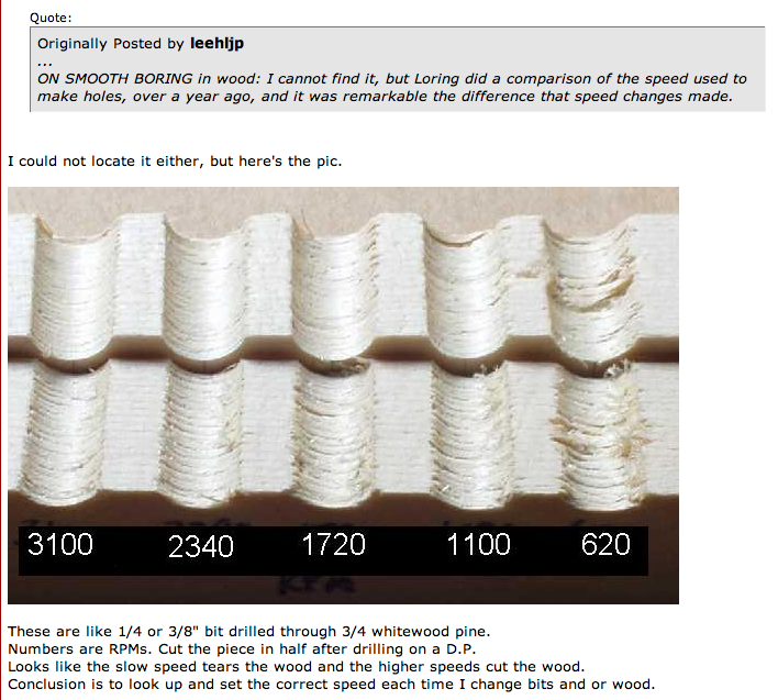

An engineer friend on another woodworking forum posted this photo of drill speed in soft pine wood years ago:
View in Gallery
Some bowl turners who are used to slow speeds and often not convinced early on of the need for higher speeds for pens out of their prior experiences. They are not taking into account the changes in cutting speed at the point of the cut.
Notice the higher speeds cut smoother than slower speeds. A car going 10 MPH hits a 2ft pot hole that is 10 to 12 inches deep might need a front end alignment; however hit the same pot hole at 60 mph and the wheel does not fall all the way in and there is a slight bump but no front end alignment problems. While this is not a great example, it is an example that slow cutting can cause catches where faster turning does not.

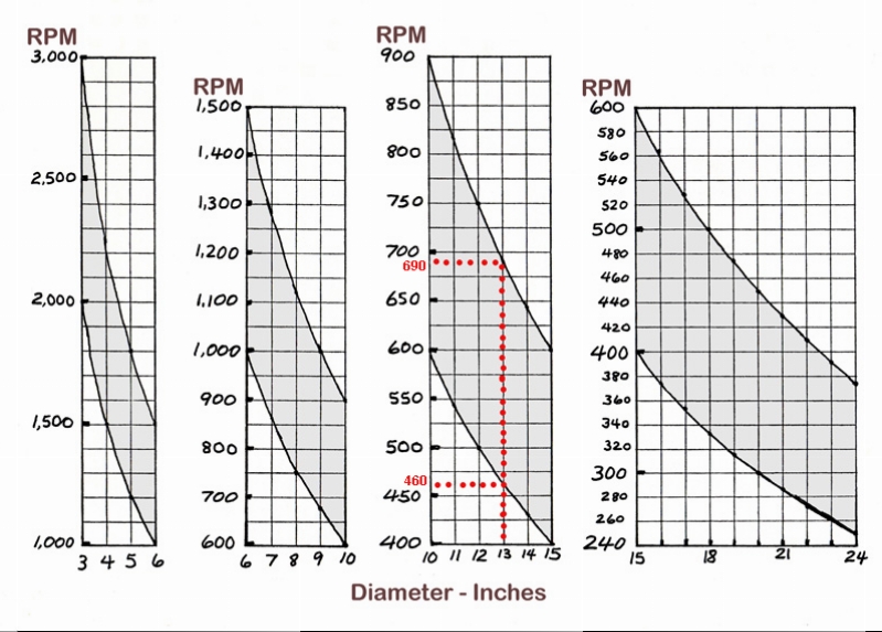

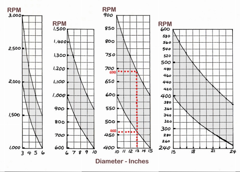

For turning speed in bowl turning, below is a chart that was sent to me a few years ago and I have since seen it on a few bowl forums. I keep it on the wall behind my lathes. It can be seen that even 3" bowls are recommended to be turned between 2000 and 3000 RPM.
A very helpful chart.
