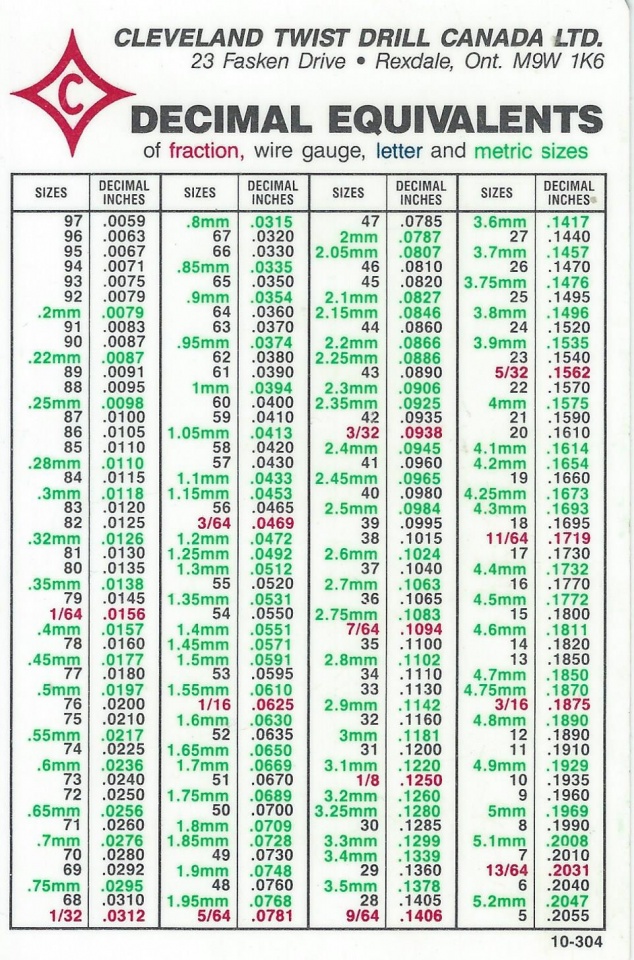

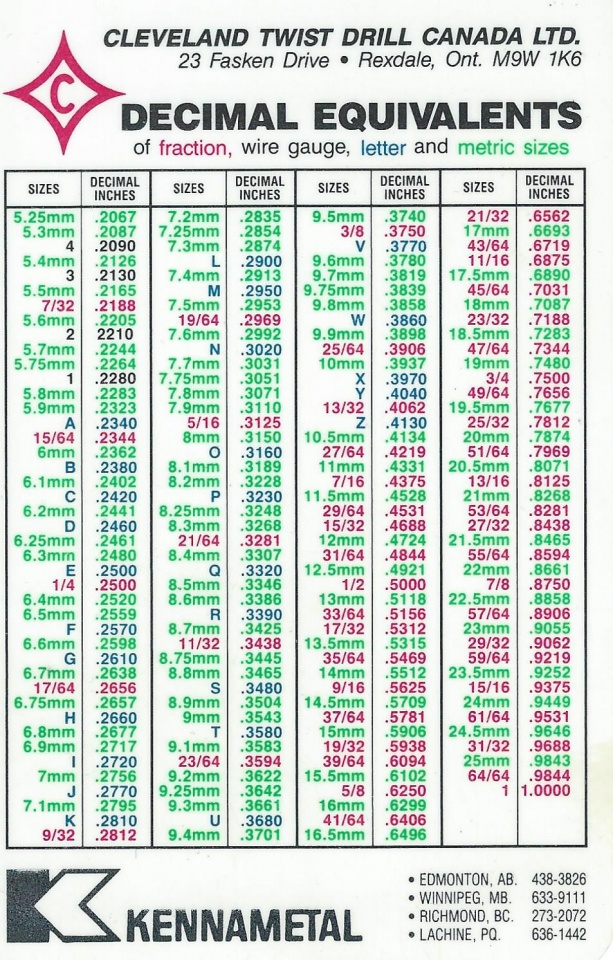

I use this one.
Les
Typically on metric threads you take the thread diameter and subtract the pitch. This might be tighter that you want for a pen but that is for metal working. So a 10 mm x 1.25 would be an 8.75 mm drill. That is the quick and easy of metric threads. Many times through letter and number drill bit options you can be within a few thousandths of the correct size.
