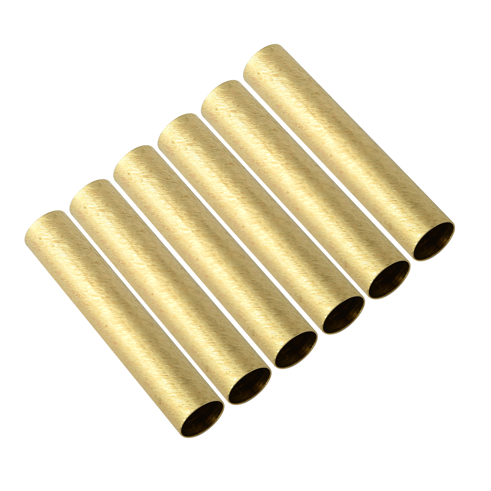

I see. Where do you get your barrels? I have three executive twists from Rockler I took apart and I can't seem to find just the barrels. Also 2 cigar kits from legacy. Can find barrels on that but have to pay $5 to get them shipped, painful.
The executive is a penn state industries kit, see link above for replacement tubes $3 for 5

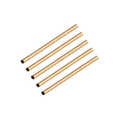

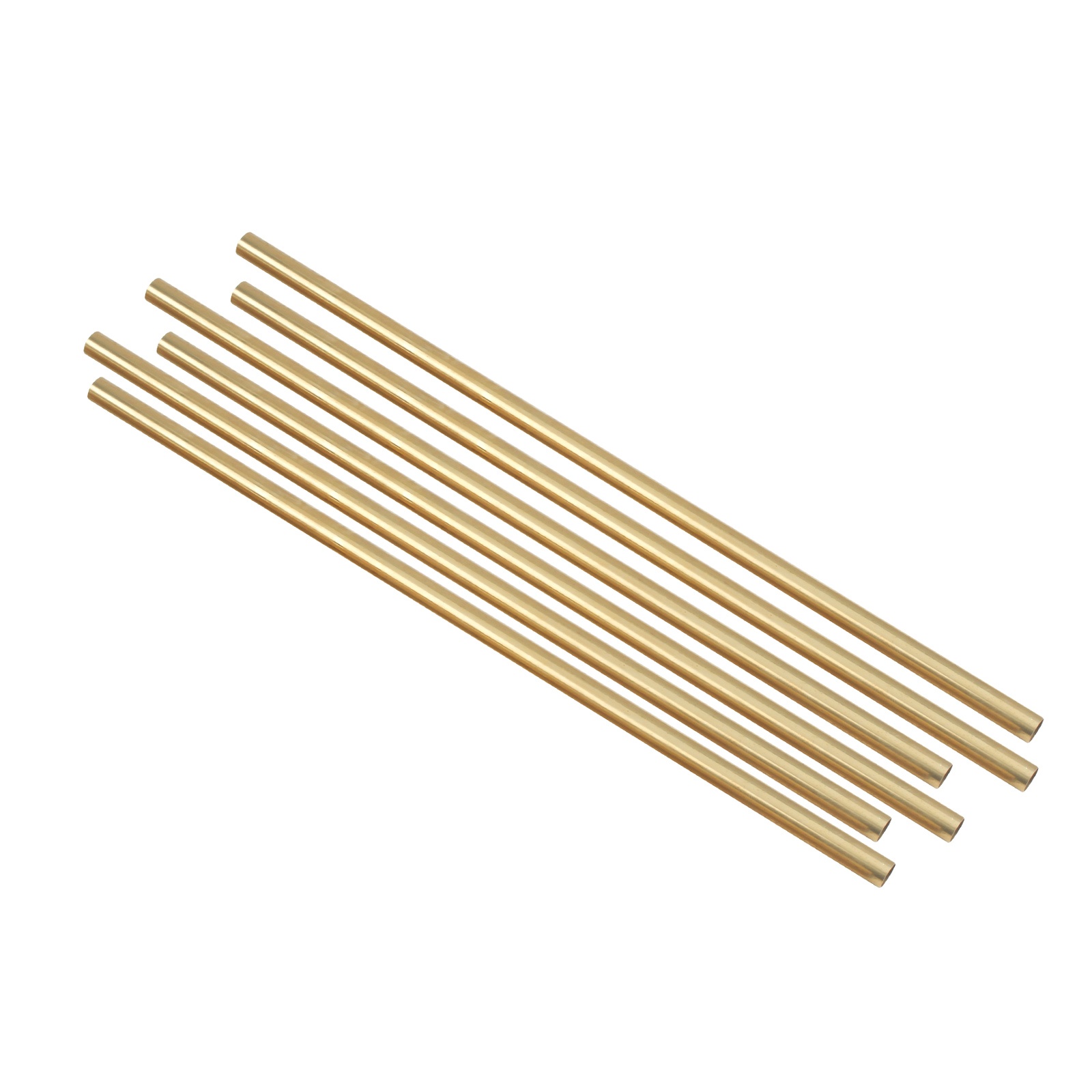

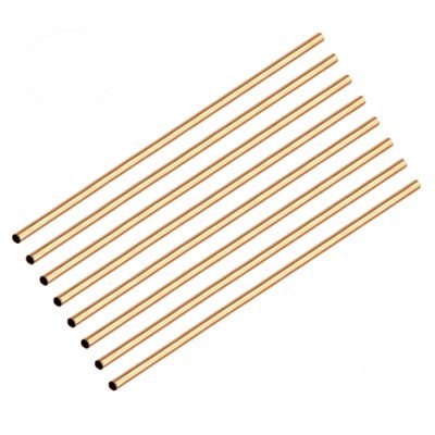

@Jmaxcy
Next time you are ordering pen kits and supplies, you might want to order some 10-inch lengths of the tube size you need for your kits.
Using those requires, of course, that you have the capability to cut and trim brass tubes to the right length for your pen.
You would also need calipers to measure the length as you trim.
Those 10-inch lengths are available in diameters to suit most pen kits.
For example, you can find such tubing at PSI ( they have a fairly complete selection, other vendors do also ... ExoticBlanks )
Actually, PSI does have other sizes. . For example, here are the 10-inch tubes with 3/8" diameter. . Just search their website using key words.
ExoticBlanks carries 10-inch tubing in all the usual sizes - I just checked.

@Jmaxcy
I have a mitre saw, assuming that would be enough to cut these tubes to length? If so I might just get two of these packs and keep them as back up.

Thanks for the help. I liked the idea of getting them in 10 in pieces. I have a mitre saw, is there anything else I would need to cut to length?
magpens
Feb 2, 2011
15,911
Canada
I think a miter saw could be used to cut brass tubing. . You can also cut on your wood lathe if you have a suitable cutting tool ( not ones for turning).
You would have to be extremely careful using the miter saw.
magpens
Feb 2, 2011
15,911
Canada
With the miter saw it would be difficult to cut to the EXACT length required ( which is quite critical, espec. for ballpoint pens ).
You would cut to a close length and then, on your lathe, trim to the "exact" length using your lathe cutting tools ( gouge or skew ... carefully !!! )
You'd need calipers to measure the length ... trim a bit ... measure ... trim a bit more ... measure ...... repeat until you get the "exact" length.
For your lathe you would need a head stock chuck which can grip the tubing .... not all chucks will go down to such small diameters .
