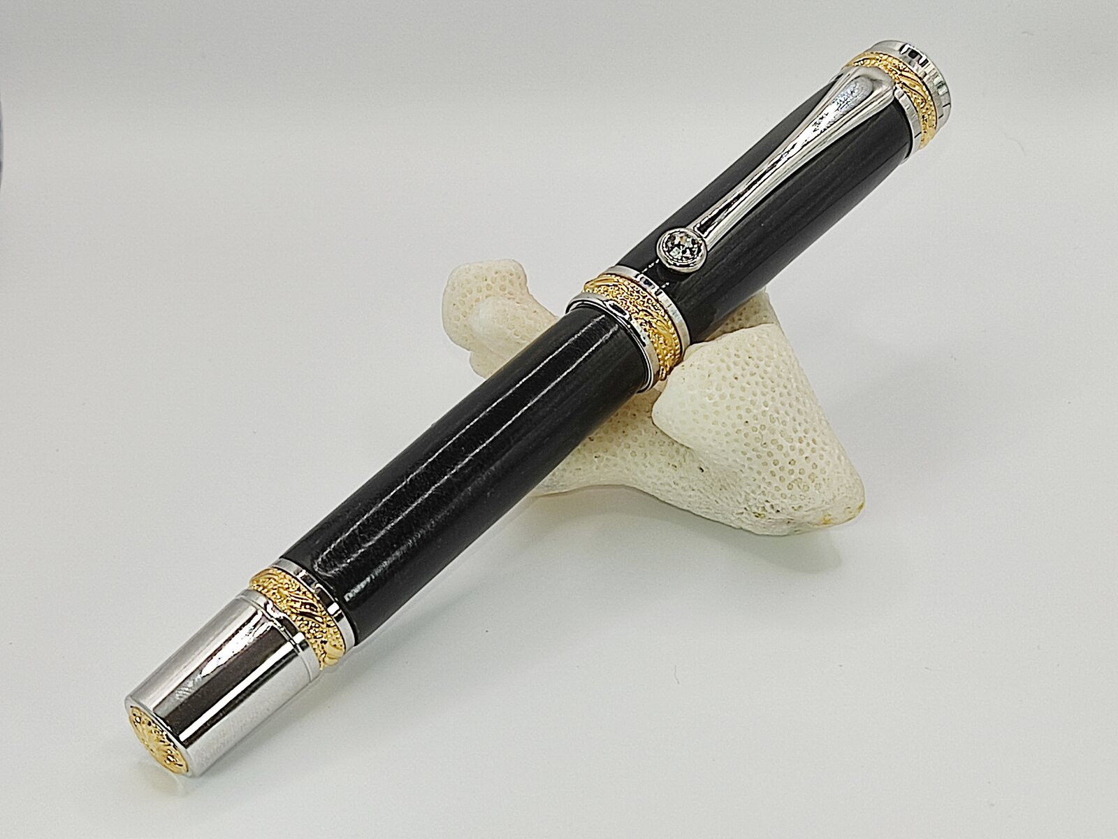

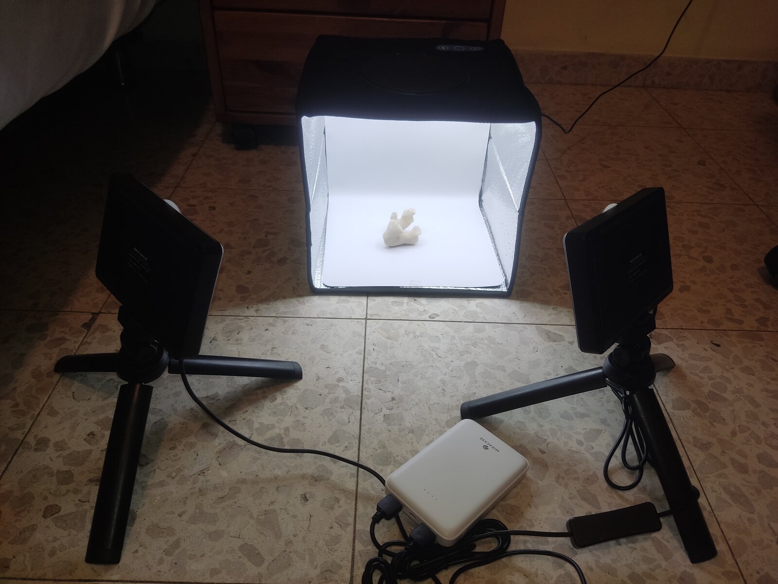

Hello,
I own a simple setup with a small light tent, two tripod lights and a tripod for my smartphone. Bought all of those for like 60$ on Amazon.
The pictures I produce with this setup are fine, I guess. And fortunately for me, sales have been going great the last two weeks (sold 7 pens!)
However, there are several problems:
First of all, the light mirrors back (I hope that's the correct term in English?) from the pen, creating unpleasant bright strips on the pen.
Secondly, the background isn't completely white, but sort of light grey. The pictures don't come out very consistent from this perspective.
As I'm getting more serious in this craft, I want to upgrade this setup soon. Where should I start? How to choose a camera, what other equipment to look for?.. I'm willing to spend some money, but not something too crazy please. Thanks!

I just had a look at the photo of your setup, you need to diffuse the light, otherwise you will get the light reflecting back into the camera. I use sheets of white A4 paper between the lights and the pen. Sylvanite's articles will explain this better.
That's most likely from the direct light shining straight onto the pen. Try to use diffused light from the top and sides (which would mean you'd need to change your photo box to have translucent sides). I like to use pop-up photo boxes for my small item photography like this (please ignore the clutter):
Also note the flash for my camera is pointed straight at the ceiling. Helps soften the harsh light and spreads the focus to avoid blown out white spots on the objects. I end up with pretty well exposed and evenly lit subjects:
You don't *need* a flash to do this, but you do need to shine your lights through diffusing material or bounce them off a white surface and onto the subject.
As for your gray background issue. You might just need to increase the exposure on your camera or in editing software. My favorite way to get a bright white background is to shine a light directly onto the background from above, behind the subject. That would require a box with no top or with a translucent top.
Good luck!

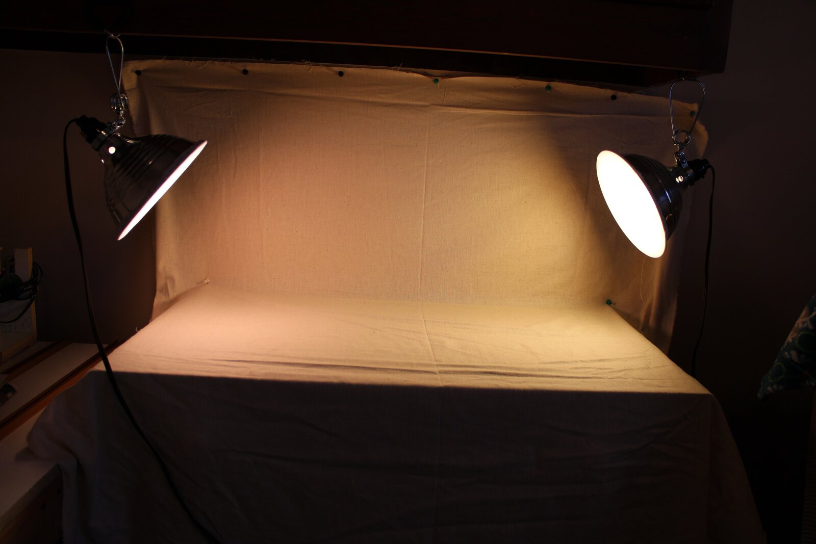

Here is my setup. The clamp lights are from Harbor Freight with Curly Q bulbs. Wife made the diffusers out of scraps of material. Background is a neutral tan; have grey and brown but never used them. The lights clamp to an overhead cabinet. I can move them on the bottom rail or a door to get the desired effect.
