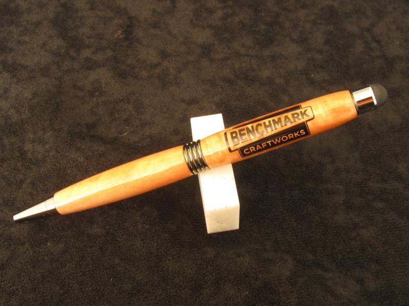

I in no means am intending to hijack Sharon's thread but here is a (not so good) shot of a pen/stylus that I used at my last show. I used it to write notes and have customers sign my iPhone for any CC transactions. I did use the roadster kit clip but you can't see it in the photo. I haven't turned a stylus only piece but this got a lot of attention at the show and I hope for orders...
As for the problems others have had; I use a small drop of flexable CA in the groove where the tip seats. So far it hasn't come off/loose even after my son tried to pull it off thinking it was an eraser:eek:.
All tyhe best,
Chris
