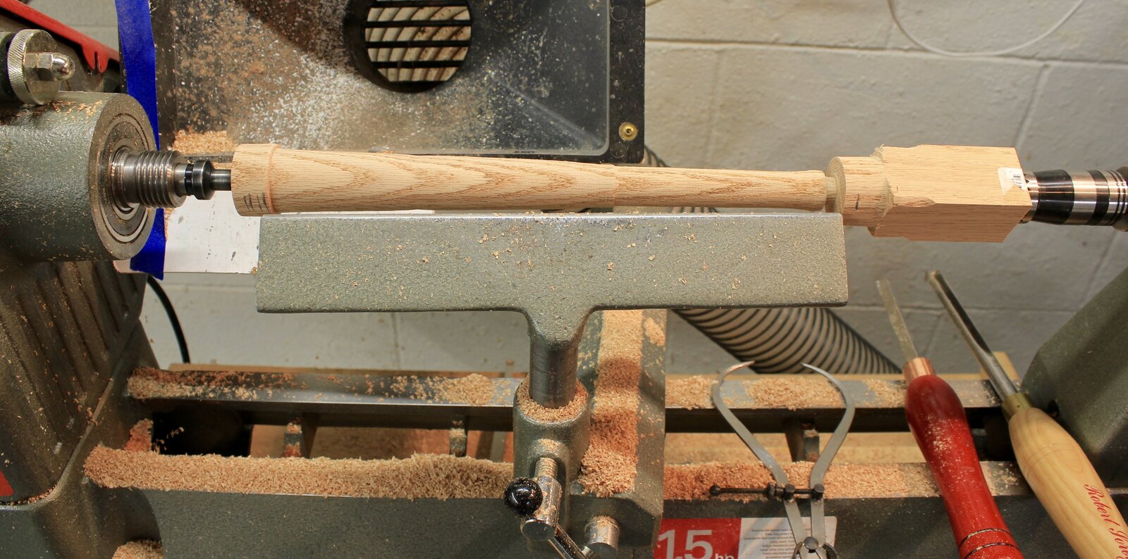

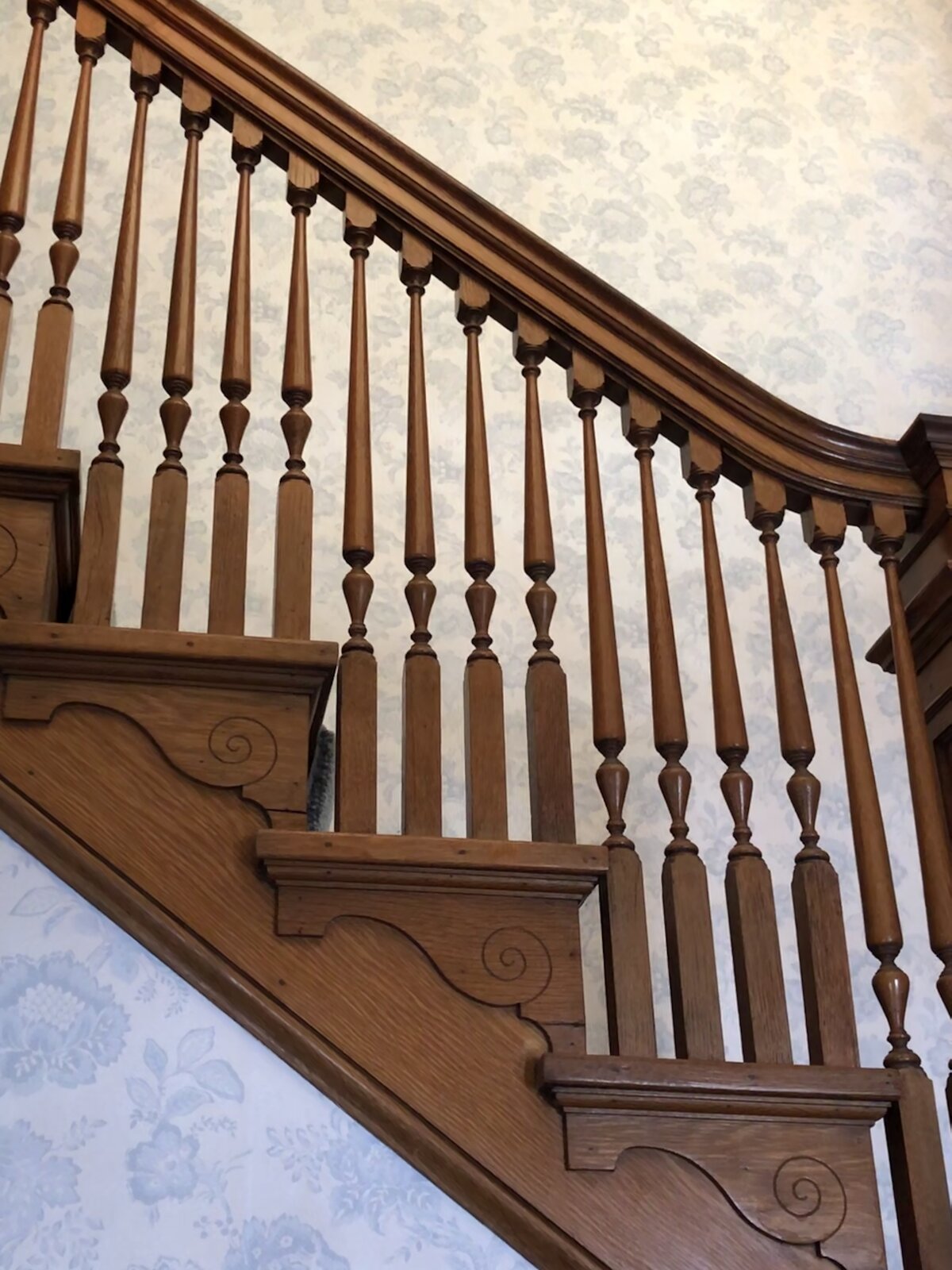

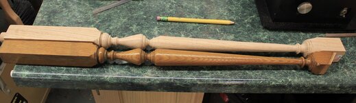

My In-Laws live in a house with some stair Balusters that have been broken and missing for decades. They have lived here for 70+ years. It is a curved staircase and 5 are missing. The age of the house is approximately 130 years ago, and I was assigned the "privilege" to take on this repair.
I suggested seeking a local Amish woodturner who could actually do a nice job, but "NOOOOOOOO! It's basically a long fat pen, you can do it." :eek: :D:mad:.
My skills as a general woodturner has included little spindle work, so this is very much a learning experience. But with the outside temps above 90 degrees, my basement shop has a newfound comfort level.
The house itself is in poor repair (my in-laws are both 94), but it was a beauty back in its prime. The woodwork is an interesting mishmash of cheap pine, I suspect some sycamore and beech, as well as incredibly intricate oak fireplace moldings.

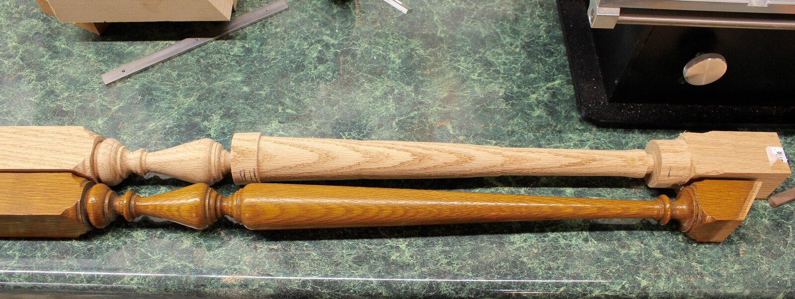

But the staircase is 130 years old, so matching the wood as well as an aged varnish/shellac/??? will be a chore.

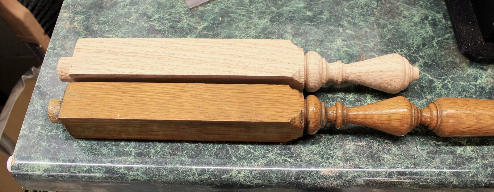

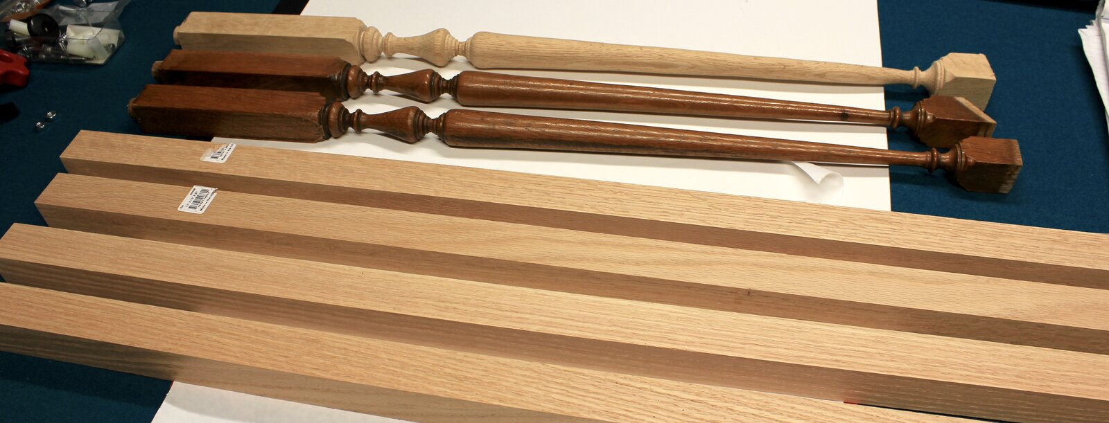

I'm using oak 2" x 2" x 3' sections from Home Depot. Hopefully the match is close. I took out several of the remaining Balusters to match the patterns, and the end grain looked like an open grain Oak.

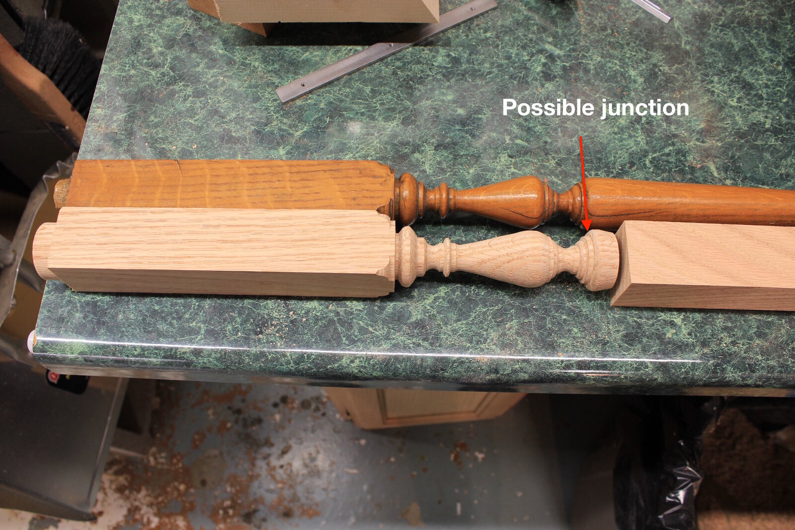

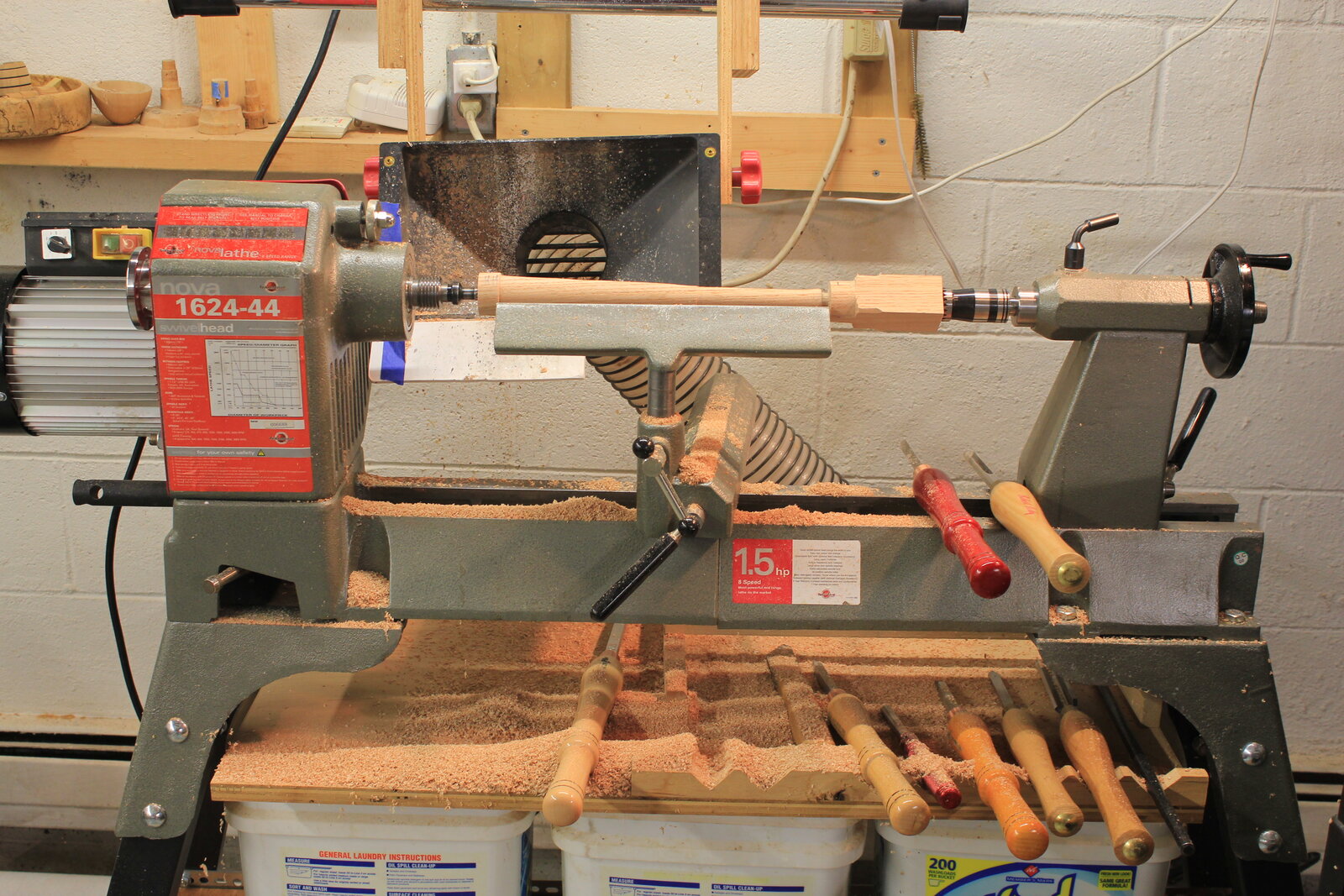

Any suggestions or comments are welcomed. I have 2 done, so 3 to go. These are turned in two sections and joined in the middle via a mortise/tenon; not ideal, but my lathe will not accommodate the full spindle. Each step has different lengths, so there are 4 different lengths of the 5 needed.
I'll post pictures after they are done.

Yes, we have enough scraps to experiment. And no, we have no idea if this is the original finish. There have been only two families in the house for 130 years. I was suspecting shellac, but I am punting the finish to my retired, bored chemist wife!!! She claims to be a Urethane specialist, so to me that says she knows everything about old baluster finishes. 😝😝😝. Good luck to her!

Mark, I have turned dozens of these things and offer 3 points; 1. mark the low points first with a parting tool and caliper then work towards the next high point in both directions; 2. place the sample on a rack just in front of the blank so you can see exactly how each step should look. 3. use a skew as much as you can because you do not need to sand when done turning! Good luck, and good matching. OBTW, a good parting tool can make quick work of the little steps in each piece. P.

I suspect the greatest challenge will be in matching the aged finish. The shape doesn't have to be a perfect match (there likely could be some variation in the original balusters). Will the replacements be clustered together or distributed randomly? Unless the replacements can be clustered together in a quasi-hidden location (such as the top of the staircase), a random distribution might be less obvious.
Thanks for the suggestions Phil. It sounds like I'm using all your thoughts with the exception of the skew. I've been making good use of the parting tools I have (3) as well as my spindle and roughing gouges, bench grinder and hones. And my mechanical calipers age happy to be appreciated after sitting for a few years.
The 5 I am doing will be randomly places where needed. It actually is a fun project and my spindle turning skills are getting better. The mortise/tenon is good as the match is better centered as I can do it all on the lathe. And yes, the finish match will be the challenge. I bought a 3' length of the same Oak to do test finish applications and see what is close.

I think the spot you chose to join the two parts is not good because it is in the thinnest part of the spindle. I would have made it at the point where the top of the taper rounds over to the first detail. A seam there won't show and because of the extra meat there you could have a tenon 50% or more bigger than the one in the cove. The cove would be as strong as the wood allows. Remember you asked for suggestions.
As other have said matching the finish will be the hardest. You might want to look into filling the grain or some of it so the finished piece won't stand out from the smoother old ones.

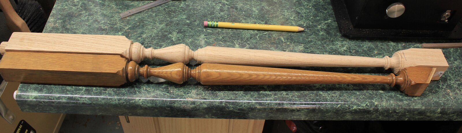

This is very much a nice learning curve for me. Even at 20" with the tailstock tight and 3/4" Steb Centers the spindle wobbles just a bit. Using kiln dryed Oak from Home Depot is a good "wild a.." guess for the wood match, but it's a tough wood to turn; lots of dust and small particles. I have decent ventilation, filters and dust collectors, but still a mess. Not like turning a nice wet wood bowl blank!
Very light cuts, I am sharpening and honing more on this project than any other.
I am 1/2 way done with the 3'rd Baluster. I am following a suggestion from Curly to shift the spot of the tenon/mortise to a larger OD location for a stronger joint. This section is not done, but the junction will be just right of the rounded edge.
