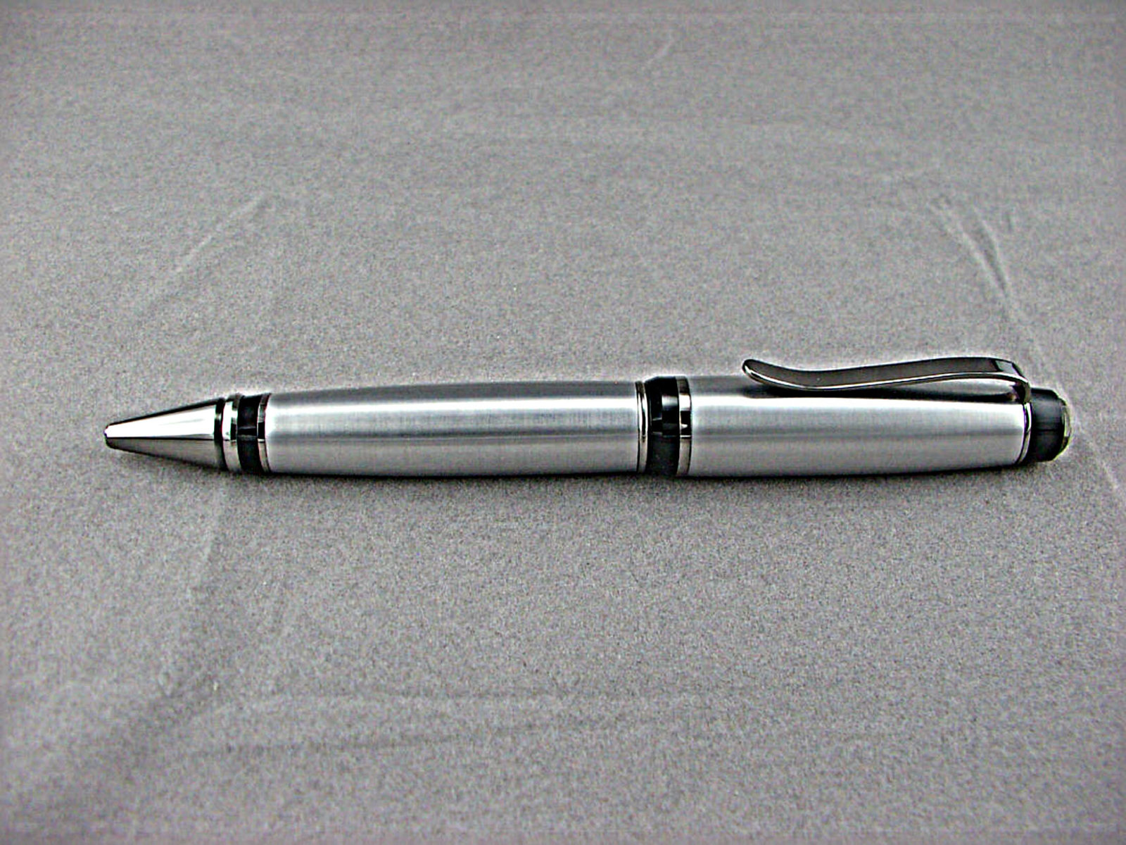

That is what they are talking about. I would not polish any kits whatsoever with a buffing wheel. Many people including myself have made pen barrels from Stainless Steel. Those are true SS. I do not like the high shine of polished SS so I choose to tone it down with a texture look.
