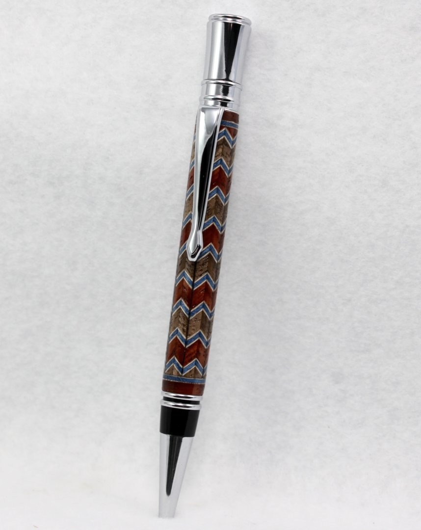

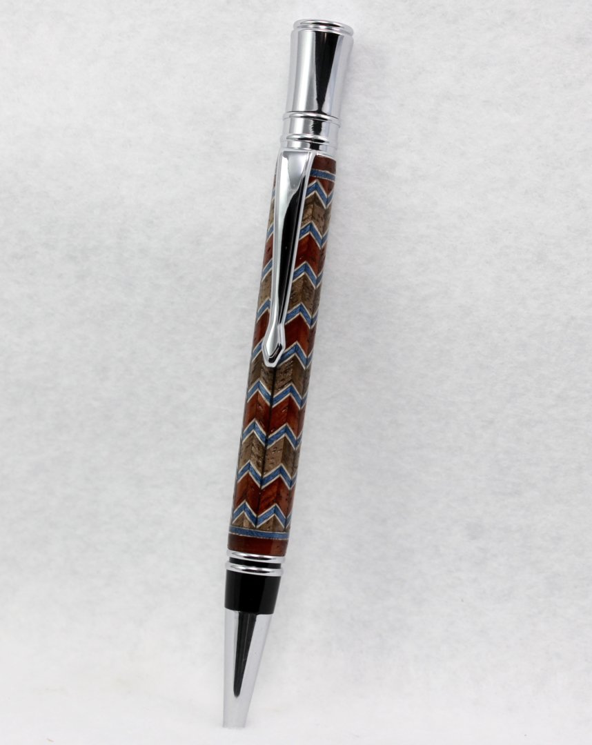

This had about 450 glue joints. I used CA fairly liberally.
