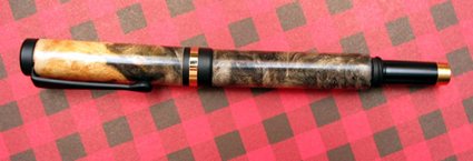

thought I would post a little on this subject. I tried the Future Floor Polish and it was pretty much a disaster. Although it penetrated the Buckeye Burl quite well (because it is 90% water), it didn't seem to want to dry out. I let it set for 2 weeks and it was still "gummy when I tried to turn it". It also smelled really strong. I am pretty much convinced using Future floor polish is a lost cause!!!!
On another note, I have learned a new way to stabalize that actually works!!!!! I have turned 2 spalted buckeye burl blanks so far and they were comparable to turning a soft acrylic. It is reletively cheap and easy although the chemicals used are dangerous. I am in no way recommending anyone try this at home. If you do - I urge you to be careful because acetone is very flammable!!!! Thought I would pass this on.
STABILIZING WITH PLEXIGLAS!!!!!!
Break up a piece of Plexiglas into pieces small enough to put in a small jar. Add enough acetone to cover the Plexiglas. Let it stand for a few days. If the amount is small, it will turn to a clear Karo syrup looking mass in a couple of days. Enough for two or three gallons takes a mite longer. Just stir or shake often and you will get the clear "syrup". Dilute to a milk or light cream like consistency. Thinner penetrates quicker. Then just soak your wood in it - the longer the better. I pre-drilled my blanks before soaking to let them soak from the inside also. After you remove your wood, the acetone will evaporate off and leave the clear plexiglas compound embedded in the wood.
Thought I would pass this on. It worked for me and I hope it works for you also!!!![8)]
<b>Image Insert:</b><br />
<br /> 82.38&nbsp;KB

Interesting concept on the plexiglass... how long did you actually soak it and how long did it take to dry completely... I might want to try this on some real punky spalted black locust...

This is a great idea! But I have to ask you, whatever prompted you to try dissolving plexiglass? [8D]
