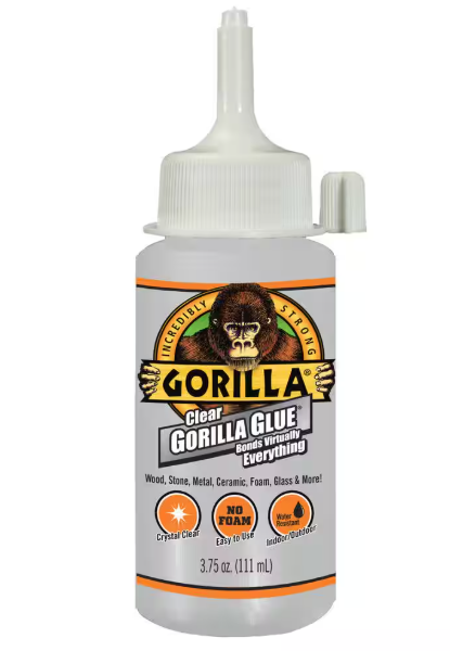

I've been using this stuff for a couple months now and have not had a single problem with it. It stays pretty flexible when it dries, which actually helps it to not break the bond between the tube and blank as easily as a more brittle CA bond. That's been my experience anyway.
Previously, I used regular foaming Gorilla Glue for wood, and epoxy for resin/hybrid blanks. This Gorilla clear works for everything. Also, I push one end of the tube into some dental baseplate wax to keep the glue from getting in the tube. You can use other stuff for that. I saw someone here say they used a tortilla!
Edit: also, I don't notice hardening of the Gorilla clear while still in the container like I did with the original and one part of the epoxy over time
Todd, I considered that. What is the work time, though? Devcon Two Ton is 30 minutes work time. I would consider 15 minutes as the minimum work time. I tend to do a few pens at a time. Five minute epoxy would entail mixing more than one batch. First fishing rod build was with 5 minute epoxy. Started to set as I was sliding the grip down the blank. I did make it...barely.
