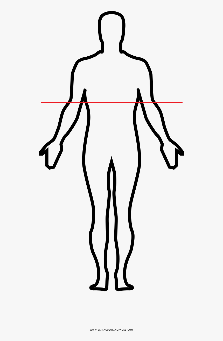

I think the diagram is right on. That horizontal arm level gives a comfortable height and good leverage as well as balance.
