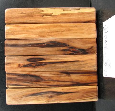

ok thats kinda what i thought it was, so I have a pecan tree that got killed 3 yrs ago by lighting, its still standing but has mushrooms and other fungis growing on it, should i be cutting it down and using it , also a lot of branchs on ground

Spalted
This is an example of Spalting. This Pecan
Yes. Also look at the crotches of the branches you will get some nice grain patterns from there.
