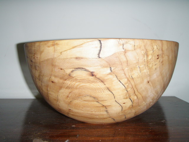

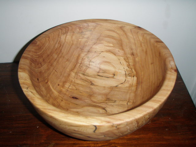

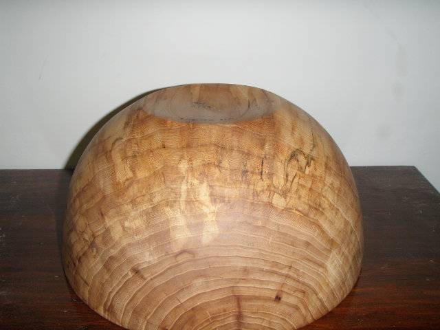

A Lady from church who is a Real Estate Agent came to me asking if I could do a bowl for her to give as a gift at closing for a client. I am currently having trouble with my lathe right now. Headstock bearings seem to have gone bad and I am awaiting shipment of new ones.
I went to a friends house who has a Mustard Monster and a bunch of rough turned 3 year old Spalted Elm bowl blanks.
Here's what I turned from one of them. It is approx 9.5" in diameter and just under 5" tall. Finished with two coats of Howard's Butcher Block Conditioner, which is Mineral Oil, Bee's Wax and Carnuba Wax.

Very nice. How thick is the wall. From the dimension you stated I am figuring about 1/2 inch?
I'd like to see the bottom if possible. Did you use a recess or a tenon.

Yes the wall is about 1/2" thick and I did a recess for the bottom. I will try to get a pic tonight.
This is the first Utilitarian bolw I have made for an order. Most of my bowls aer smaller and teh "Artsy-Fartsy" kind.....

How did you like the finish.
I have been using salad bowl finish for my Utilitarian bowls and have been really happy with it after about 4 coats (light sanding after each) and buffing

I currently do not have a Bowl buffing system. Only the buffing wheels and I can't get this one done with a wheel properly, so I didn't buff it.
I really do like this conditioner stuff better that straight Mineral Oil, like I use on my end grain cutting boards. I will probably change to it for them too.

Bob,
I like it.... I like it... that is a very nice bowl....
