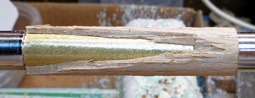

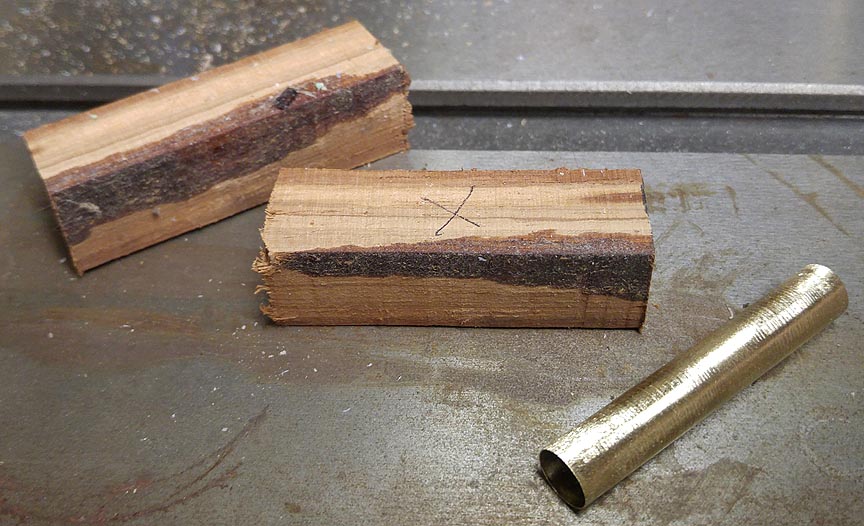

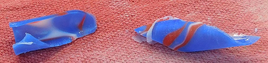

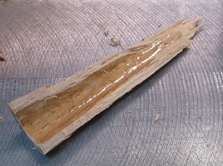

Grab some CA and glue it back on?

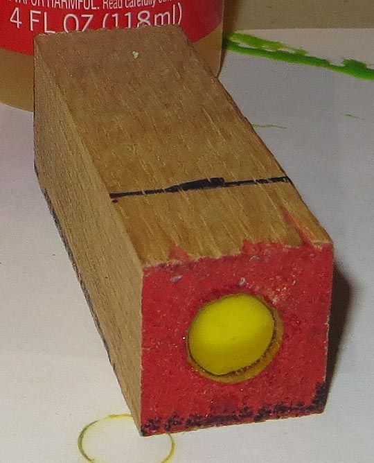

It looks like when you glued your barrels into the blanks, you didn't use enough CA... I see wet glue on the splinter, so I assume you decided to glue it back on and see how it would go.
Need to be careful with open grained woods like oak ... the grain pattern can mess you up like this. Did you get a catch with a skew? or was it a gouge? In either case, a very sharp tool and proper usage can help a lot (firm against toolrest, rub bevel, lift to cut), but roughing it with 80-grit sandpaper can do for really finicky woods.
I know the experience .... gluing the tube in is an uncertain process.
I used to put epoxy on the tube and inside the blank, but it gets messy. So lately, I've only been putting epoxy in the blank, then turning the tube as I insert it. Looks like I should go back to the messy way.
I was using a forged shallow gouge. Never did learn to use a skew.
The surface of the blank suggests you were not using the bevel for support. Using the bevel will be a bit more controlled and less aggressive.
It looks like your hole in the blank was either not round or way too large for the tube. You have evidence of glue/epoxy on the inside of the blank but no evidence that it ever contacted the tube.
That being said, yes I have had this happen to me also trying to rush cherry. I just grabbed the chunk and glued it back into place and then continued more cautiously. The pen ended up looking just fine and you had a hard time noticing the fix if you didnt know it was there. In fact, you had a hard time noticing even you knew it was there.
Been there and done that! I recently switched from 5 minute epoxy to Gorilla Poly glue. So far (knocks on wood) I have not had a blow out with Poly glue. I like how it expands to ensure a good tight bond. It's also 10x easier to clean up than epoxy. The over foam just pulls right off and my dental wax tube plugs pop out easily.
I tried Gorilla polyurethane glue when I first started turning pens. I believe it was new at the time. It didn't work for me. I also tried CA, but got a tube stuck halfway in a blank. I've been using epoxy ever since.
It's not the glue, it's the turning technique. One drop of CA or a small dab of epoxy will hold a tube in place for turning if your cuts are smooth. No amount of any type of adhesive will prevent a breakout if you are too aggressive.
I'll be the first to admit I don't have the best lathe skills. I never attended any classes, nor had a mentor of any sort. I just kind of learned as I went, finding out what worked for me. And admittedly, I was being a little aggressive when it blew out. Live and learn. I did have an acrylic blank blow out recently, and it happened right before the turning was finished. I wasn't being aggressive at all, since I was sizing it to the bushing. The blank could have had a defect in it, and/or it could have been the epoxy or my gluing technique.

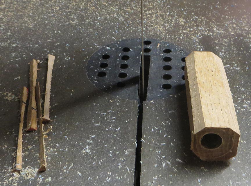

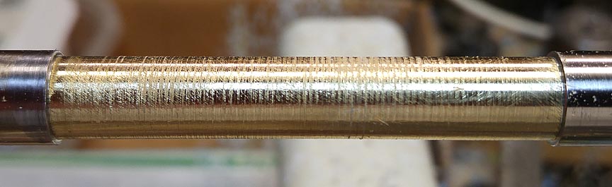

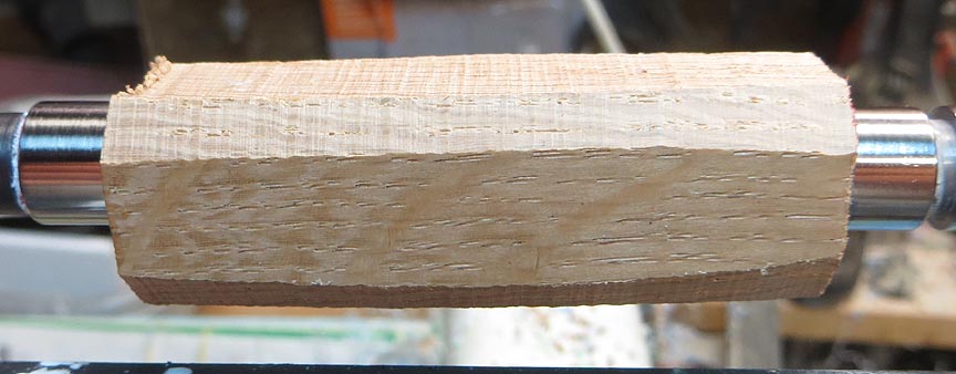

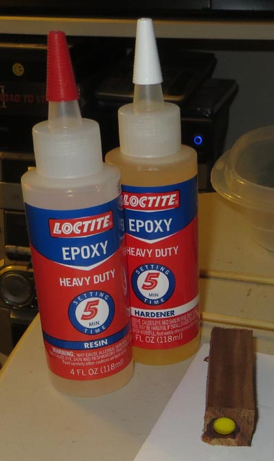

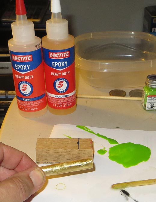

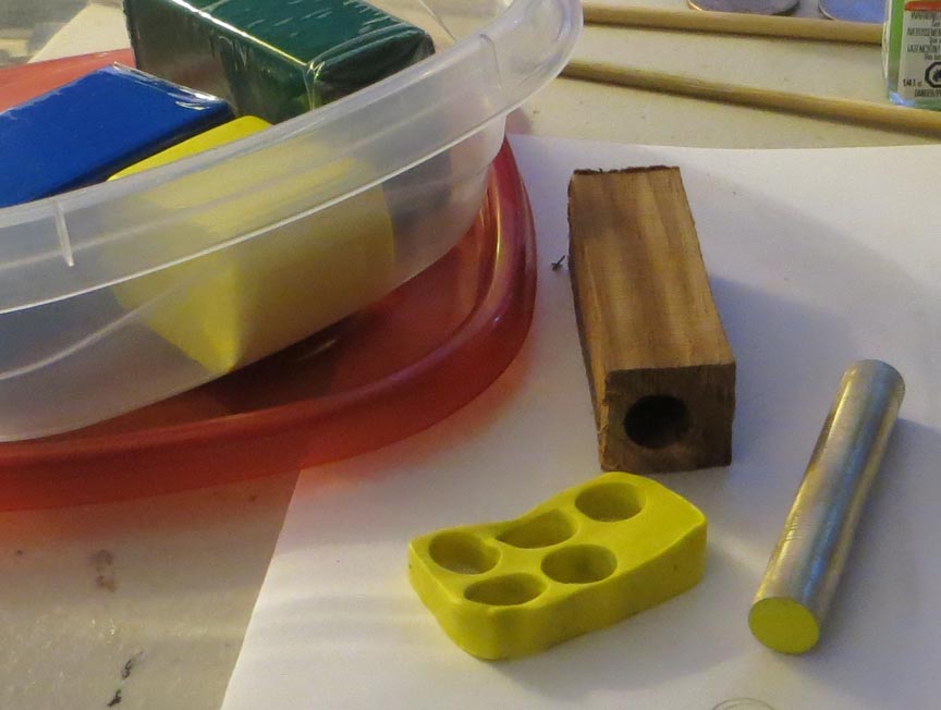

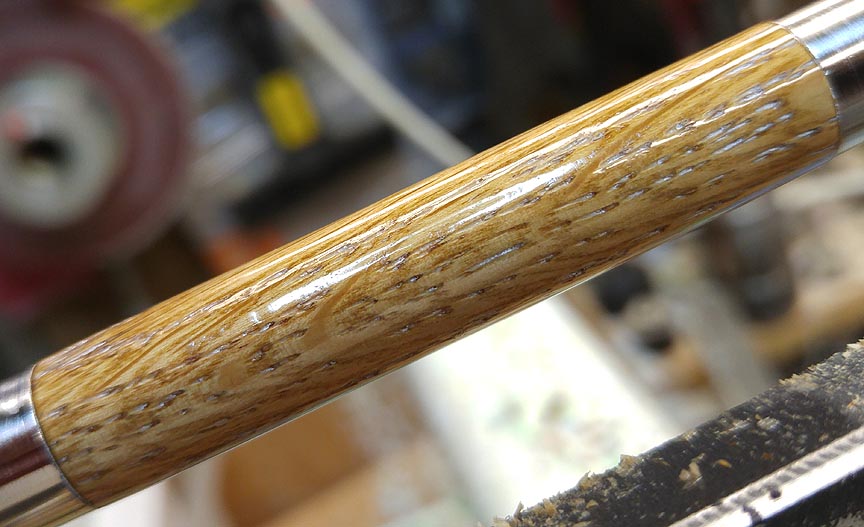

I decided to try again. I got some what I hope is better/stronger epoxy. The blank is another piece of oak. I made sure to put plenty of epoxy both inside the blank, and on the tube.

It looks like you have something in the tube to stop it from getting epoxy inside. That was going to be my suggestion to use sheet dental wax and apply the epoxy heavily, even putting a big glob inside and twisting the tube as it went in to spread it everywhere from both ends. A little epoxy left over dripping off the blank is much easier to handle and cheaper than ruining a blank. I haven't lost a blank since I started doing it that way. Now watch the first one will be this afternoon when I get home. I realize that you are most likely doing everything I said already but nubies reading this might pick up something from it. I have to say that pressing in dental wax is the single best improvement to my process of glue ups that I have made since I started and for the cost (about 5 pen kits for a penny) it is one of the best gadget investments I have made.
Hate it when that happens. It always seems to happen to me just as I'm getting close to my final step of sanding/finishing. All that time and work, *poof*. And it seems no matter how careful you are, and how many times it works flawlessly, all of a sudden, Boom! Another one explodes.
Oak is such a hard wood, and the grain tears a lot. It puts a lot more shear pressure on the glue holding the blank to the tube. You just never know when it will give.
I'm just glad to know I'm not the only one this happens to....
Kory
I used to use dental wax called "base wax" that I got from Arizona Silhouette. But now I use modelling clay that I get from Michael's.

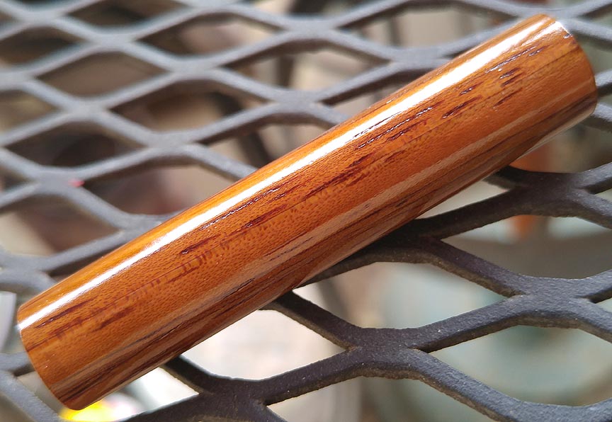

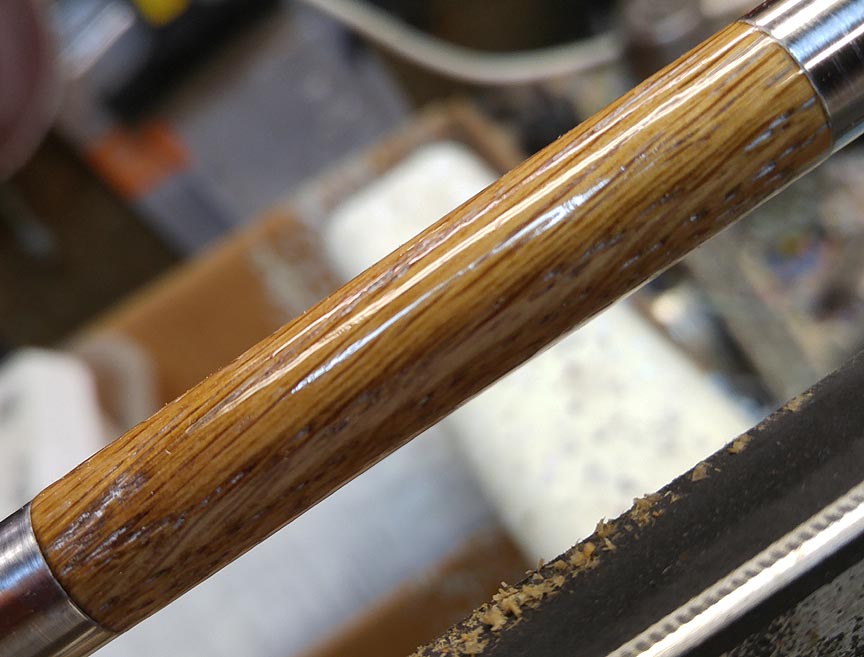

I wasn't taking any chances this time. I cut the corners off the blank to reduce the stresses when I roughed it round. I was also much less aggressive. Success!

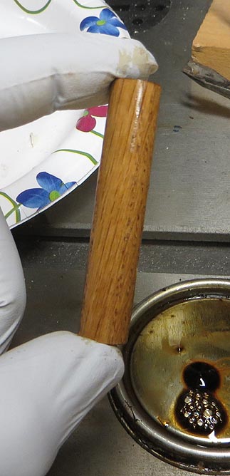

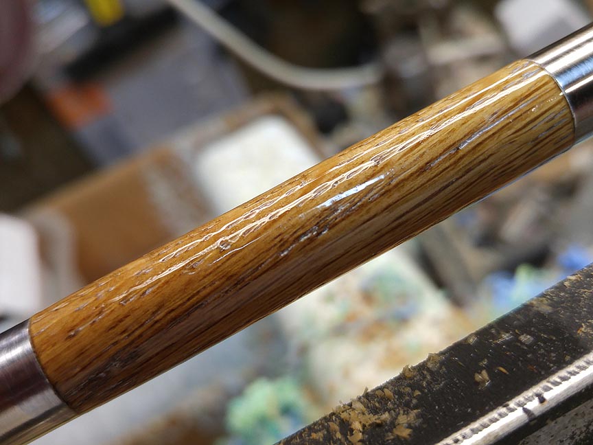

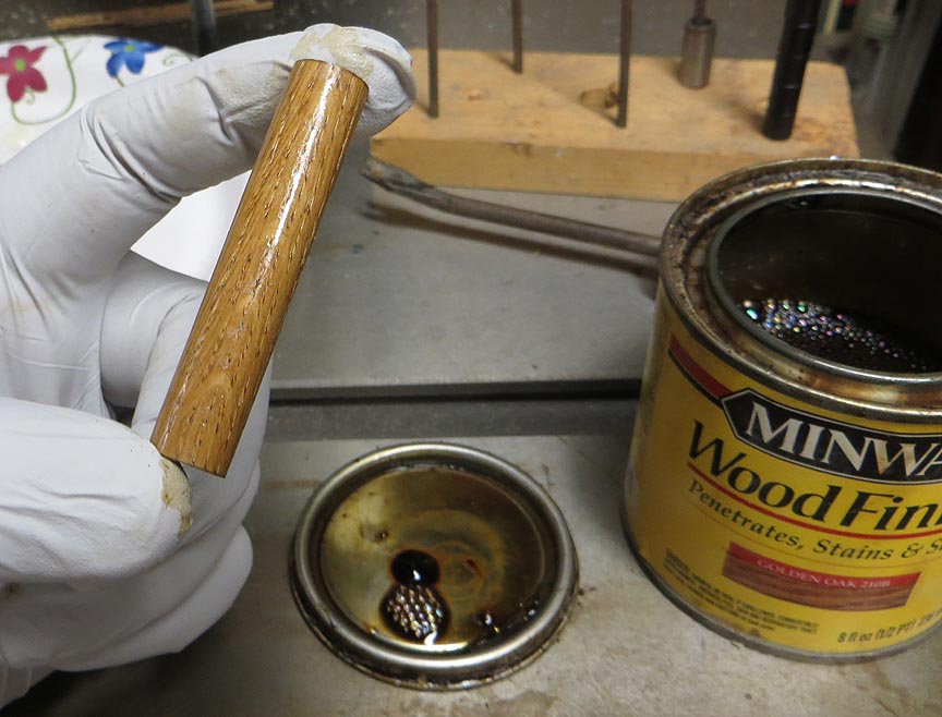

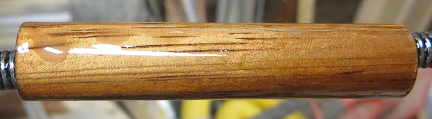

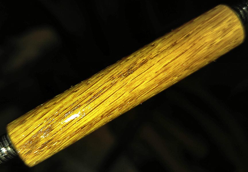

Boy, this is my weekend for mistakes. I decided to stain the sanded blank to hopefully accentuate the grain, which went fine. But when I sprayed on the lacquer, I noticed little red fuzzies from the staining rag I used. I should have blown it off with compressed air before I lacquered it. I don't know if you can see the fuzzies in the photos or not, but they're visible in person. I'll have to sand and respray it after the lacquer sets.

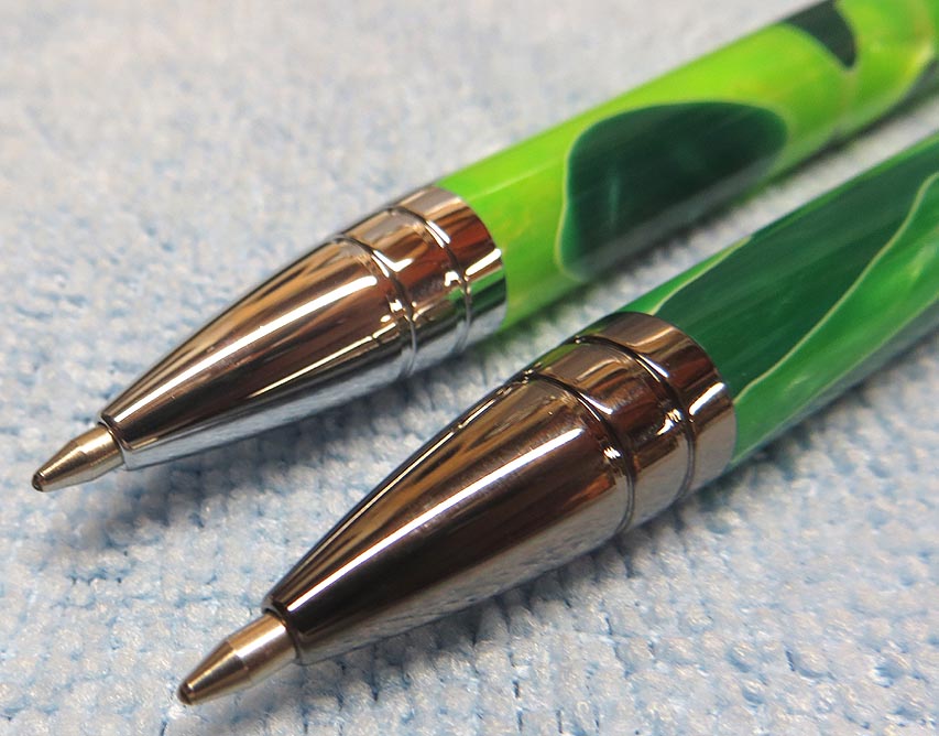

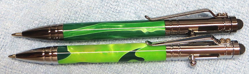

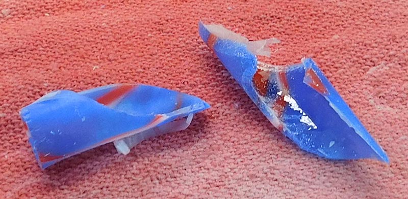

In addition to the mistakes with the oak blanks, I also trimmed a blank way too short on a Bolt-Action Tec-Pen. I don't know what I was thinkin'.
qquake, you weren't thinking, of the pen, maybe all the rain you have gotten over the last two weeks. (:
Good job on the pen though, I like the green blank with the pen.

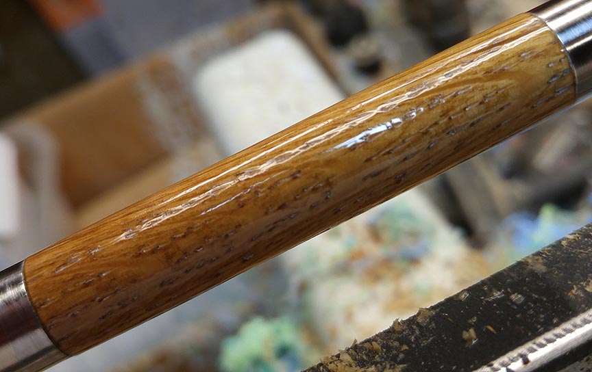

Okay, I'm giving up on oak for this pen. For some unknown reason, I decided to try polishing it with Novus. It made it shiny, but also got polish stuck in the oak. I tried blowing it out, but nope, didn't budge. I'm going to turn the blank off the tube, and use a different wood blank.

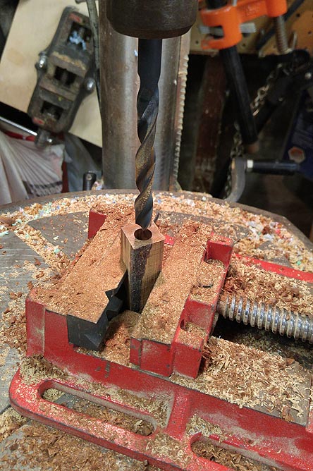

Got the oak turned off the tube, and the new blank drilled and glued.

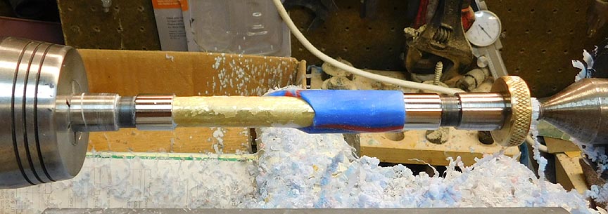

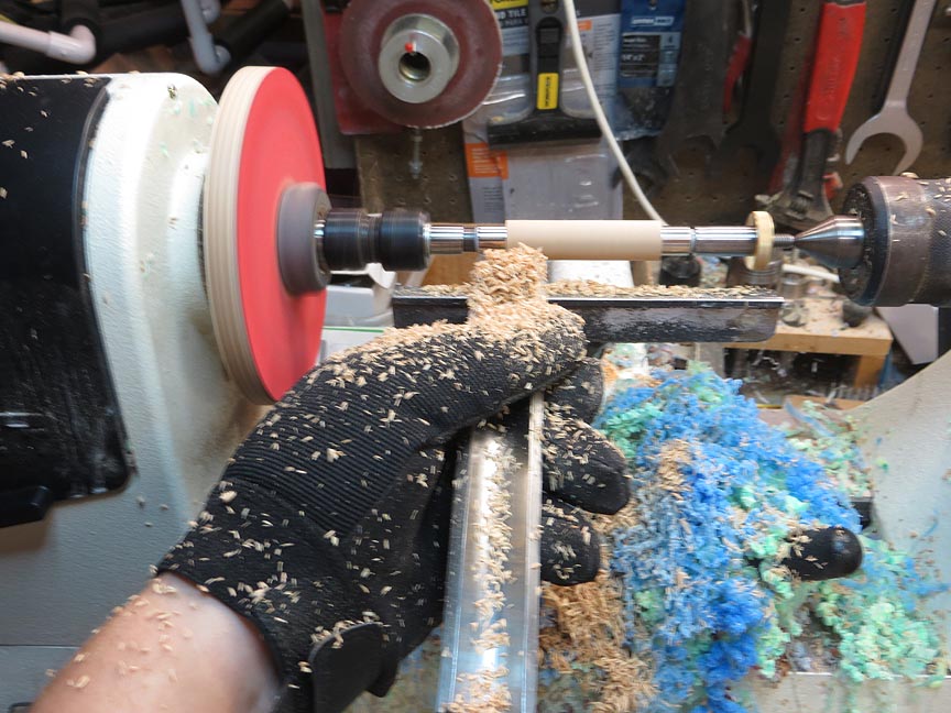

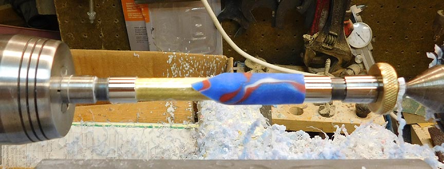

Please be careful turning with a cloth glove! If that snags the threads on the lathe shaft, or a square edge, you are in big trouble! You would also be better off with a scraper tool, compared to using the gouge as a scraper.
+1 to not wearing the heavy cloth gloves. Professional Safety Engineer here, and that's a quick shortcut to losing a digit.
That glove was rubber .....
The "fuzzies" was from using a cloth applicator for the stain, which was still not that great an idea for something spinning on the lathe.
Use paper towels for application of anything to your spinning lathe projects .... paper towel will tear long before pulling your fingers into the spindle. I take a sheet of the blue shop towels you can get at the auto parts store (VERY strong stuff, and lint-free!) and fold it lengthwise 4 times to create a thick pad ... then I take a very sharp pair of cloth scissors and cut roughly 3/4 inch pads from it into a small clean container .... I usually cut up 2 or 3 sheets at a time so that I have a nice supply when I want it.
Before drilling your blanks, make sure that there are no checks and cracks in the ends. Double check after trimming .... if there is, you can seal that area with some thin CA and give it 20 minutes to cure before turning.
The glove show in post 22 is rubber? That's even worse for grabbing on a spinning object.
Actually, I was referring to the glove in post #24 ... :)
But yes, I look at #22 and I see the cloth-backed leather reinforced glove and I cringe ....
The glove is neither rubber nor cloth. It's a tight fitting mechanic's glove. Nothing loose to catch on the lathe. I started wearing it after I cut my thumb with my carbide chisel. I found that it's comfortable for other chisels as well, and allows my hand to slide along the tool rest easier. And I didn't apply the stain to the blank while it was on the lathe.

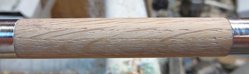

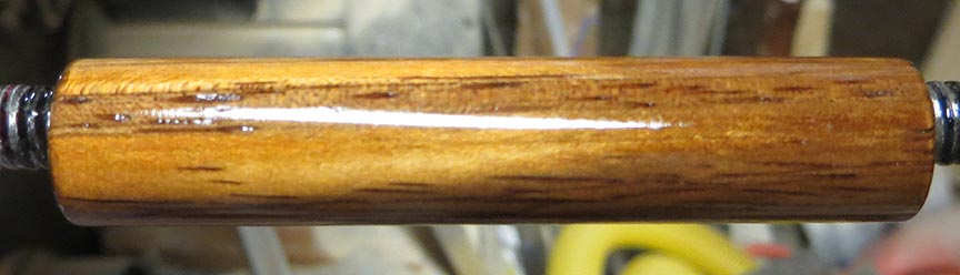

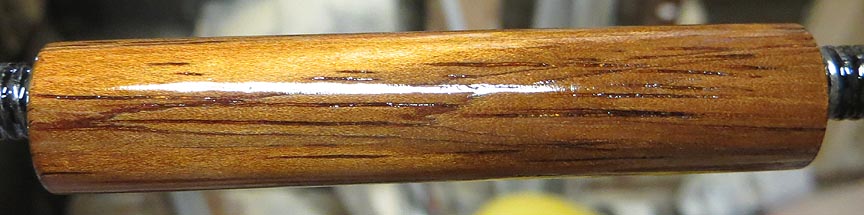

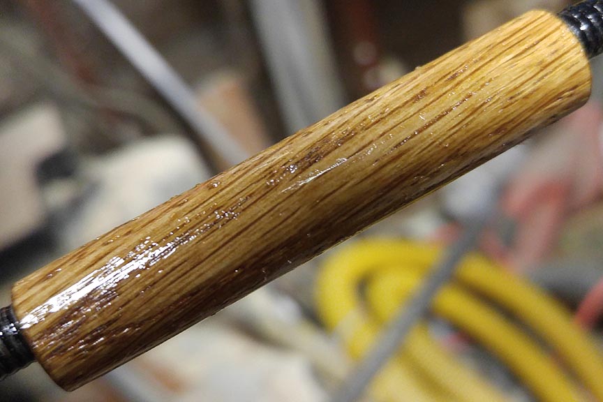

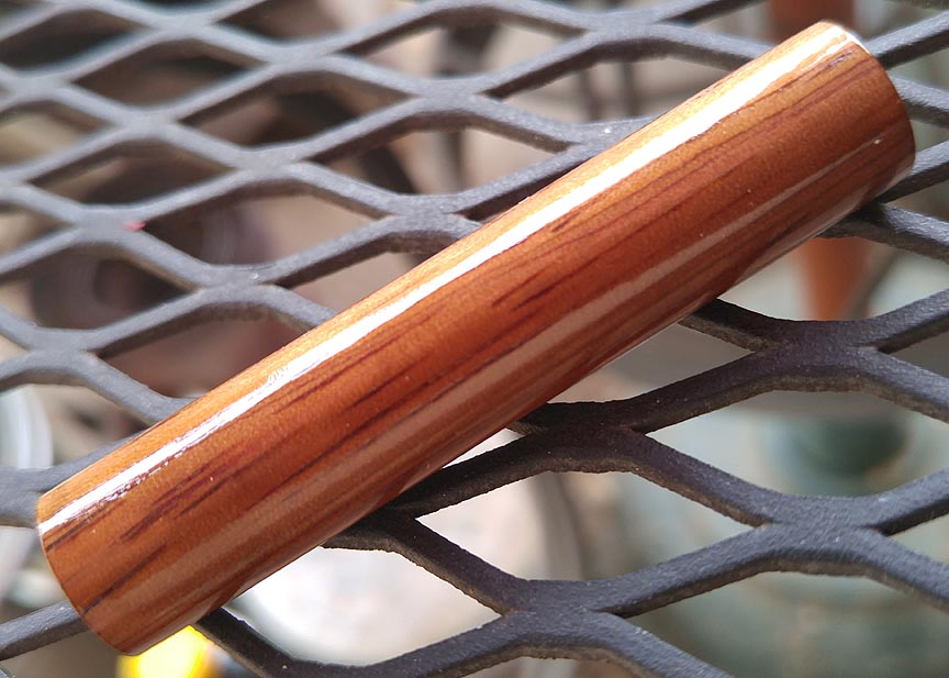

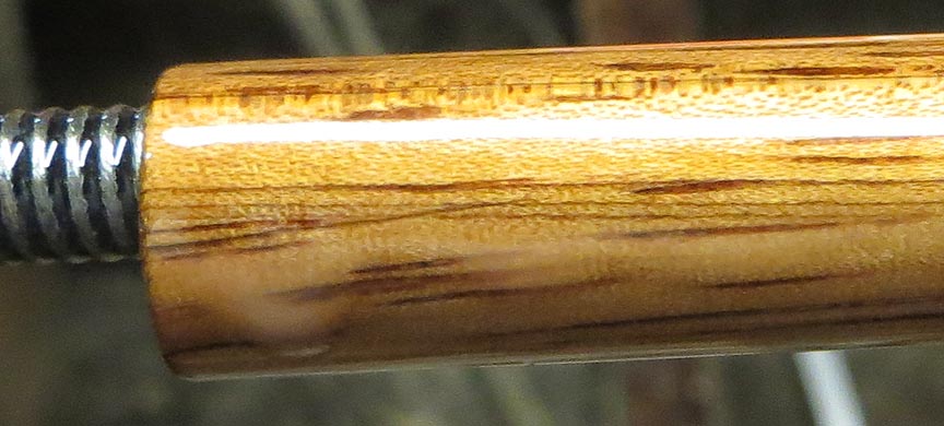

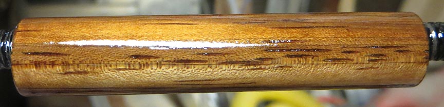

I sanded the finish off, and resprayed it. It looks pretty good now. I might actually get this pen done sometime this century.
I see a glue seam right down the center of the left one .... That might be the cause of some issues, if you don't take care while turning, but it looks like this one might make it through ok. :)
