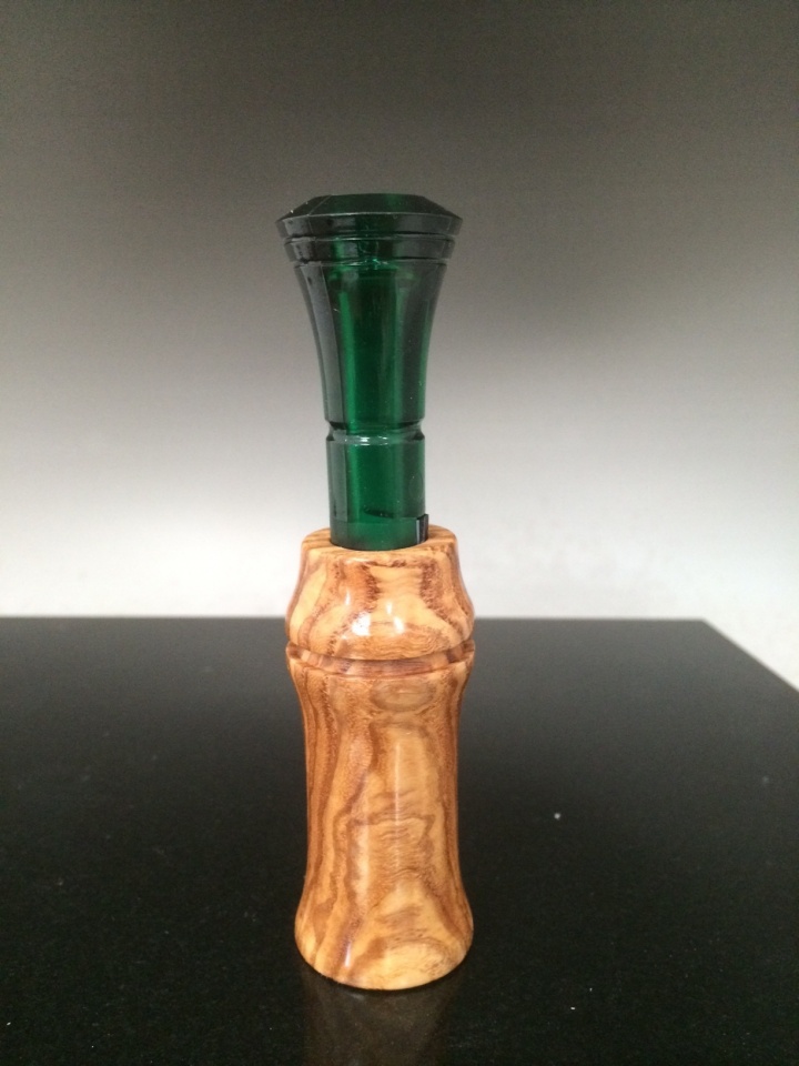

I sold the first 3 duck calls I made, so naturally I made some more:smile:

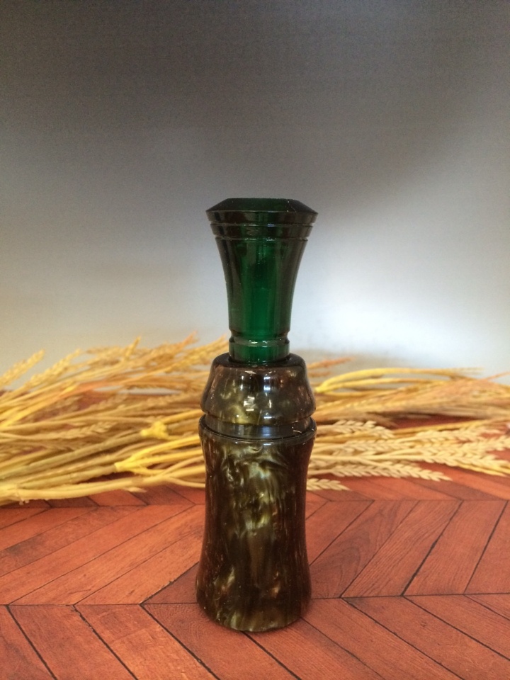

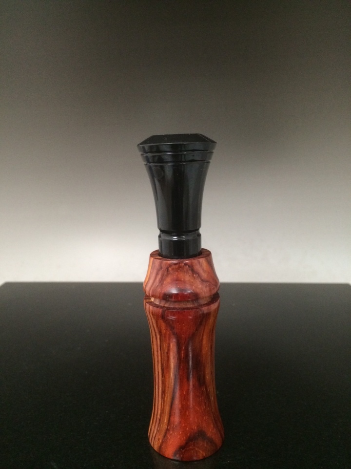

First one is olive ash, the next cocobolo and the last is a burly oak mica pearl blank from Hut.
I tried to photograph the last call a little differently in order to give it some interest. A trip to Michael's turned up some scrapbook paper and marsh grass.
Question/opinion: Which backdrop do you prefer? The plain one or the marsh grass scene?
Thanks for helping out. C & C welcome.

I agree with Andrew.
Additionally, the color of the call in the last picture would be difficult to show with a black and would look stark with a white background. The one you used looks natural, to me.
Good choice!
Thanks, Ed. I was really surprised by the way the mica pearl turned out. The blank was kind of a coppery color with a few black lines showing. Big surprise when it was turned and polished.

Thanks, Jim. I think it's pretty unanimous. I'll probably re-shoot some of the other calls for my website using the backdrop from number 3.
The third pic is the better one. But you have other problems with your designs, the top of the barrels lack enough diameter, the wood ones will likely crack. The first wood one the insert is not seated deep enough, going to take a lot of air to properly blow it. Also you need to show the mouth end duck hunters are pretty particular about how their mouth will fit their calls.
I would use bands on the wood barrels to keep them from splitting. Go to a sporting good store, look at the barrels, a duck call barrel design has some basics, try too emulate the features. They need to be comfortable in the hand and the mouth end has to be comfortable on the lips.
