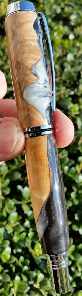

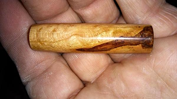

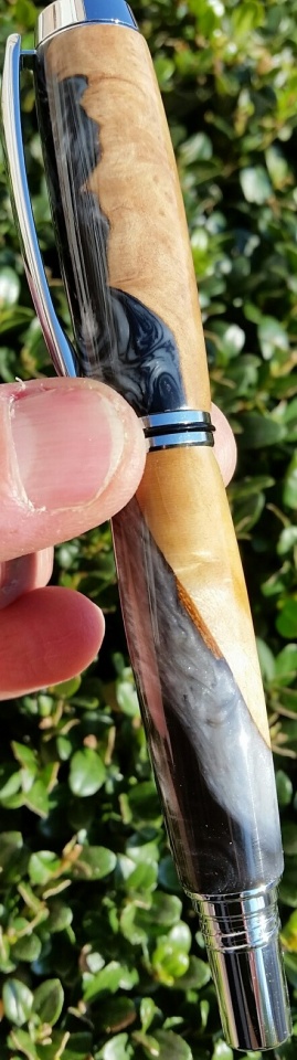

First attempt at using one of the Solarez (called Thin Hard).
Still learn and still have trying more of their product line.
I have more questions than answers and needs a few more under my belt to provide an initial evaluation. I have finished 3 so far. IMO The look of the finish is same as CA.
I will report more as I learn more. I believe others members are trying their products too. The company has dozens of options. I am experimenting with the 20 second and under cure products.

That looks very nice! I also purchased some of the Solarez, but have not had a chance to try it yet.
So does it build up the same way as CA? Before switching due to the respiratory issues with CA, I never could get the hang of the number of coats and how that affected the fit. All of mine kept ending up too proud. I got close before switching and really have no desire to try again.

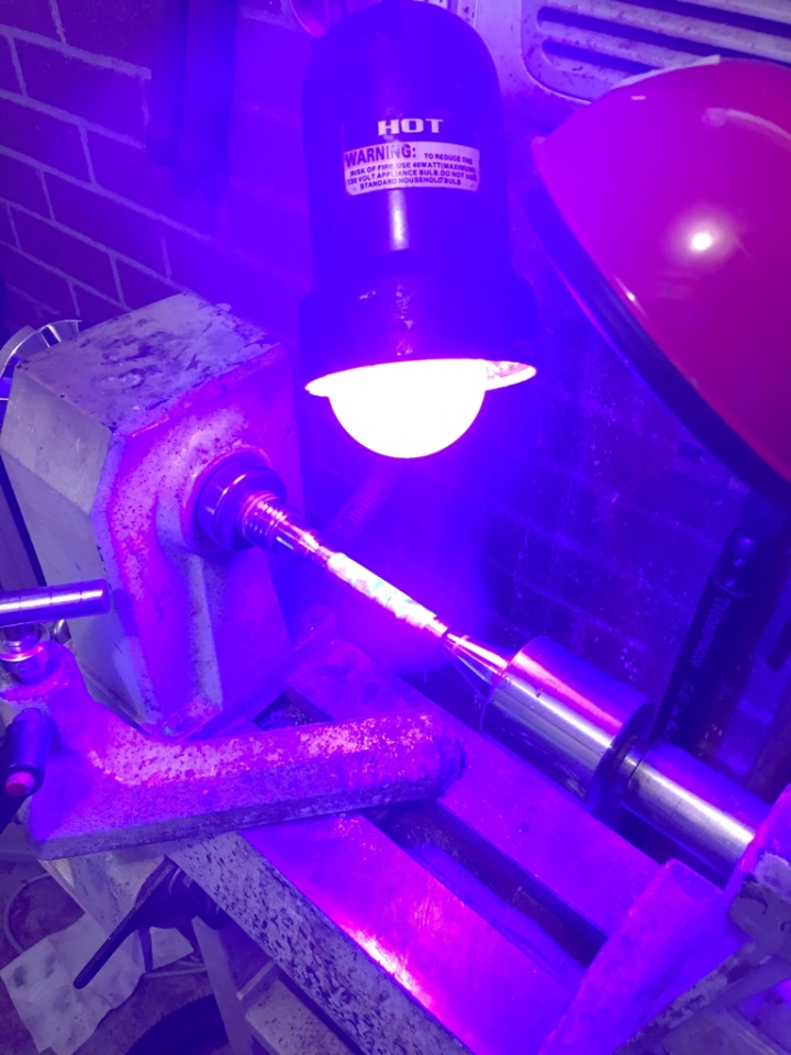

Using 35 watt light , but turning my pool cues for 15 minutes minimum to let the finish to flow out and get level or even .
Then turning the light on for 3 or 4 minutes and rotate for 15minutes and back on with the light for 3 or 4 more minutes .
I will do that 3 or for Times
Let the cue turn more for a hour maybe two total .

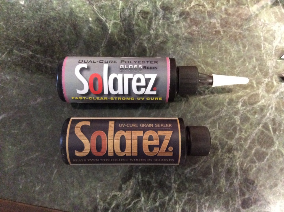

I received my order from Solarez the other day and last night got around to testing it out . With Tony's permission I'll give you my impression so far , now remember I'm new to the pen turning game but I am a fairly experienced wood worker and usually use nitrocellulose lacquers on most of my other projects . The products I got from Solarez are Ultra Thin Bone Dry and the High Output UV Cure Flashlight . The Ultra Thin Bone Dry comes in a .5 0z bottle , the flashlight takes either 2 cr123 batteries or 1 rechargeable 18650 battery of which I had so I didn't need to purchase any batteries . The UV flashlight is a quality light similar to a Mag Lite , aluminum construction with o-rings .
I turned a stabilized maple blank down to round between centers and sanded it to 600 grit just for a quick test , I applied the solarez Ultra Thin to the blank with the attached applicator brush on the cap , I turned the lathe by hand for this . I would say the first coat was thin , but I made sure I had good coverage . I continued turning the lathe by hand for another minute or so so the Ultra Thin could level out , then I applied the UV light and after about 10 seconds it was cured hard . I then repeated application and UV light once more the same way . Next I sanded starting at 800 grit and going to 1500 grit , then Micro Mesh to 12000 , after that I buffed with a paper towel and novus 2 followed by a paper towel and 3M Finesse It II . Here are some Cell phone pics of results .
There was a slight odor from the Solarez but not unpleasant or over bearing , it sanded well and has a good shine . I think I will go with more than 2 coats on an actual pen barrel and buff it with a buffing wheel . It has a different feel to it , almost feels like holding a glass tube .
I didn't spend a lot of time with this little test , but I like the results , I am going to play around with it more and may try some of their other products . My initial impression is I like it . Sorry for the long winded report , hope it helps add to the knowledge base :smile:

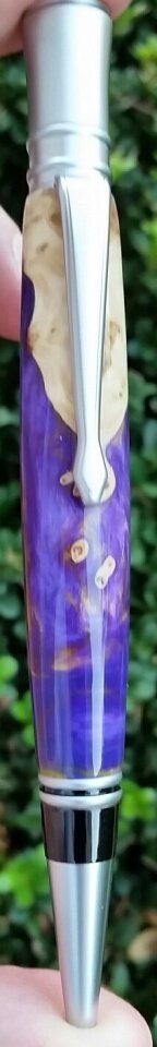

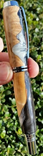

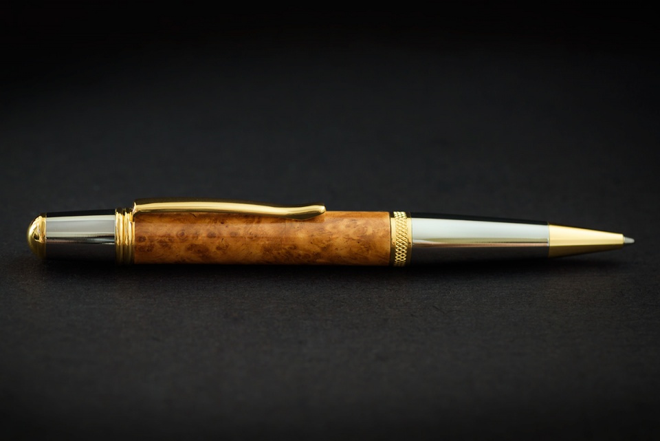

I also have sinus issues with CA and was willing to give solarez a go when it was brought up by Tony. It was useful for me to read the solarez frequently asked questions on their web site and then I leaned on two you tube videos on application and cure. One video showed the application on a pool stick which I tried to copy. The other video was of an individual applying it to a table top. His cure method was to take the table into the sun for a few seconds, let the cure get activated for a few seconds, bring it back in the shade, back in the sun... I don't have a UV light so I also tried to copy the method in that video. I'm sure just using amUV light would be more convenient and cut down on time, but I don't have one. Perhaps using the high noon sun is a better cure anyway?? I do like the finish. It looks very similar to CA but it feels different. It's hard to explain but during the sanding phase it feels more flexible and the feel seems softer (not sure that makes sense but I don't know how else to explain). For a short period of time before the cure it does smell like polyester resin but I'll take the smell over the reaction I get from CA.
I forgot to say, I did use sealer first. Put it on just like I do CA. Let it cure, sand to 400, then three coats of the other solarez in the picture. Finished just like I do CA. Sand to 800, then buff.
Redwood burl on a sierra.
Hope this helps some.

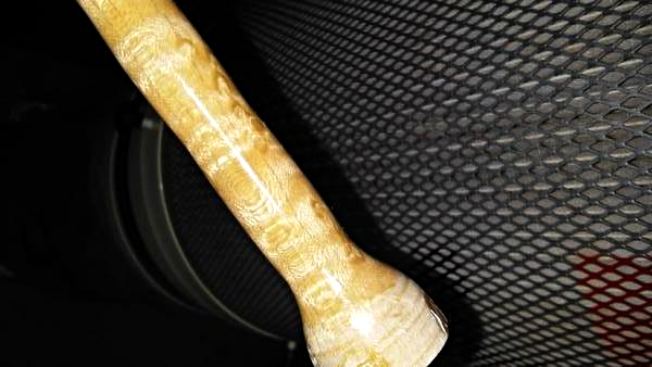

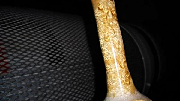

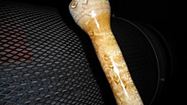

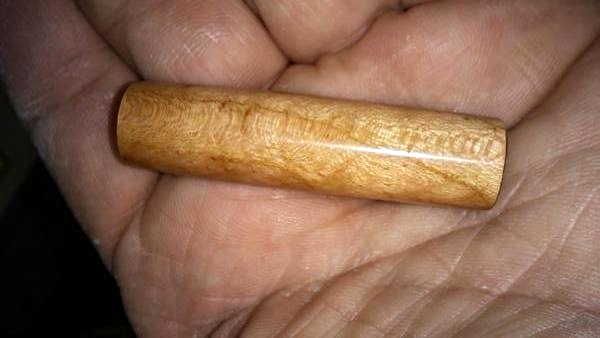

I did a little more with the Solarez Ultra Thine Bone Dry today , I did 4 coats on a stabilized cherry burl blank for a Bolt Action , no sanding between coats , I did cure each coat before going to the next . Like my other test I sanded to 1500 grit and then micro mesh to 12000 , then again Novus 2 and finally 3M Finesse It II . It came out pretty good , I feel more comfortable with 4 coats as it sands good I don't want any sand through . Here's a few pics
My maple test piece from yesterday , I took that and beat it aginst the corner of my maple topped work bench 3 times pretty hard , no cracks or scratches , its pretty tough stuff .
With the pics
If you try to apply very even coats while rotating them slowly you can sand starting at 800 or higher and go right to the buffer or whatever your final step is. You will remove little and have a bump free finish. I will send some pics later (not that my finish is any better than yours).
Tony , I did start with 800 grit with this second test on the cherry , then to 1000 , then to 1500 , before the micro mesh , I am thinking I could probably skip the micro mesh and go from the 1500 grit sanding to novus and Finesse it , today I put a 6" buffing wheel on the lathe and buffed it a bit with Menzerna fine compound , it did kick up the shine a bit . Then I assembled it .
I'll use this pen for a few weeks and see how it holds up but like I said before , so far I like this Ultra Thin Bone Dry , I'd like to try the secret formula they made up for you , maybe they'll have it on the market soon , if not I'll give them a call .
