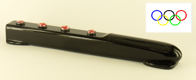

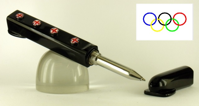

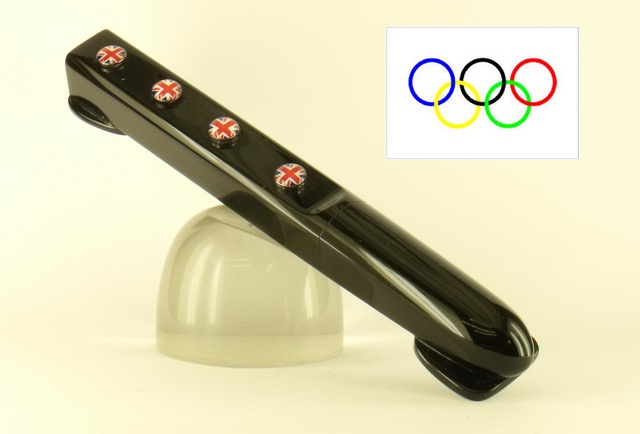

I like making 'themed' pens so here is my rendition of Team GB's 4 Man Bobsleigh at the recent 2014 Sochi Winter Olympics. I think only the second team had the Union Jack flag on their helmets. The first team was just black.
When I was watching, I noticed that on many of the bobsleighs, it looked like the front nose cone was about to fall off, and figured that it could be a pen cap......:rolleyes:
So just for fun, I made this one today. The 'helmets' are earing studs.
Hope you like it.:biggrin:

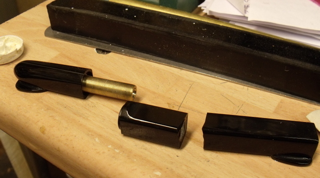

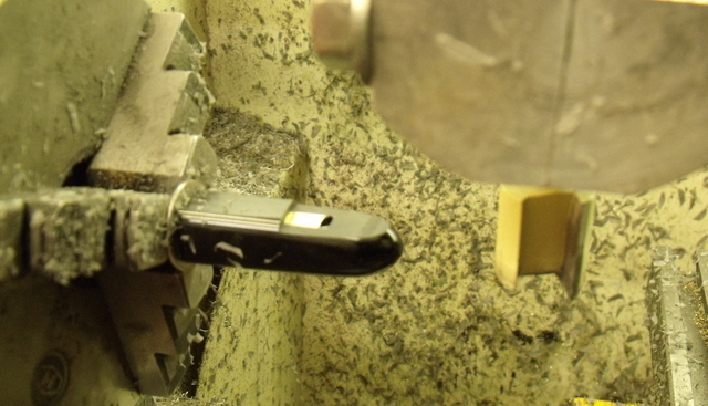

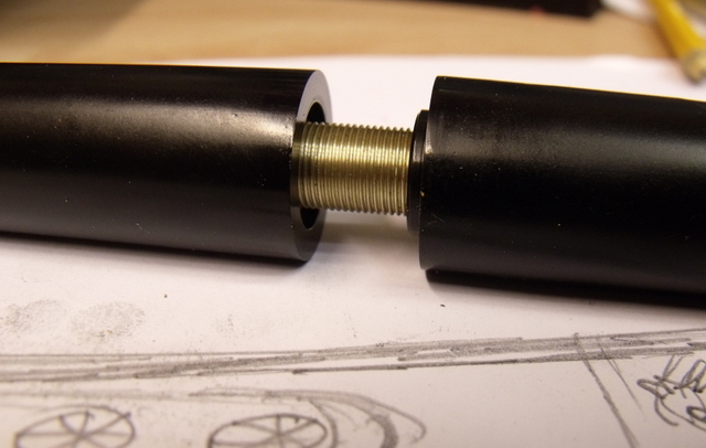

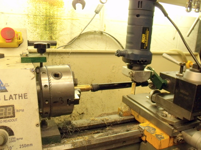

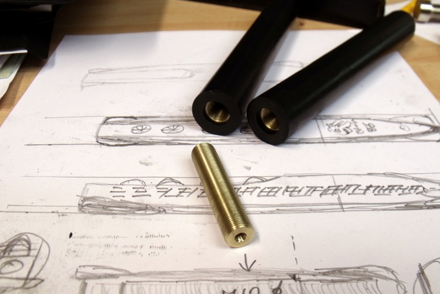

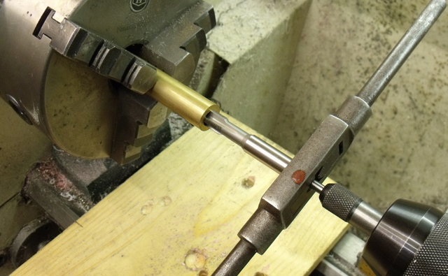

1. Thread some brass to act as the tube / couplers. 10mm x 0.75 with OD 12mm
2. Make a long dummy threaded mandrel to support things while they are being turned / routered. Can't rely on the short thread of a nib.:wink:
3. Join two round blanks with a male / female recess.
4. Router three and a half sides. The half is the top. Also for the 'wings'
5. Sand and polish till you get blisters:redface:
6. Drill tiny holes for the earing pin, which has been cut short and glue them in.
7. Knock up a stainless nib.
Job done!!:biggrin:
