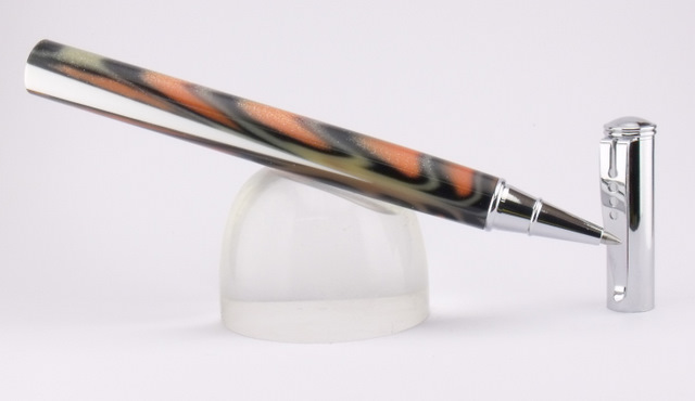

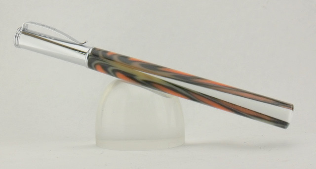

You can tell I've got some free time:biggrin::rolleyes: Two in one day!!!:tongue:
I'm waiting for a shipment of decent kits to come in and my addiction made me use another UK kit until they arrive.
One batch came today but and I was stunned to see that I had actually ordered the wrong pens. I really wanted some Jr Gent rollerballs, but instead I ordered full sized fountain pens:mad: Oh well.....
This one is made with left over strips. I actually quite like it:biggrin:

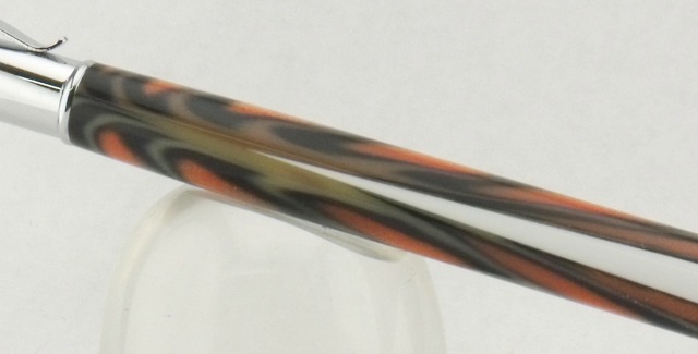

Seamus, it's actually very easy.
Take the lengths or slices and sand one side with sand paper on a flat hard surface. I think this process is called 'Lapping' Then glue one to the white piece ( in this case )
Then cut through them to get the sharp angle. Sand the cut side again and glue the other slice on. The hardest part is making sure you drill down the middle. This one was pretty close I think:biggrin:
EDIT; Just added this close up, Seamus. If you sand to around 1200 grit, then you shouldn't see any glue lines:wink:

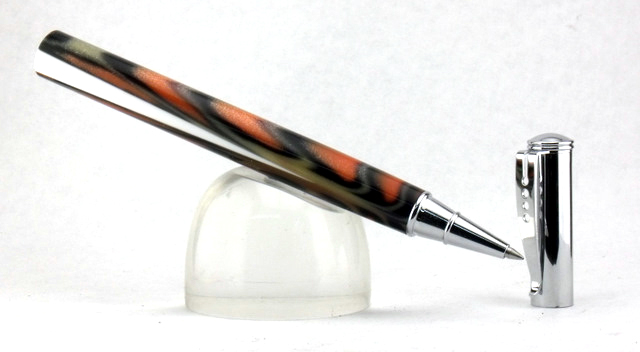

LOL, of course I don't mind Toni:tongue: You embarrased me so much I even went back and took new pics ( see above ):biggrin:
