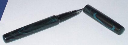

Here's one I played with which used the nib section from an old Shaeffer. I'm not too happy with the overall design, particularly the step, but if I were do do another, I would use a similar approach. Note the little square pin-like protrusions at the bottom of the nib holder. I found a brass tube that was a little snug fit over these and though it is a little looser than I would like, seems to work.
If I was starting from scratch, I would use little round headed pins and try to find a tube that was snug or better yet, cut a groove in the cap to snap in. I'm sure there are other methods - best source is old pens.
