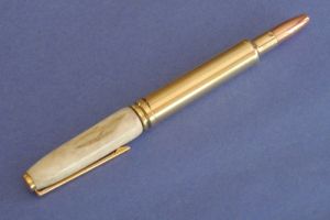

I made this pen this past weekend from some 300 Weatherby (mag.) brass & bullet given to me by a co-worker. The magnum casing is long. I used a 7mm pen kit and a spare 7mm brass tube from a magnifying glass kit. With the transmission pushed in place, there is approx. 1/2" extending beyond the brass to engage with the cap. It still twists fine, and does not feel like it's jamming.
