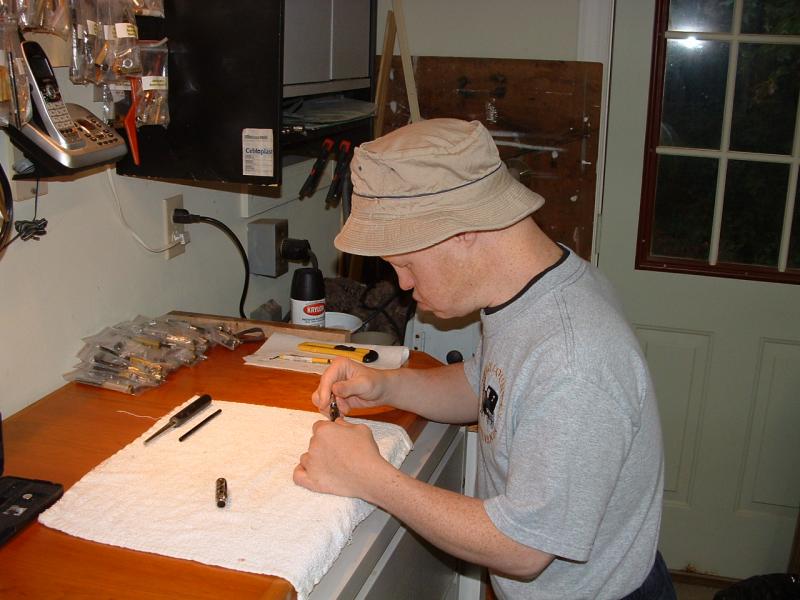

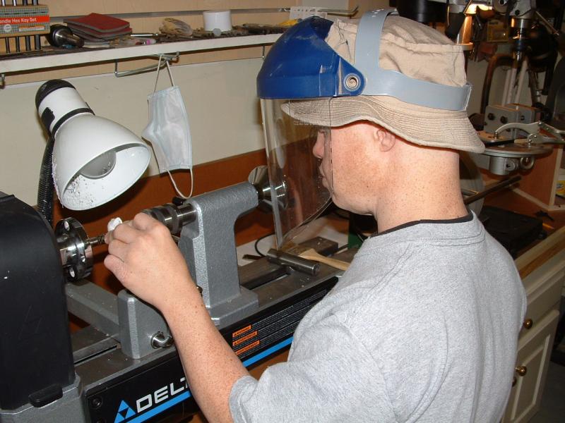

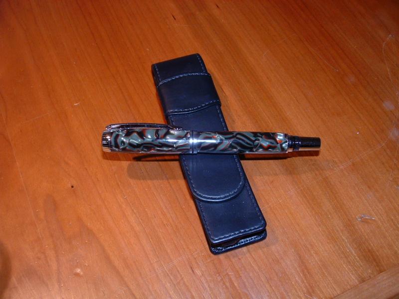

I just completed one of Smittys' JG 1 kits; used a 25/64 and a 29/64. Drilled a cebloplast serpentine on the lathe and they worked perfectly. These are the same bits I use for the Baron.
Here are pictures of my son polishing and assembling the pen after it was turned. Craig is my son with Down's who loves to work in the shop every opportunity he gets.
Bill Sampson, Richmond

Bill nice job on the pen, I love Cebloplast, I wish I knew where to get some of the Ruby and the Ice. nice to have your son in the shop.
