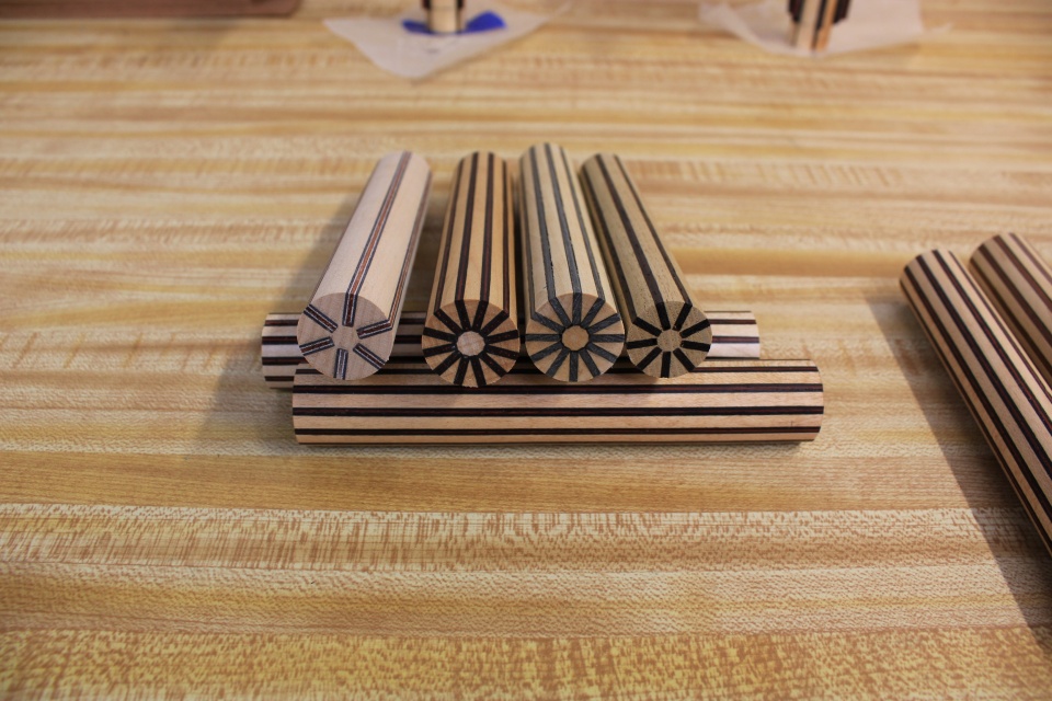

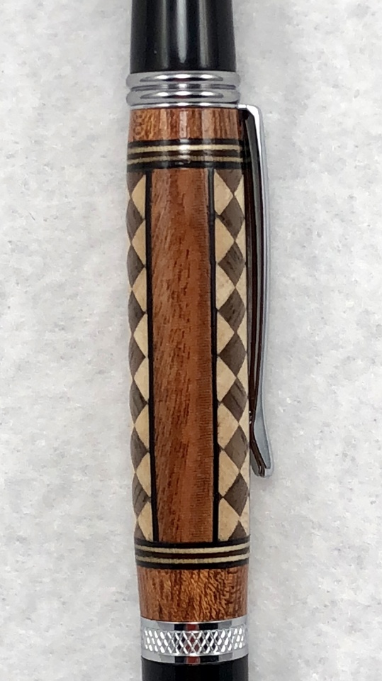

A few weeks ago a few "Old Sh..s" got together at MrDucks2 to make a mess. (Even though Ernie doesn't qualify as Old we let him come because we needed entertainment :biggrin:).
This was my main accomplishment.

I assume you made a whole (or half) blank-length of the "pattern" and then slice off what you need. Would love to see a cross section of that rod, please, if you can.

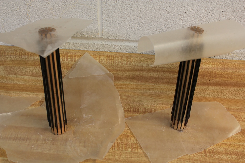

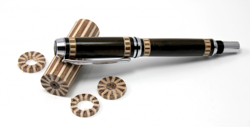

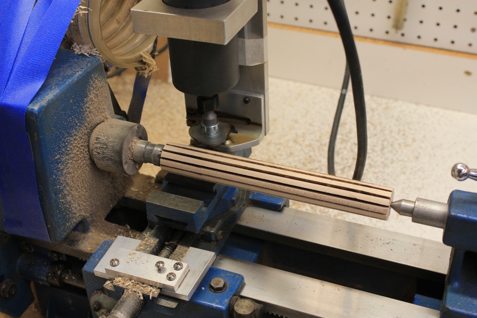

Hi Mal: I'll assist in any manner I can.
This may not be the exact picture of the rod, but if you substitute the darker brown, which I suspect is the infamous... broom stick rod; closet rod, misc Home depot rod... It will be a very plain, cheap 6' section that I bought to practice my skew skills (that didn't go well!).
But the elements are the same: I used a metal lathe chassis, side mounted hand-router; slitting blades; 360 degree indexing plate; west system marine epoxy; accurately milled inlays.
This would have been any easy inlay. Only 12 thick slices, vs 36 thinner slices for a 3-ply 12 inlay. (Same number of inlays, just a single inlay vs a 3-ply).
Please ask any questions.

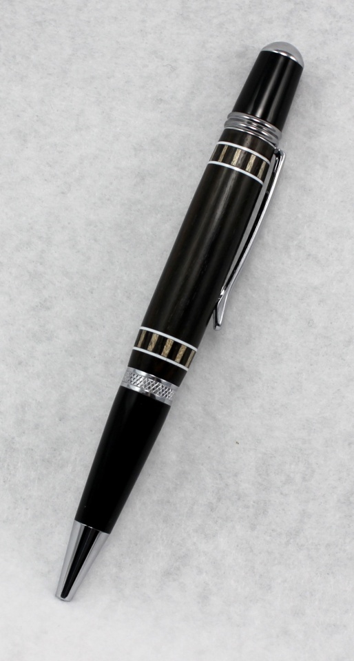

Mark, I am a huge fan of the work you do, especially the trim rings. Is there a way to do that without a metal late? I can see by inspecting your setup how it's done, but I wasn't sure if there were any other methods. Maybe I should just add a metal lathe to the wish list!

Hi Ronnie: Yes, there are other methods. Some folks (that have far more precise skills/equipment than I) cut angled staves to construct these. Others have simply used a hand router mounted on their wood lathe and used the lathe supplied indexing feature (if present), or had added precision indexing plates. Others have simply used the table saws.
All of the above methods, including my set-up will have various equipment needs and learning curves.
Then there is the method of how to do the inlay.
I'll freely explain how I do my blanks/segmented designs as I have NO ISSUE if anyone wants to "give it a go." But, I'll let others explain their methods if they wish - some folks feel a bit "protective" of techniques at times; which I understand and respect - I just don't feel that way about my work.
A PM will follow.

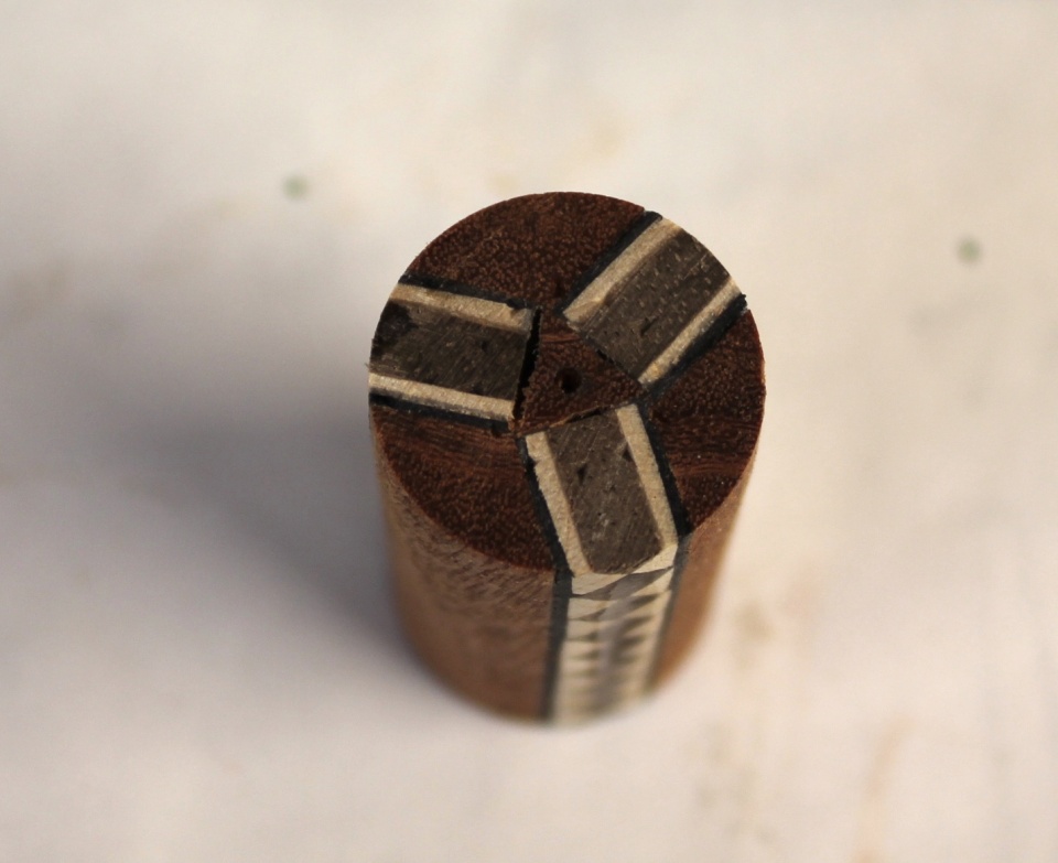

Mark,
Thanks for your reply and the detailed pictures. . General idea I get.
A thing I don't get is ... when you do the longitudinal slitting, the adjacent slits seem to meet near the axis of the main dowel which is being slit. . And if the slits meet, the wedge-cross-section piece in between the slits would fall out ! .... or does the wedge-cross-section piece still hang in there in an extremely fragile and precarious way ?
mark james
IAP Collection, Curator
Sep 6, 2012
12,752
Medina, Ohio
Mark,
OK, Got your query Mal.
YES, I have had some slotted blanks that failed due to what you described.
For the 3-inlay blanks, I can cut a slot about .25" wide, to a depth to insure the final OD of the pen is intact for the design. That will leave enough material for the inside triangle (Picture to follow) for it to be good. However, I cannot cut a .25" slot on a 4-inlay blank. The inside depth is too great and the pieces fall apart (not a good description, but the result is bad).
So... going to a lesser width of the inlay, .240, .230, .220, etc.. We have more options to go for a 4, 5, 6 slotted inlay. When I go to the trim rings, I can cut my slots for a solid or 3-ply inlay very thin; probably .0625+. So things can get interesting.
