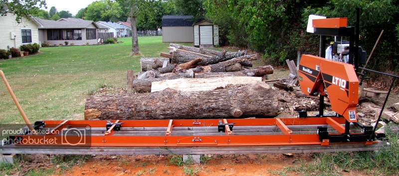

Here's the log on the ground next to the mill:

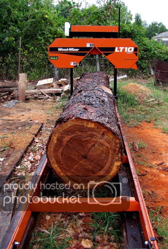

And here's the same log on the mill:
(Of course, the magic of digital photography makes it look pretty easy. From on the ground to on the mill was approximately 8-10 minutes)

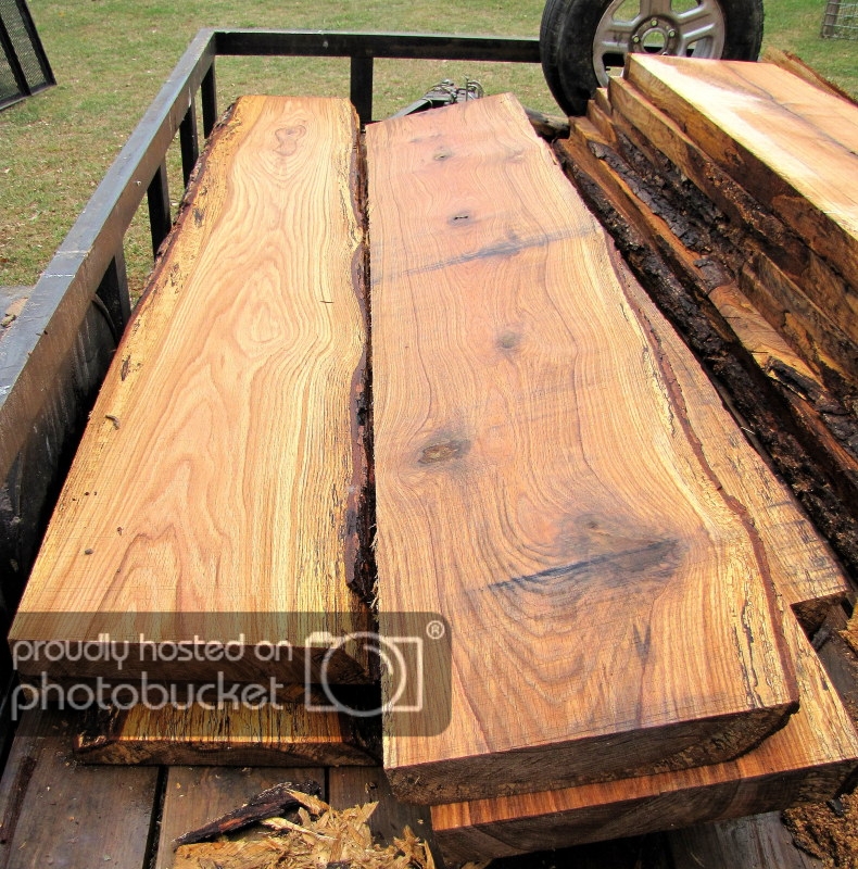

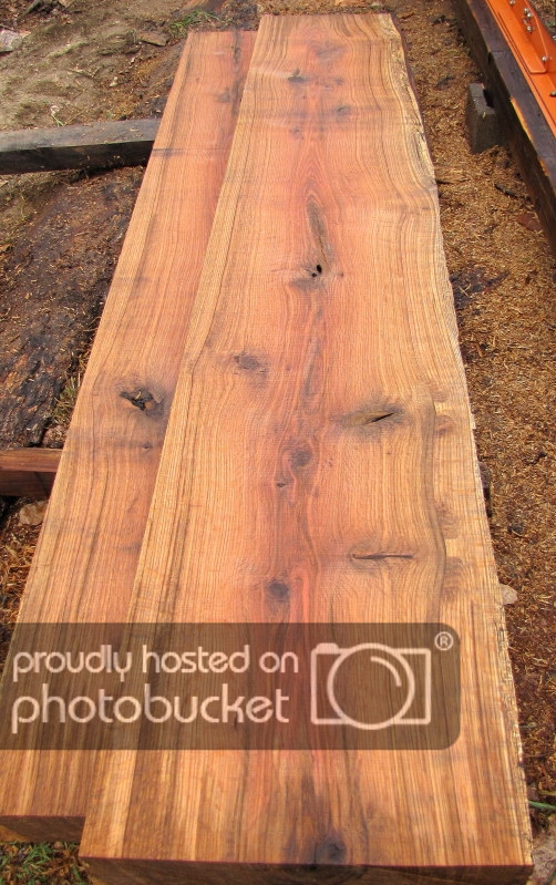

This log turned into this:
(The fella is going to sand these slabs down and make bookend table(s) out of them. Hope he doesn't need to move them around too much...them tables would be very heavy!)

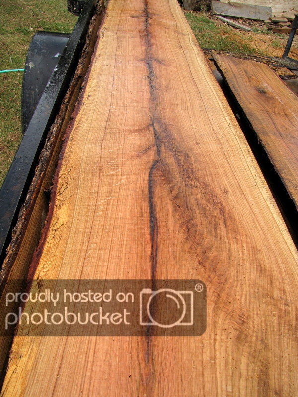

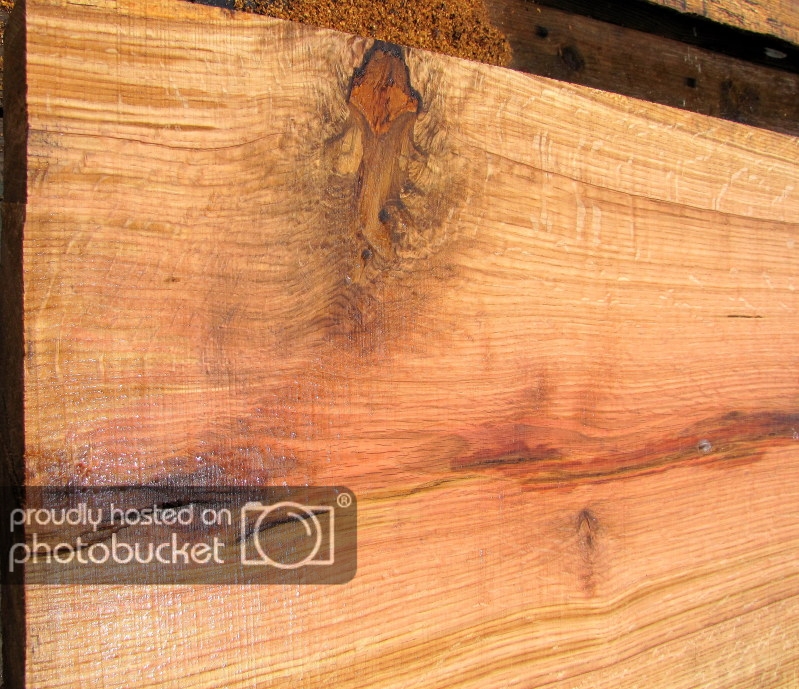

Who says White Oak can't be purty?:

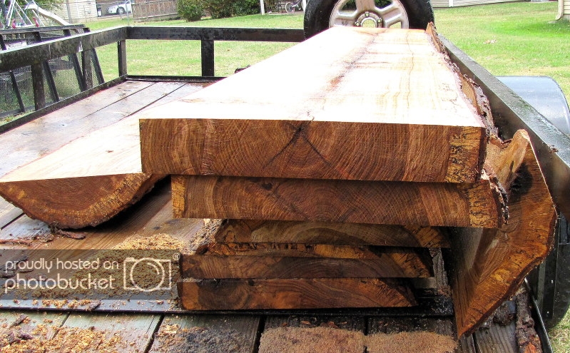

Hope you enjoyed the woodporn? I know I get a kick out of being the first to see what the inside of a log looks like. A little sore, oh yeah....those slabs weigh around 150-200 pounds a piece(the 2-1/2" by 10'6" laying on the ground next to the mill will require the help of a young fella to get into the trailer. For whatever reason, everything seems heavier when it's wet? Go figure??
The fella is suppsed to be here this afternoon to pick them up....hope he likes them(he got a pretty good deal on the cutting)!

I'd like to know how long it takes for one pass of the saw to cut a slab, and what the blade? blades? look like.

The blade is .024"(1mm) thick, 1.25" wide and 144" long. It travels on two wheels covered by fan belts.
The between the guides cut is 20" and the slab can be 4" thick between that 20". The track can be as long as you want by adding 7' sections. I have two sections at 14'. But the mast on the two sections will let me cut up to 11'-ish.

One pass with a full width piece like these.....about 2 minutes, maybe 2-3/4 minutes at most. To get a super fine finished cut, I turn the volume up on the water system and go really slow...maybe 5 minutes for a cut! Almost can get away with a starting grit of 220 or so.....
