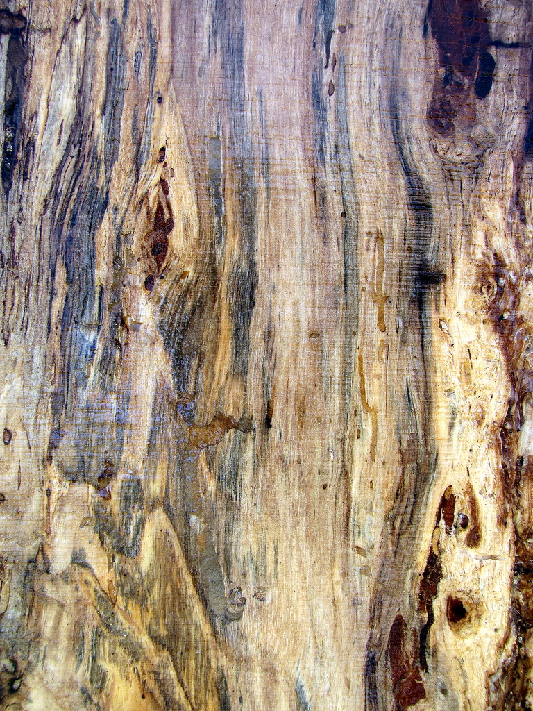

Scott, you're having too much fun with that new mill. Will we get to play with it one day? I'm planning on making it down there one of these days. Ted
They're starting to get a little rough in the cut ....
You'll want to bring a small broom and brush off that railing that the power head rides on, the sawdust is making your rig bounce around a bit and that makes the cut ragged ... the other issue is a dull blade. Sharpen it before each job, perhaps? Also, don't forget to keep a spare or two in the truck! :)
Well, I hate to differ....but since I know what is happening. You're wrong on all counts, respectfully.
You do not wipe off the rail with a broom....ever. WoodMizer has developed a system that does it without the use of abrasive brushes.
The 'rig', better known as the millhead, does not bounce around.
The band is sharp. Sharpening a band isn't like sharpening a chainsaw... I won't go into the full extent of it, but it requires a complex piece of equipment that sharpens and sets the bands. BTW, I carry 30 bands....

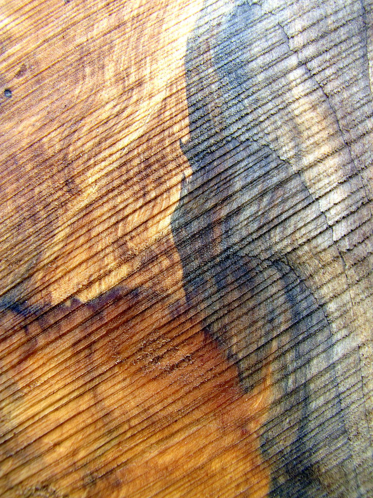

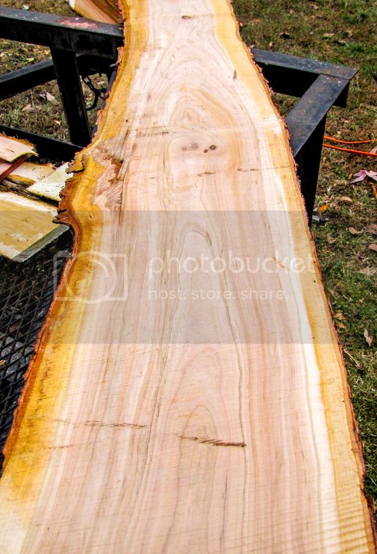

Here's my last CSM item American Sweetgum...
Now that is a nasty kerf:eek: But it's what can be typically expected using a chainsaw.
Scott (eye-candy though) B

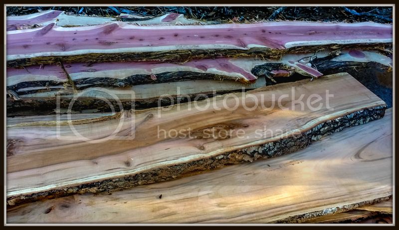

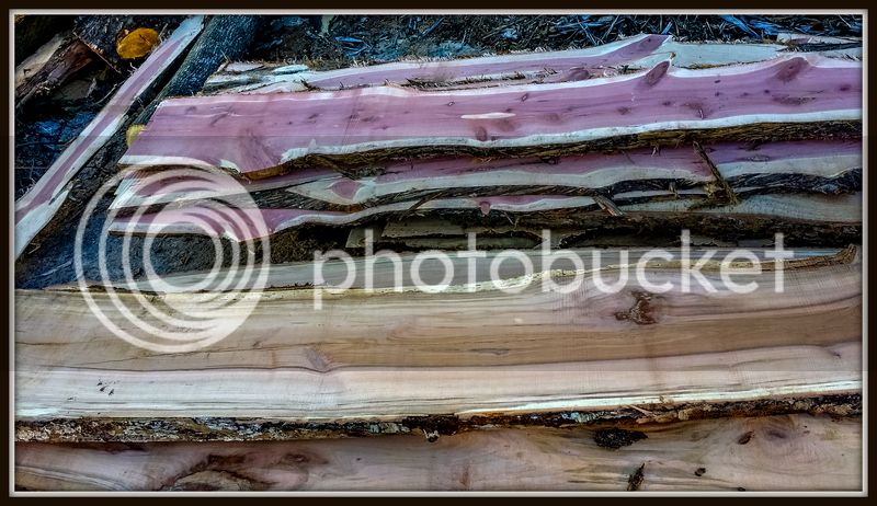

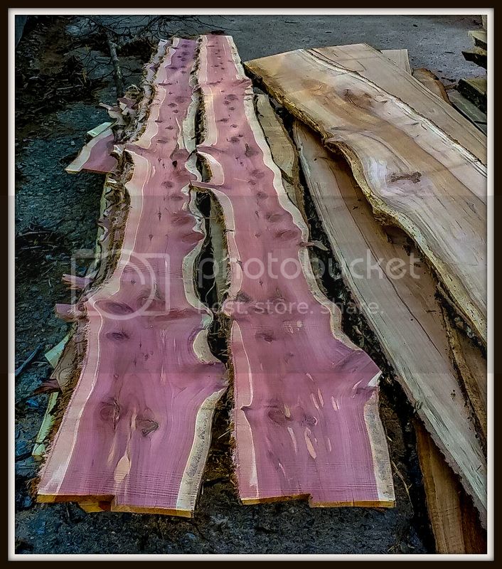

Didn't do a time lapse, or any 'cool' stuff....just milled 2675boardfeet of Southern Red Oak - quartersawn, so it took all day....
This morning, after the rain, I took the mill to 'work'{yes, it was my day off} and milled my stash. Wind and cold might may been a factor...it guaranteed that every bit of sawdust coming out of the 'exhaust' ended up in my face!
I've been collecting random logs for the last few weeks...
Eastern Red Bud, Persian SilkTree, Eastern Red Cedar, White Oak{inclusion}, Black Cherry....it was a bit to do. Made about 255 boardfeet of 'stuff' for future pen blanks, as well as a lot of scrollsaw blanks{2/4 thickness to be planed down} for the 'boss', and I made some bonus 8/4 thickness stock for duck calls{next years stock}!
The Persian Silktree had a small crotch in it....close-up.
The day was fun!

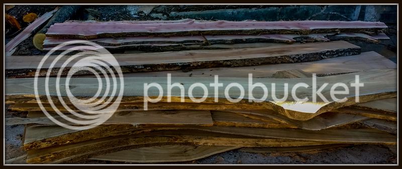

Whew.....love working up a sweat! It may have been cool as far as temperature, but the hot timber I was seeing was worth it.
I hated having to slice up those wide flitches of Black Cherry 8/4thickness. I could have seen that piece hanging in a room, covered with family heirlooms....but instead, it'll become game call blanks. That's fine too....but wide timber is hard to find.

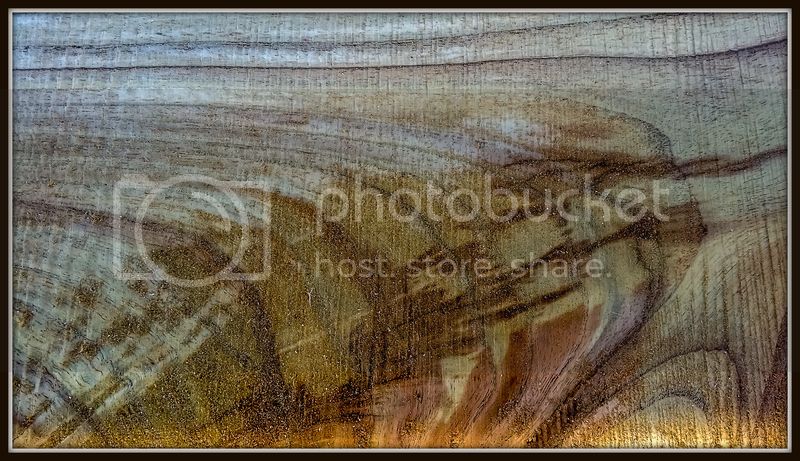

A close-up of some Black Cherry

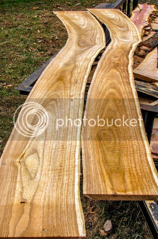

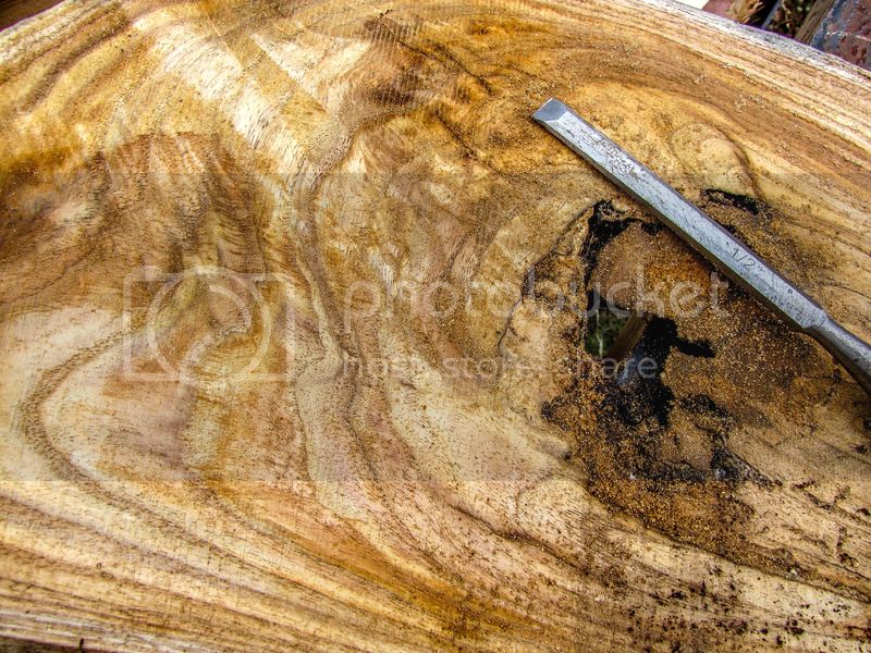

This stuff here is fun too, it's Persian Silktree....commonly mis-identified as a 'Mimosa tree' by just about everyone. Not sure why that happens, but it does....Mimosa is a sub-species.
A close-up of a piece of Persian Silktree crotch

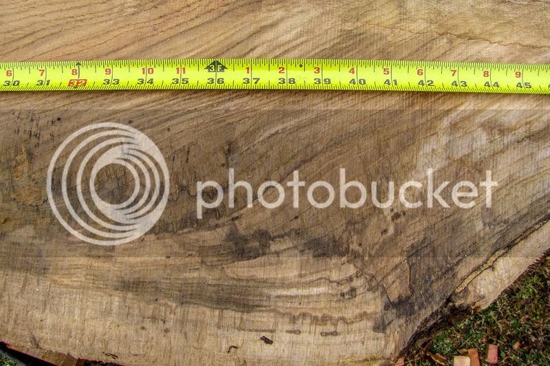

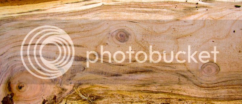

Here's a very common timber, White Oak....but this is from the 'inclusion' on the tree. The bark basically gets forced into the grain and makes some really unusual features.
The stack has made the move to the concrete slab, and is stickered for a 'while'....air drying isn't really fast in Arkansas during the winter, but it'll happen. After a while, I'll go back to the stack and process the pieces into blanks.
Thanks for following along on the topic..... If you have any questions, feel free to ask.

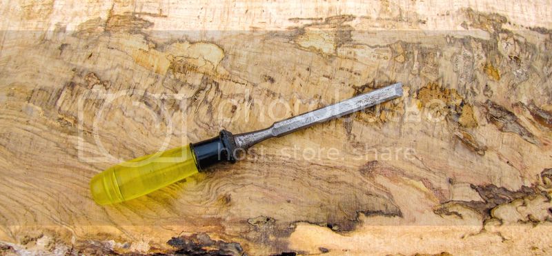

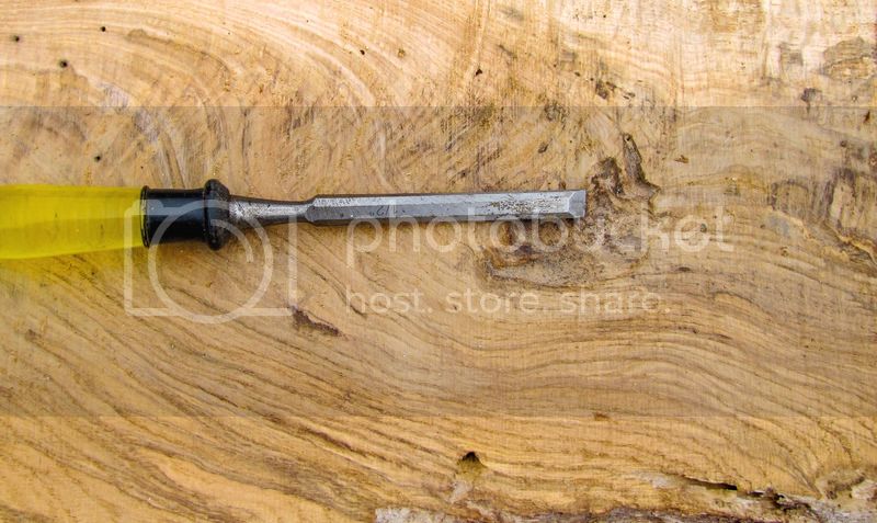

Was in the shed, looking around for something.....go figure, couldn't find what I was looking for. And by the time I got the door shut again, I forgot what it was I was after......
Came upon this one
Seems it's dry! Boxelder 'bump'(not burl and not a knot-but almost a little of both). It has a crack towards the bottom, but it doesn't get into the figured part. Maybe I'll wiggle it out and give it away at the next penturners meeting?
:eek:Be a pretty nice bowl blank, or 50 bottle stopper blanks, or 300 pen blanks!:eek:
