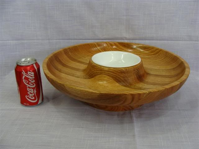

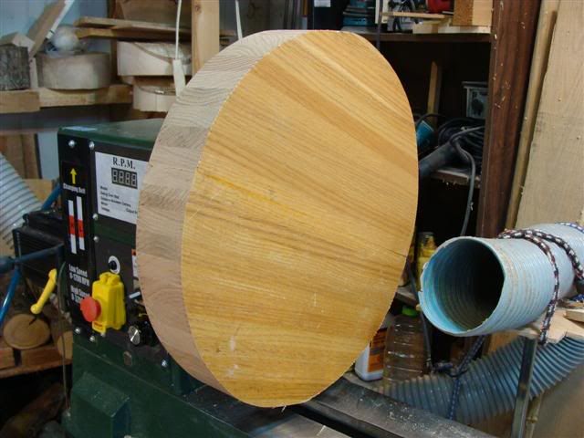

This is part of the 8" wide x 2.5" thick laminated red oak mantelpiece that I got from Bruce (gofer) . I laminated two 16" long pieces of it together to give me a 16" square and then cut a 16" circle from it.
Here it is at that stage mounted on my lathe . That is getting close to maximum on-board diameter on my 18 x 47 lathe but then outboard turning could be much larger.

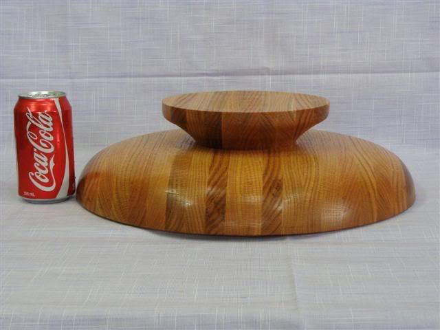

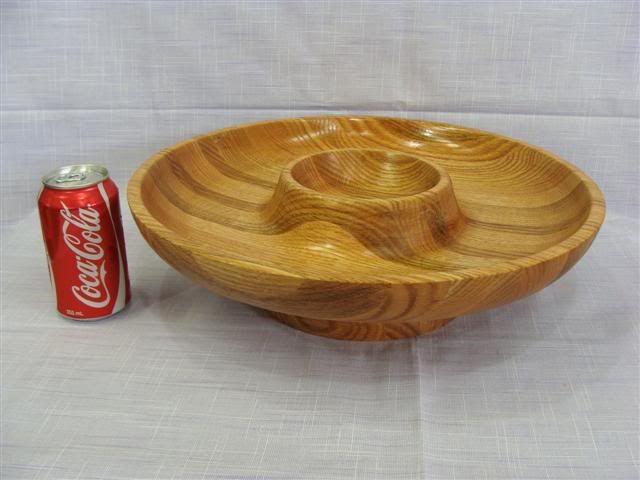

Here is what I turned from that piece . The coke can is for size reference.
Here it is with the glass chip dip inside the wood center bowl .
I put a heavy 8" diameter oak pedestal on it for stability .
So far it is just finished with a couple coats of Watco Danish oil . I will probably give it a couple more and then allow to cure for a week or so and then buff it..

That was all done with , (apart from the six inch big lathe face plate) , chucks that are designed for pieces up to 10 or 12 inch like my Barracuda 2 and my Oneway Talon chuck that I used on my Jet 1220 mini lathe..
A heavy duty chuck is near the top of my shopping list. Just waiting for a good sale on one. My small chucks were OK for this 16" shallow bowl but for deeper ones I would feel safer with a Oneway Stronghold or equivalent.
