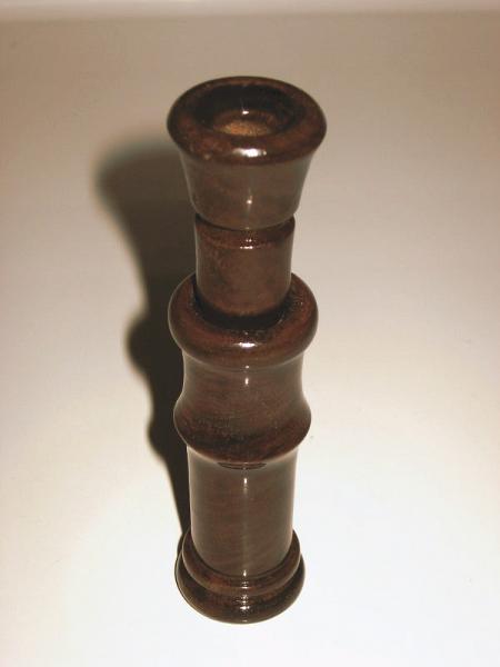

This is my first game call period. A friend at work said I should start making duck calls. He said if I make them, he would sell them. So this is my first one. I've been reading up and from what I can tell it could take as long to tune as it did to make the call. I believe I will leave that to my friend who's the duck hunter.

I cut the tone board into the rounded end of the insert. I copied a "Primo Call" and took all the measurments from it. This is my first and last 3 piece my next one will have a seperate tone board and not one that i have to cut into the insert. They got to be easier.
Looks good , how did you cut the tone board ?

That's not a kit? You cut your own tone board.. that's pretty good!
From what I've been told, that's make or break for a call.

The tone board is what the reed (.10 strip of mylar) lays on and is held in place with cork. The length of the reed determines the tone the longer the reed the deeper the tone and then its trimmed to adjust. This is by only what I've read I'm not a duck hunter. As-matter-a-fact after I made it... I blew in the wrong end of it. I did'nt know which end was which:embarrassed:. I just tried to make it just like the one he gave me. I still dont know how to use one.

What do you mean by cut the tone board? I'm going to try one myself.
