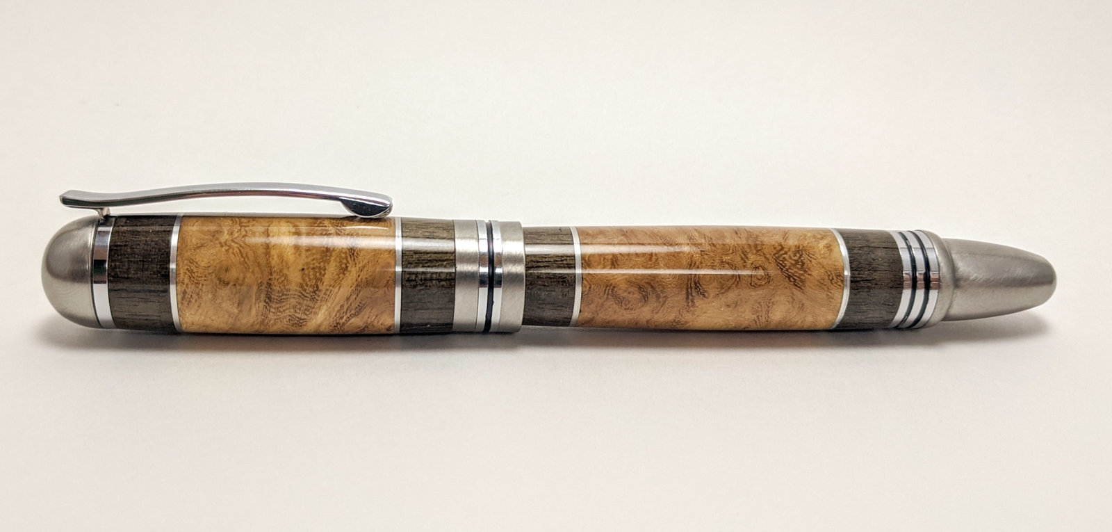

This is a Poseidon rollerball kit from woodpenpro.com, black locust burl and blue mahoe with aluminum accents. It's a pretty solid kit, basically a Churchill clone but with stainless steel components and chrome accents. I'm not super thrilled about the metal-metal cap threads, just a little worried it won't hold up well. Other than that minor concern I'm pretty happy with how this one turned out.

Nice job Sam - really like this! Beautiful choice of woods and great fit and finish! I have not seen the Poseidon - where do you get it?
Thanks Keith. It is from woodpenpro.com: woodpenpro.com/products/stainless-steel-ink-poseidon-master-pen-kit
The site is run by a guy that has been around the pen world for quite a while, he is well respected and I have only had positive experiences. I would say that the quality of the kits are mid range, but I have only tried a few different styles so far. He usually runs a 10 or 20% off coupon code, so the overall value is high IMHO. He has some unique design elements, lots of Hawaiian theme which is fun. I'd recommend checking it out.

I love this basic design, very attractive and really highlights the woods. Great combination also. Well done. 👏

This one's out of the ballpark! While you call it a simple segmented pen it's actually quite elegant. Sometimes simplicity lends an air of class a more intricate doesn't. Is this kit the same size and use the same bushings as the Churchill? It looks very similar.

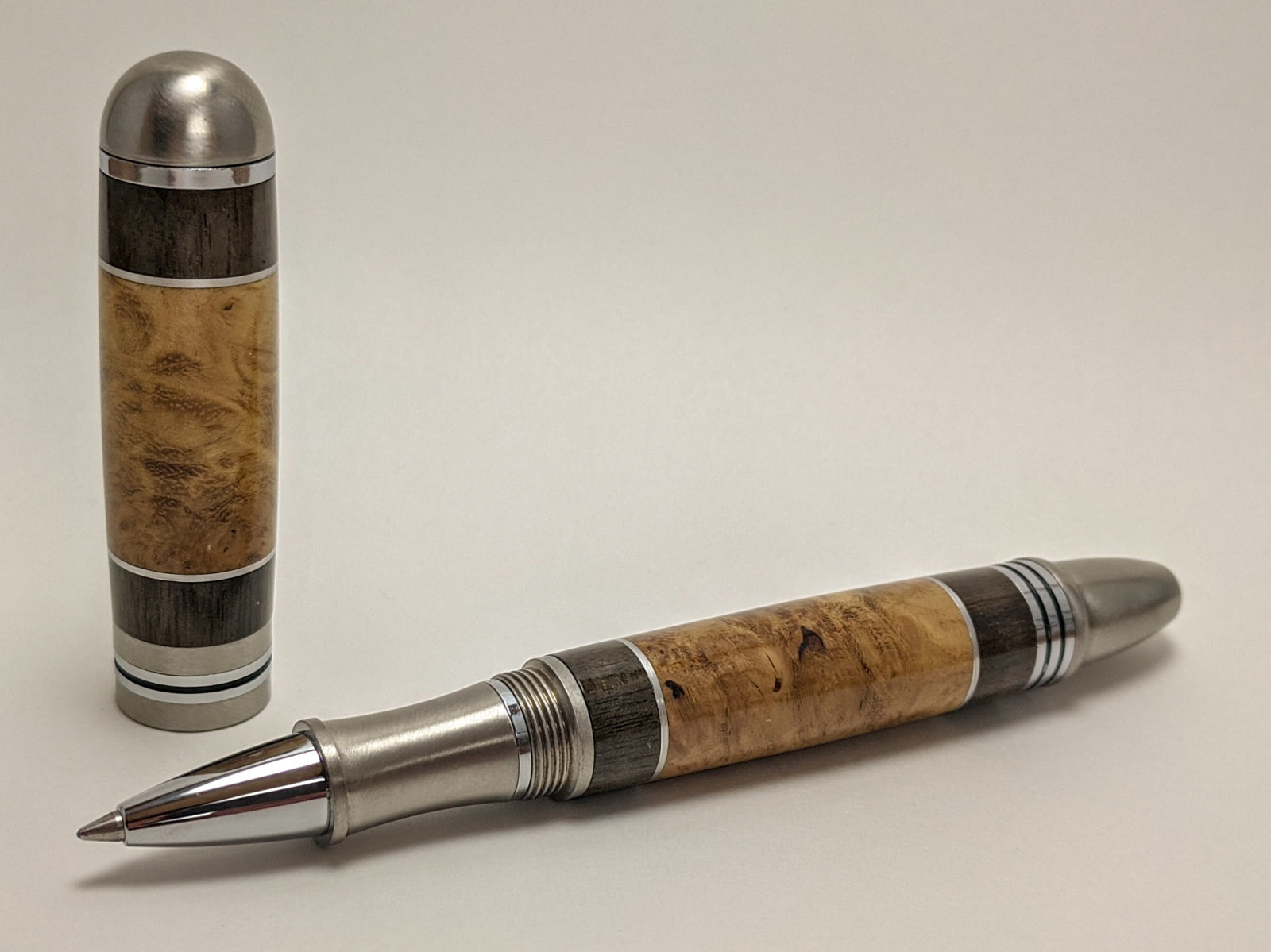

I suspect that it isn't identical to the Churchill (Bearea Hardwoods), but it is very similar. The drill bits are specified as 13.2 and 11.7mm, which is slightly different than the 33/64 and 31/64 for the Churchill. For the cap I used a 13mm bit and some sandpaper, and for the lower barrel I think I used a 15/32 and added some CA to the hole to help stabilize (my options were either that or 29/64 with some sandpaper). Also, the lower barrel for the Churchill is the same diameter on both ends, for the Poseidon the nib end is slightly smaller diameter than the post end. The cap is close, I think I measured it to be 0.596 versus 0.590 for the Churchill. Long story short, I wouldn't trust using the same bushings for the Churchill and Poseidon, but since I TBC I don't worry about bushings anyway.
