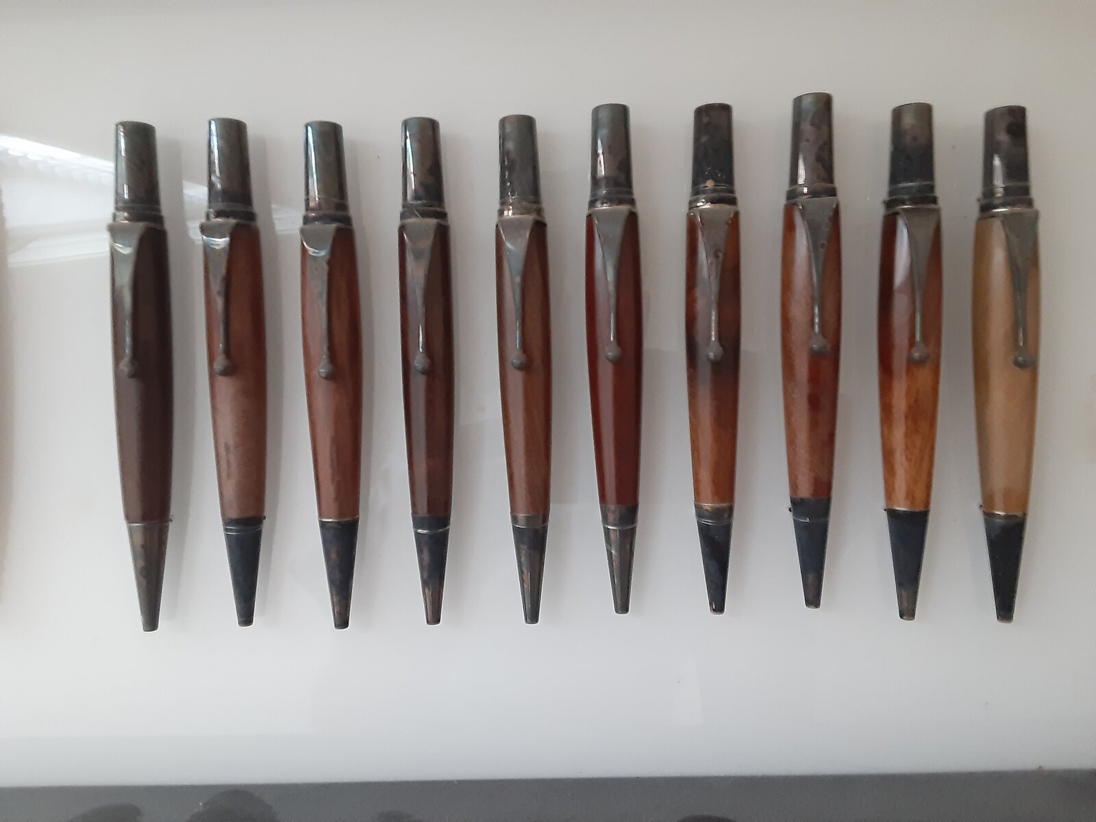

Many years ago (20+), I purchased sterling silver pen kits from a website in England. Made many pens, and like most silver, they tarnished. Over the years I tired several ways to "seal" them. Nothing worked. Photo taken today.
Ugh. That's not good.
If I were to go down the silver road, I understand that Argentium Silver doesn't tarnish, or tarnishes less.

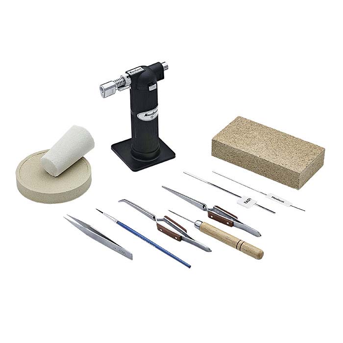

Buy a soldering kit and fabricate them from square wire. Wire is comparatively cheap.
Thank you, John. That's a fantastic idea. I wasn't aware of this option and is exactly the reason I posted my question here. 20 gauge Argentium square wire is $2.50 per foot. I'm pretty sure I could make that work. Quick look into fusing silver, I think I'd need some flux, torch, and copper tongs to close my rings.

There are several varients of arc fusers on Amazon
jewelry fuser

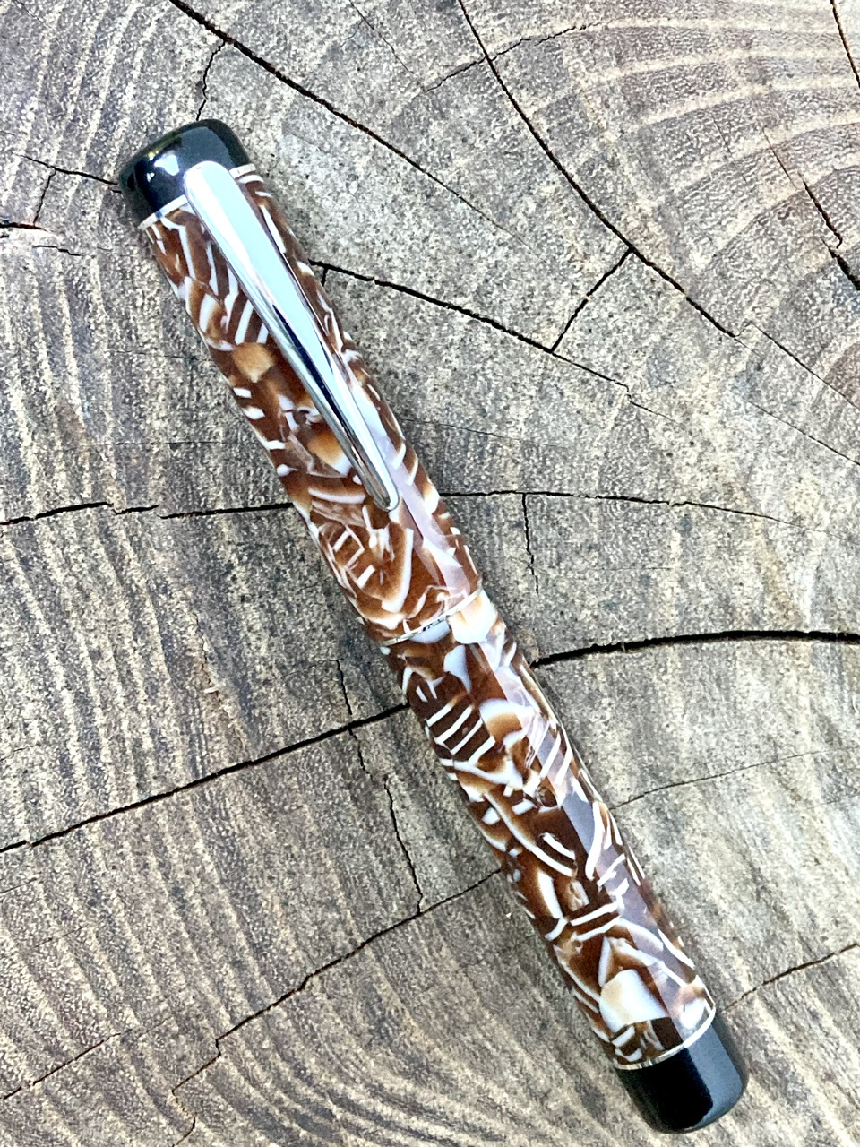

I bought Argentium Silver square wire, 20 gauge. And made jump rings. It wasn't too hard to do, but time consuming.
Here are the first two pens I made with silver accents. I'm happy with them overall. The silver sings so brightly compared to aluminum.
I have ordered 14 gauge square wire for next time. The 20 doesn't give much room for error. For example, I wanted to shape the brown pen a bit more, but had to stop once I hit my silver ring. More experience and better planning will help, but doubling my wiggle room is probably best for now.
I like the center ring being visible on the closed pen. But I notice others put it in front of the cap threads. It's probably safer there— held captive except when filling the pen.

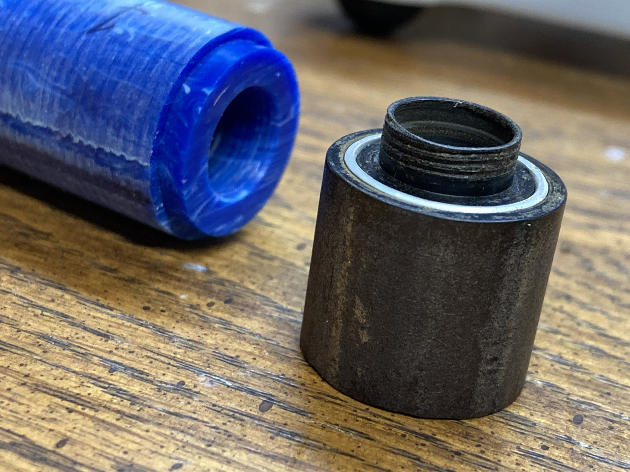

So you just put a containment groove in there and then turn down to the silver? Is the silver soft enough to turn down, if necessary?
TIA
Yes. I just created a groove big enough to put my jump ring into then threaded the pieces together and turned it down until I met the silver. You will have to turn off some of the silver, in order to get a nice clean line between the silver and the surrounding material.
