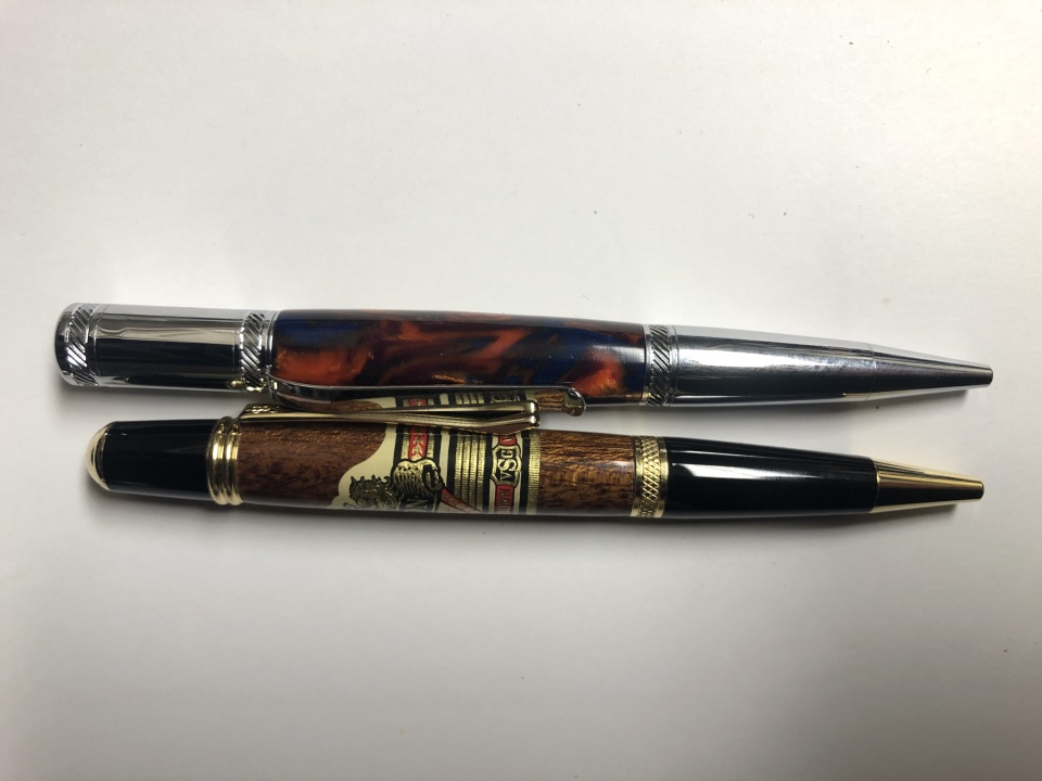

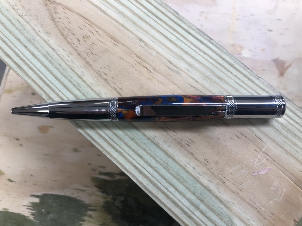

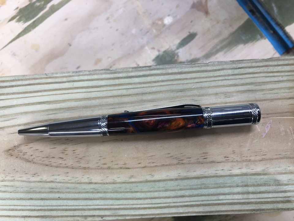

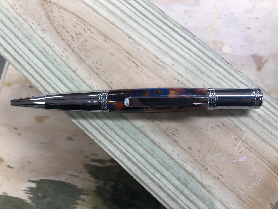

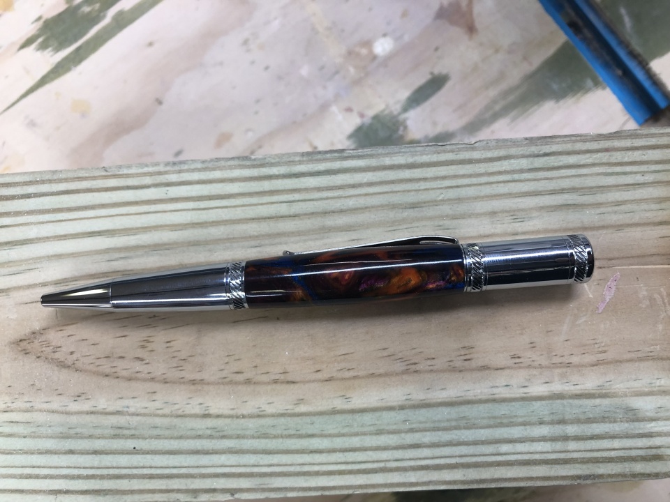

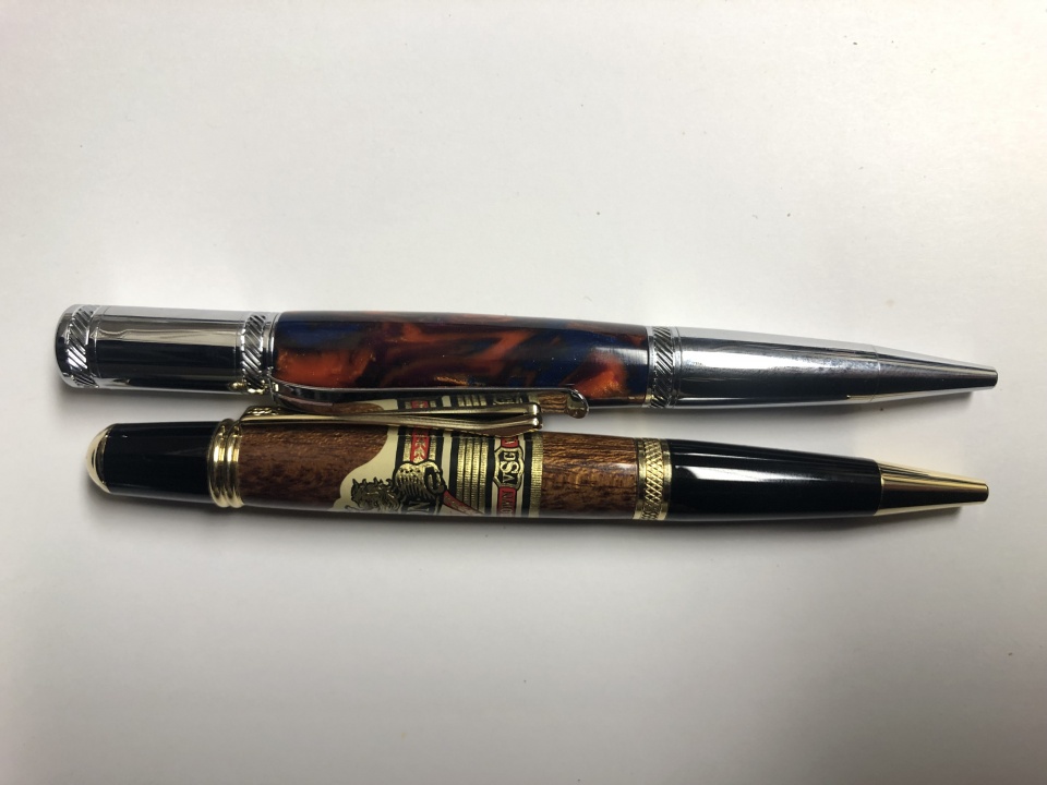

OK, the tube is shorter although the overall length of the pen is longer than a traditional Sierra by about 1/8". (The 3rd pic shows side by side) As I mentioned before, the tube is 13/32". Assembly is very simple and straight forward. The hardware quality seems very good. Plating is quality as well.
To me, this style fits my hand better than the regular Sierra. It feels meatier to me. My fingers always seem to slide on the other Sierra and I have to keep re-gripping. It's probably just in my head because they look to be the same size width. I'll measure the bushings next time I'm in the shop.

I see ... the tube IS shorter ... as your picture shows. Looks to be closer to 2" whereas the original is 2.21", if I recall correctly.
And dropping the drill size from 27/64" (0.422") to 13/32" (0.406") is a step in the right direction, but not a big enough step ... only 16 thou.
One of the shortcomings of the original design is the thinness of the finished blank where it meets the hardware. . The drill size change would increase the blank wall thickness, but by only 8 thou, and that is not going to make much of a difference. . I don't see any reason for them not dropping the drill size to 3/8" or even smaller, thereby giving more meat on the blank to accommodate easier casting of objects like watch parts.
I hope they did not also decrease the hardware diameter (where it meets the blank).
