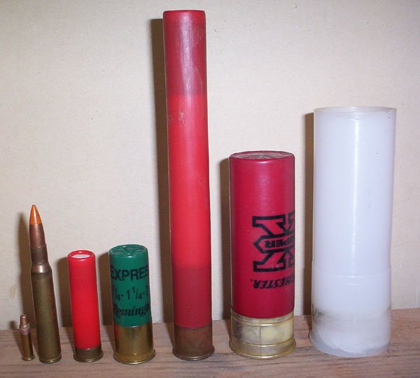

<br />Has anyone tried to make a pen using a shotgun shell? Have some interest by a skeet club. Possible or not?
I could easily see a smaller guage (20 gauge maybe). Not a 12 gauge as used for most skeet and trap. Actually, anything can be done with a little work and planning, but the result would not be within my idea of a comfortable pen for a 12 gauge.

Here's some possibilities. [:p][;)] With all the gun/ammo stuff I have, I don't have any .410 shells. But these might work. A couple are shown just for size comparison. Left to right:
.22lr; 30-06; 14mm; 12 ga.; 20 ga. speciality; a Winchester prototype whooper; and a police special round.
The 14mm shotgun shell is about .55" dia., a bit larger than a .410.

I thought about 410 shells before. One tough part would be closing the ends. Do they make a high brass 410?

You might be able to use a 28 gauge shell?? I think it would be about the size of the Emperor...for those that like big pens. And if you know the VP you could probably get some free hulls!!
And a piece of trivia for whatever it is worth.... The .410, while not identical, is similar in size to the 67 gauge. Doubt they are interchangeable; but can't say for sure??? Maybe Frank will know??

Randy, I don't know offhand, but I have a friend in England that is sure to know. I'll e-mail him and ask. BTW, some antique all-brass .410 shells might work. And/or big game rifle shells, like .416 Rigby, etc.

Got it, the 67 ga. and 410 are very close but not interchangable. Oh, well, being frozen in for two days it was something fun to talk about. But, I'm going to look for some used .410 shells and attempt something unique with them.
