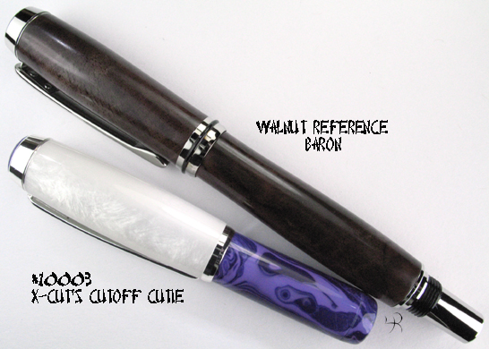

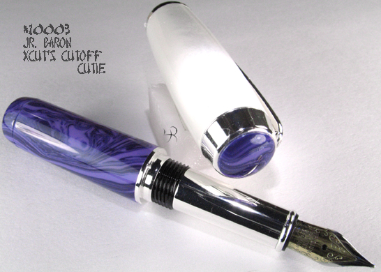

A fountain pen does not require the full length of the kit barrels. These were designed to accommodate the longer rollerball refill. A fountain pen requires only the space for the pump (in full position) or even shorter, the ink cartridge. Shorten the tubes of any kit to fit your needs.
For instance the "Cutoff Cutie" is a joke full function fountain pen made for a swap on another forum. The theme of the swap was "Not the pen you would chose to write your memoirs". The nib barrel is shortened to 1.25" and the clip barrel is only 1.75" long. Both pens are from the same kit, the walnut Baron is for reference only.

Cool, I actually like the cutie's look. I usually don't carry a pen in my pocket, as I have enough in there. But that might be compact enough...
I've had that idea befor, but it's nice to see it in action.
