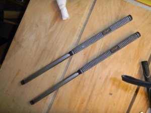

These are two turning tools I made for myself and a friend in our turning club. They are 5/8" x 18" hexagonal stock. I turned the shaft portion of the
The tools are very handy on wood and will remove wood almost too fast!

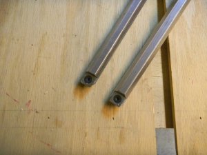

On acrylics I found them "grabby" and prone to create chip-out. I have more stock and more grips. I think a round one is in the future.
AND; YES those are golf grips used as handles. :biggrin::biggrin: FORE!
"I think that was a slice!" :biggrin:
(Insert your own Golf jokes here!)

As someone who makes and sells carbide tools (professionally), the ROUND carbide inserts will certainly be better matched with acrylic blanks. Less of an opportunity to 'catch' with a round as opposed to 'square' inserts. Very nice tool that you have created.:smile:
I suggest the R2 cutter on plastics. Works great for me - so well that I start sanding my homebrew PR blanks with 1000 grit. But, I never got the knack for roughing with the carbide cutter. I rough plastics with a skew using a planing cut, which helps prevent the chipping.
I have been using a roughing gouge to turn the bulk off my PR and turn to my rounded skew for detail. But at a club meeting this past Saturday, I had the opportunity to use one of your carbide tools. I stood the blade up at around 60 degrees and sliced the PR off into fine ribbons. It didn't grab for me and I could see where the corner would grab. I may look into getting one with the R2 insert.
I love the hex bar of my carbide tool. I regularly put it on its side and run it like a skew.
+1 I have the same tool as Hans and to be able to lay it at an angle like a skew with a SOLID base is absolutely a dream to use. I have the same cutter head on mine and use it one everything I turn. It takes a little getting used to for acrylics but I wouldn't change it for anything else.
