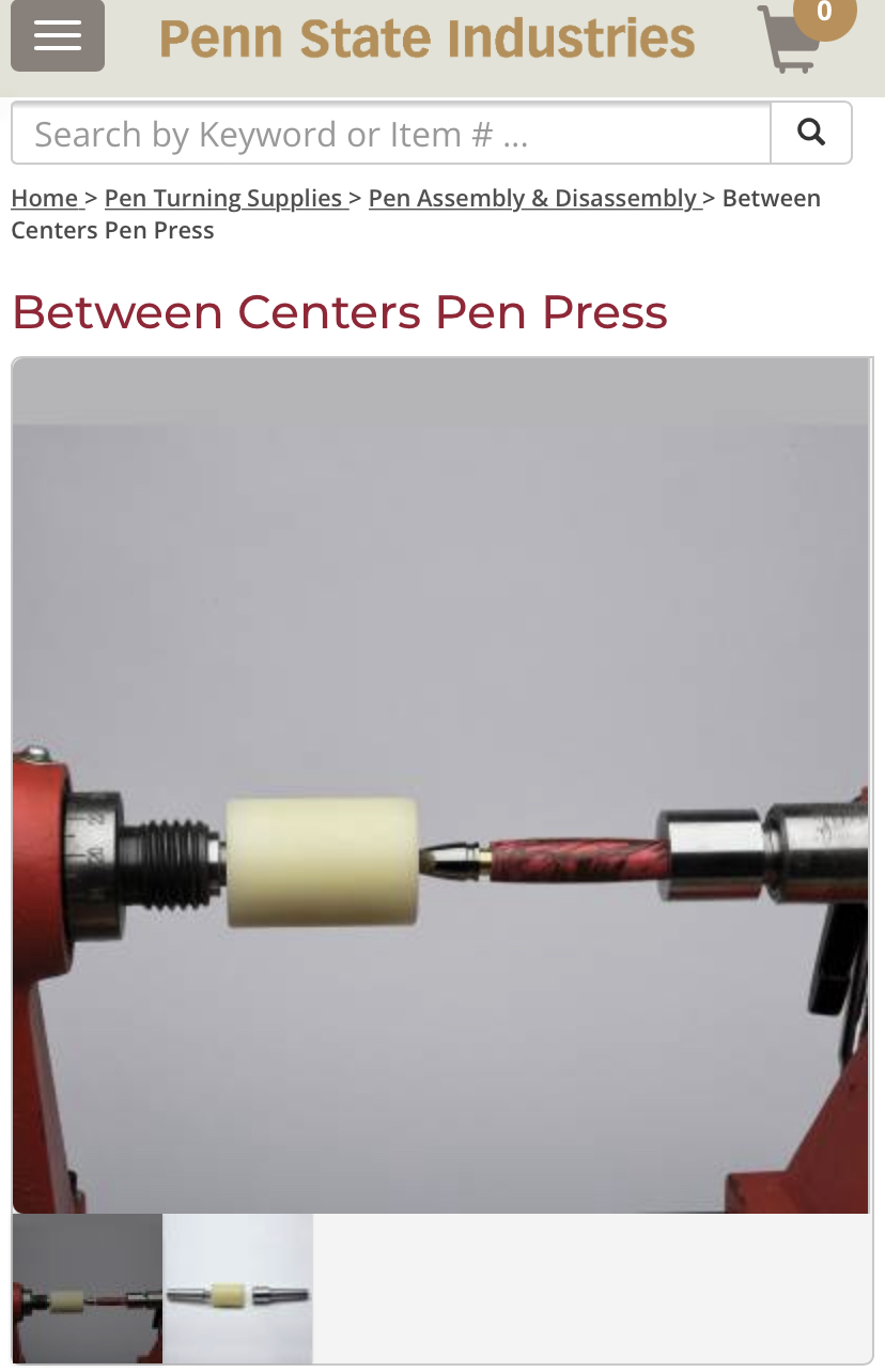

PSI PEN PRESS works great on the lathe.

I use a pen press for assembly partly because my bench vise needs some tlc and when I started out I didn't think about using my lathe. I do everything else on my lathe.
I find the best time to assemble a pen is after the lathe is put to bed for the day, and you can sit in the kitchen after a shower with a pen press and a beer.

I tried my drill press first (total failure, not recommended). I have used many different types of pen press. They all work fine and I recommend them for those who want a separate assembly tool, which I don't. Instead, I use small, simple plastic pen assembly adapters on my lathe. I store them under the lathe bed in a small basket with the spur drives and live centers, where they are always convenient. They work great:
https://www.woodcraft.com/products/lathe-pen-press-adapters-2-mt
(Hint: One of the two pieces has a hole that seems ideal for centering and pressing pen tips. The hole can leave dents in the pen tip if you press too hard, so I prefer to use the end without the hole to press in pen tips. It works perfectly.)
