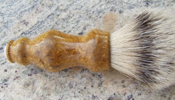

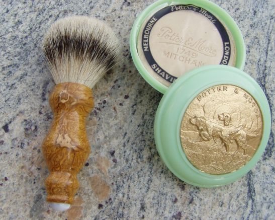

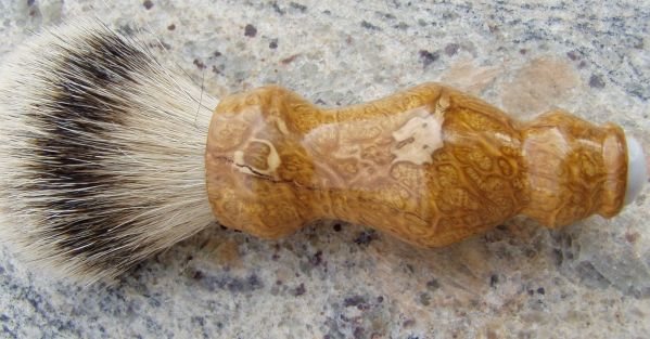

Got 2 lovely shaving brushes from Anthony last month and have to find a nice piece of wood to go with it, so I find some burl, guess what no name on it :( cut the piece require and turn it but have to stop 4 time to sharpen my tools, lots of silicate in it, any way nice of you to have a look, Thanks

Carl I cut the blank 2' square by 5" long a little bigger than a bottle stopper blank, easy to turn, like a bottle stopper actually I fill the cracks with CA and the finish is CA too because of the moisture in the bathroom, thanks for the comments
edit: Paul it's not a kit just contact Anthony for the shaving brush, this one is #24, hope this help

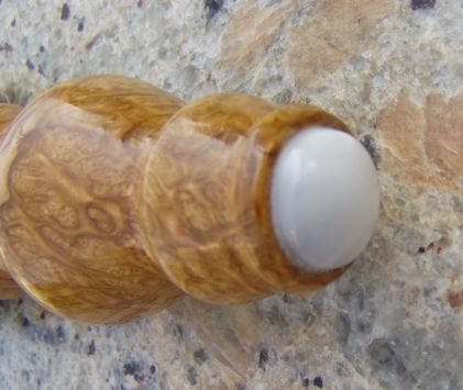

hey serge, looking good man. shaving brushes are a blast to do. neat shape and nice cabochon on the end. the ca is a good finish for the brushes, it's held up for me very well so far.
