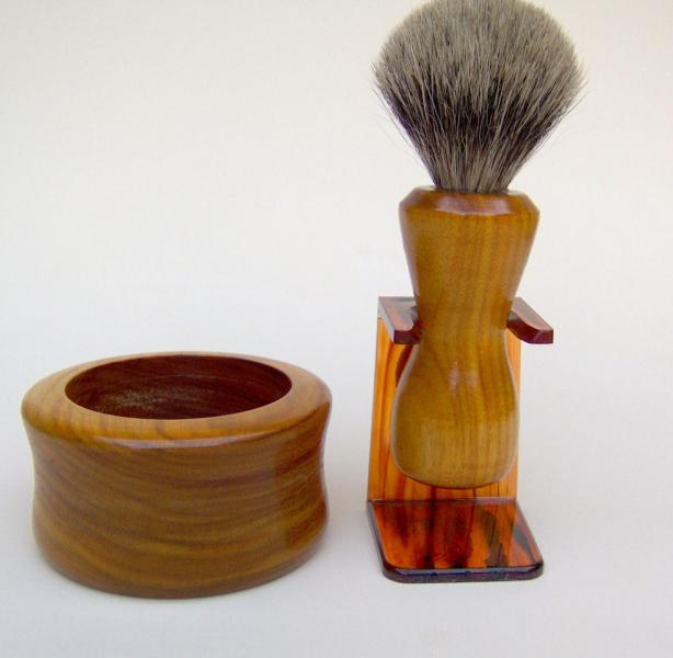

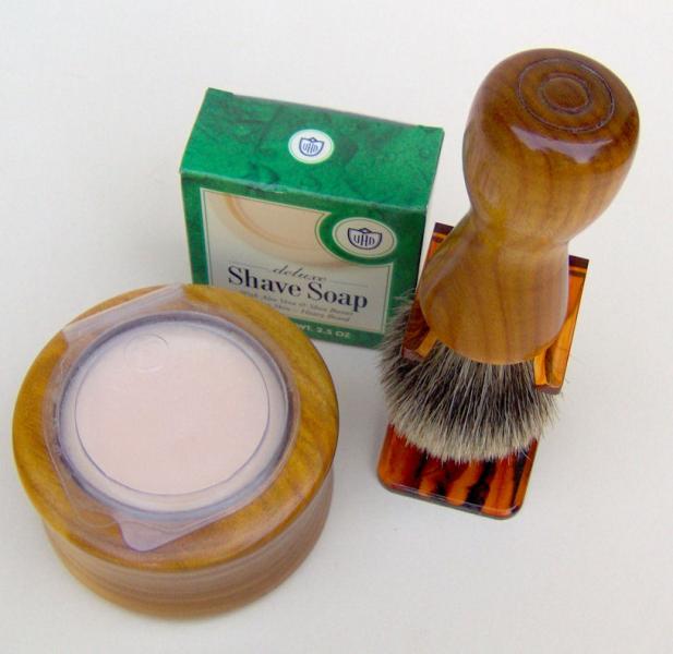

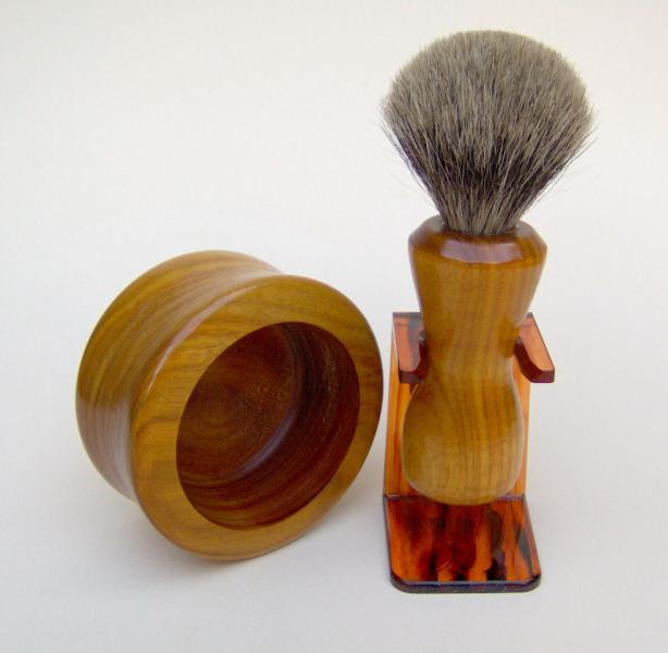

This is something i have been experimenting with for the last couple of years. I like the idea of a wood mug with a shaving set but i could not bring myself to throw a glob of wet soapy mess into the wood bowl and let it soak there for months on end. So i made a bowl to fit those plastic refill inserts which there are different brands on the market today. Plus you should use dense woods and there are only a few to choose from, using the refills frees up your choices of woods and styles of making the bowls. I have been using a Butternut bowl with these inserts and it is holding up great.
The pic is a set made from Canary Wood. Finish with C/A and BLO. inside of bowl i used Tung Oil. Brush is Badger

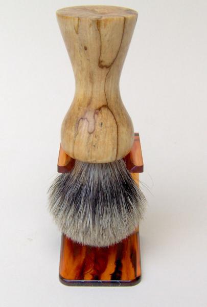

Thanks for your comments.. I am working on a set now that you would not think is good for a shaving set. Carl

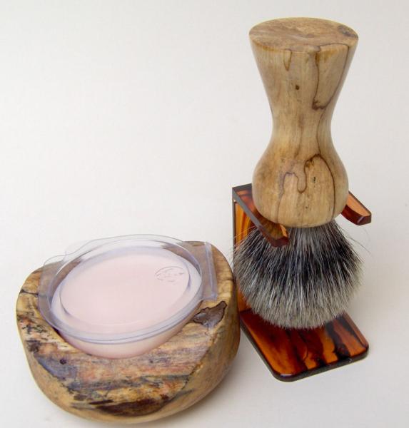

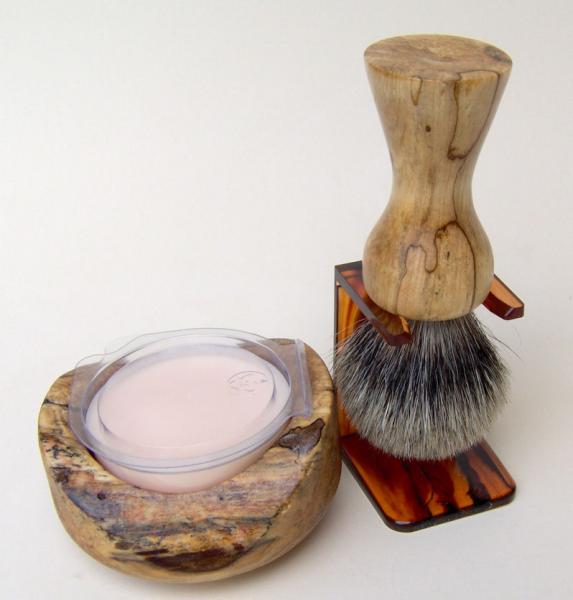

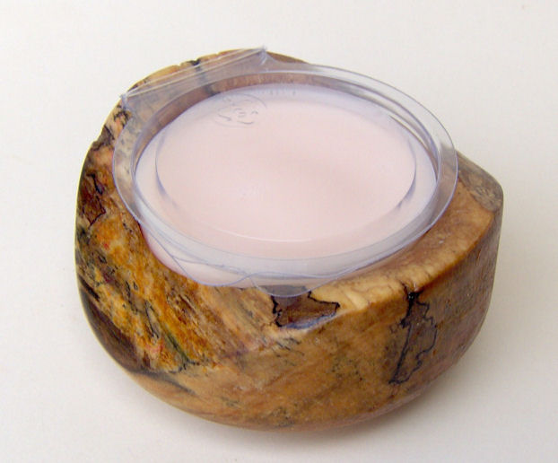

This is what a came up with so far, Spalted Maple or Yellow Birch or Beech, i don`t which it is, but that is what most of my trees are in the land i have in the mountains by my cabin. C/A BLO finish. I will use the bowl at home for awhile to see how it holds up. Carl

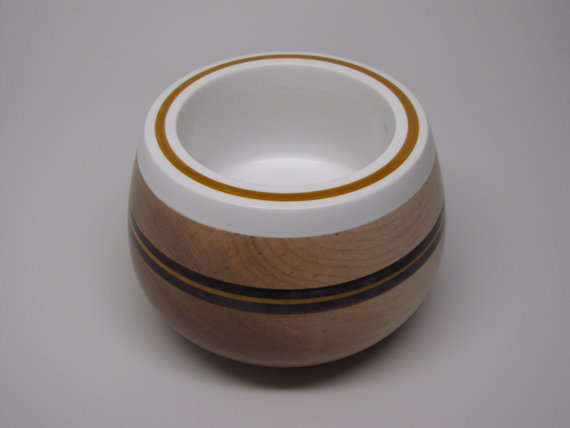

I did see something on Etsy and was wondering how he did it. The one like the photo below is the ticket. Carl
