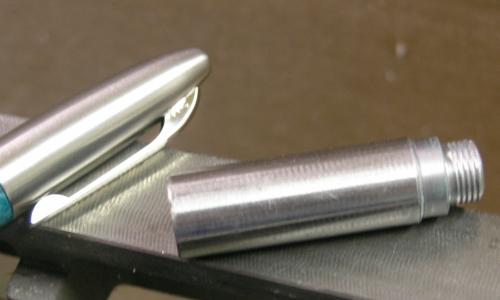

Thanks! This was my "test" pen, just to see how it would work out. I don't remember the size bits I used, but I epoxied the refill into the body. Then epoxied the little cap that came with the refill into the cap I turned.
I ordered an M11x1.0 and found that the refill wouldn't pass through it. Had intended on getting a M12x1, but got busy on other projects and forgot about it until I saw this thread.

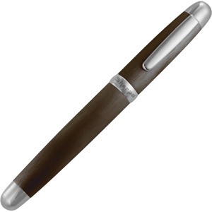

This looks much like the Sherpa
www.sherpapens.com
From their website:
The Sherpa™ is unique in its shape and design. Although there are many markers and disposable pens to choose from, there are specific styles that fit the Sherpa™ perfectly. You can personalize your Sherpa™ with any color of these markers that fits your style:
:: Sharpie® Fine Point Permanent Marker*
:: uni-ball® Vision™
:: uni-ball® Vision Elite™
:: uni-ball® Deluxe
:: Papermate Liquid Espresso®*
:: Pilot® P-700
:: Pilot® P-500
:: Pilot® V-Ball Grip
:: Pilot® V Razor®
Demo of how they go together.
