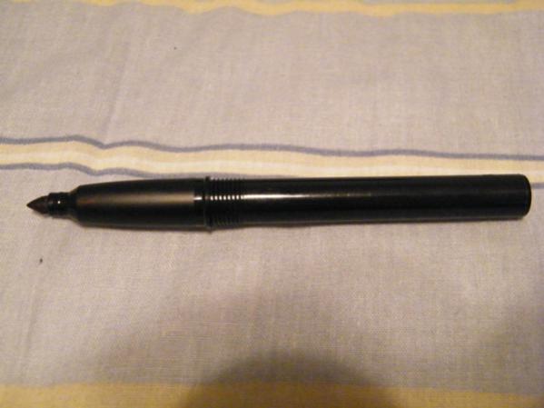

They can be found at Office Depot, etc. I use sharpies everyday, and when I heard about this, I ran out and got one. Gotta say, the SS sharpie is kinda cool. Pics aren't the greatest, but you get the idea.

Interesting. So it's an actual sharpie marker. Cool. Is the cap friction fit onto it?
Yes. While the stainless steel holder is cool (think "Back to the Future"), I would like to make my own holders for the refills. Time to learn how to make closed end pens.
