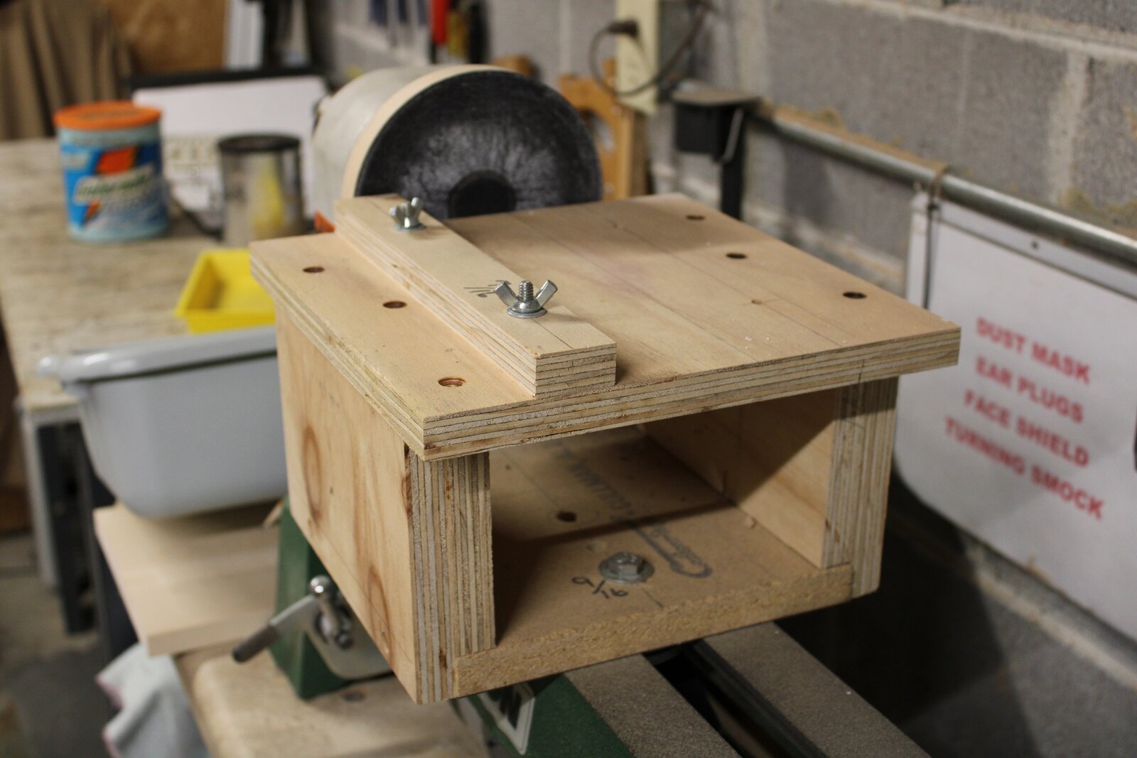

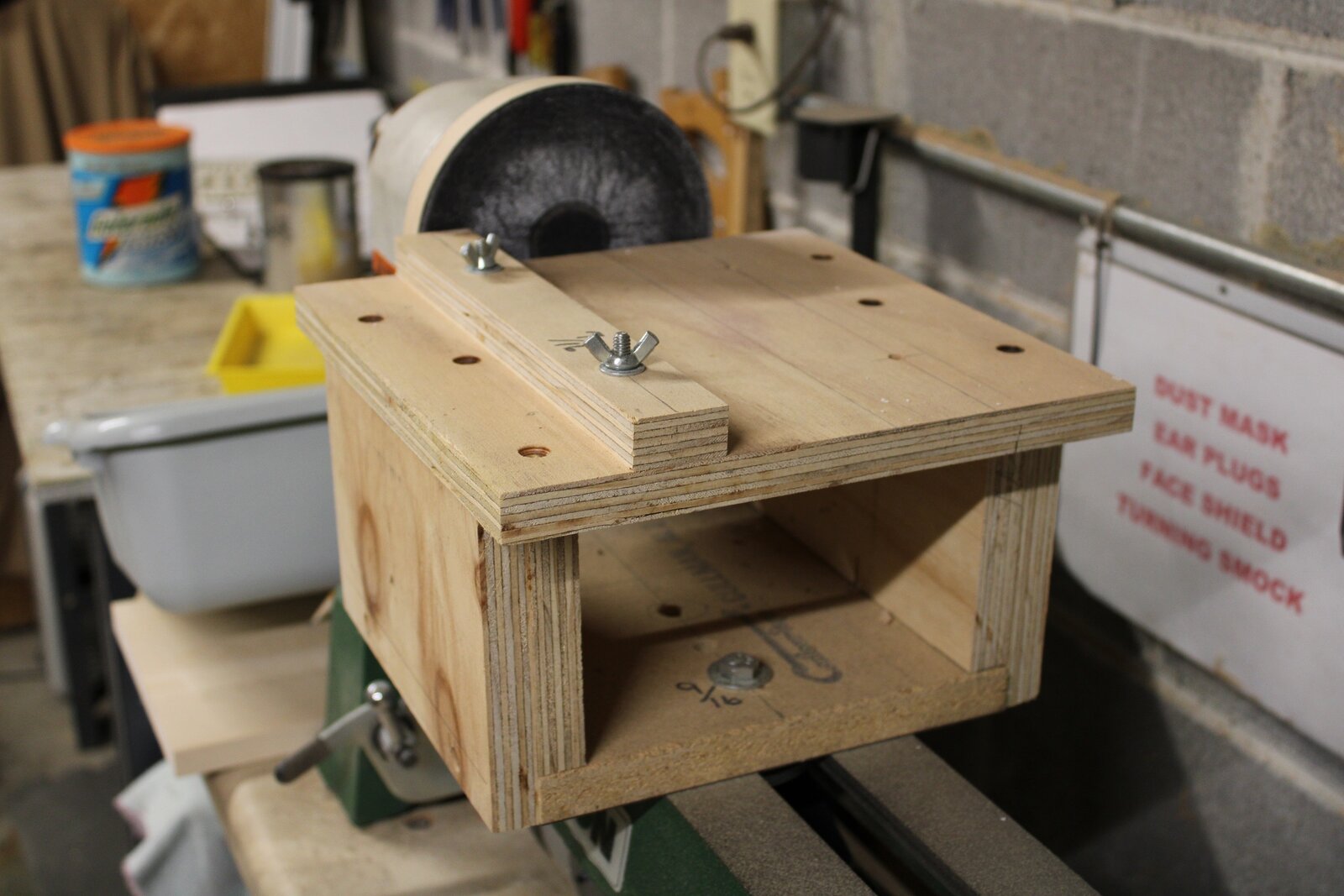

I have a Rikon system that stores on a shelf under the lathe. However, I will sharpen before turning and later, as I turn, hit the edge with the three DMT diamond files. Also, have a photo of s system I made.
