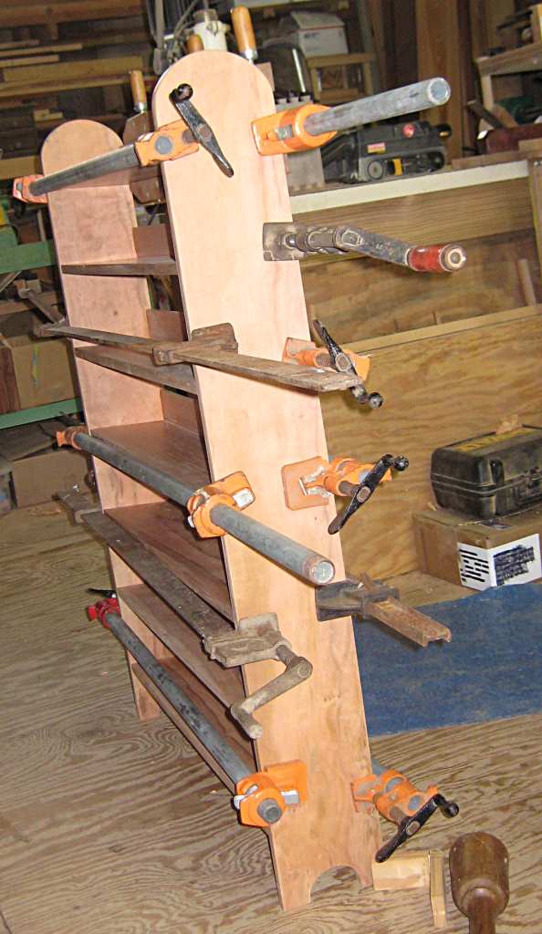

The never ending journey has reached a conclusion.
Saturday, after a little tweaking, I put this thing into restraints (clamps!) :D
Definitely not an easy glue-up:
The grain is really interesting. Some is spalted, some mineral streaked, some curly.
This morning, I put a few coats of freshly made dewaxed shellac on followed by a coat of BLO:
The white-ish flash near the bottom is an area that's spalted.
Guess I've been away from flatwork too long. I'm not 100% pleased with my work;
it's got a few small gaps I'm going to have to fill. Overall though, it'll do.

We are our own harshest critics :) I think it turned out great Gary. I was curious about applying the shellac before the BLO. Do you lose much of the effect of the BLO because of the shellac sealing the wood? Are you going to apply any other finish over the BLO?
One last question, will the black cherry darken as it ages?

I used Shellac to seal the grain so it didn't take on a splotchy effect. The BLO still pops the grain although not quite as much. The cherry will get deep red over time; some is already pretty deep.
If you look closely, you can see a roughly 1/8" gap on the left of the second shelf.
There are two others like that on the right hand side. I've figured out how I got so far off and will use a different production process on the next one. In this instance, I think my self-criticism is justified.
