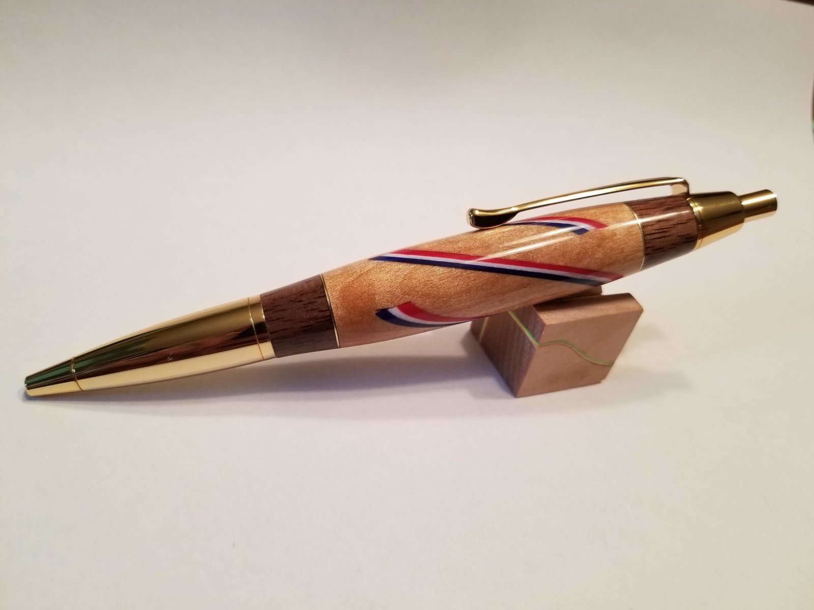

I have been having fun experimenting with cardstock for segmenting. Each stripe is 9 layers 3 of each color then flooded with thin CA to polymerize the paper.
I really like the way that the colors pop more than a veneer and the color choices are endless. Comments welcome, thanks for looking.

Is that a Devin pen kit ?
Thank you, yes it is the Devin kit. I bought the 4 pack and it's a really decent kit for a classic styled clicker.
Do you mind describing this in more detail? When I have used card stock, 2 of three times the barrel failed and split right down the center of the card stock. Both sides of the card stock were adhered to the wood after the break.
Also when I sandwiched two pieces of cardstock against each other, the end result looked like two layers, and not the uniform thick layer that your pen exhibits.
Advice much appreciated because I'd love to be able to incorporate the packed in color
For this particular blank I cut a groove the kerf of the blade on my table saw about 1/3 of the way through the blank. I then placed strips of cardstock in the pattern I wanted in the groove (the strips were about 1/4" wide), in this case 9 pieces fit nicely not too tight not loose. Then literally flooded it with thin CA to make sure that the paper was good and saturated. Be careful and use good ventilation you'll get smoke and fumes while it polymerizes. Once dry trim off the excess paper and repeat with the other sides.
The key with cardstock is to get the paper saturated with the glue be it epoxy or ca, I did not have good luck with wood glue and had blanks break apart as you state.
