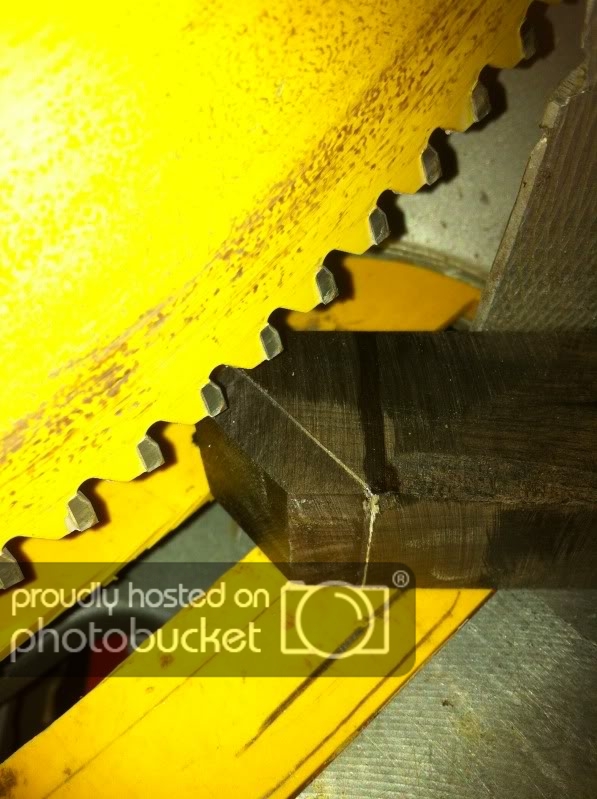

So Steve is absolutely right all you need to do to get the scallops my way is to turn the blank 90 degrees and make exactly the same cut again, add aluminum and reglue and you are done. When you make this second cut you actually cut away some of the old scallop. When you glue the piece back on you glue it minus the kerf of the saw. This is why you see the break. You can tell if you have done a good job by where the break occurs. It takes time to figure that out. There are other things to look for also but this should get you all started. Post your pictures here in this thread if you like and lets see how you are doing at it.

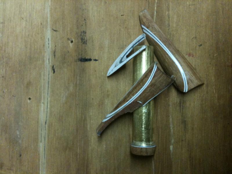

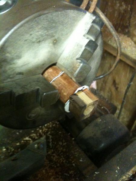

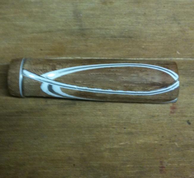

I tried a little metal/plastic segmenting and it almost worked!
First thing I ran into was a blow out on the end. That was small so I cut it off and added the small ring with the straight band on the end.
Everything was looking good, until I tried to use a dull tool to trim the other end :at-wits-end:
Ouch! I couldn't even find all the pieces. But with the ring intact I decided to add some new scallop pieces.
I have some Brazillian Cherry, Walnut and Pecan in this. The 1st two multi wood blocks exploded when I tried to drill them on the drill press. I glued this one to the end of a drilled piece and drilled it on the lathe.

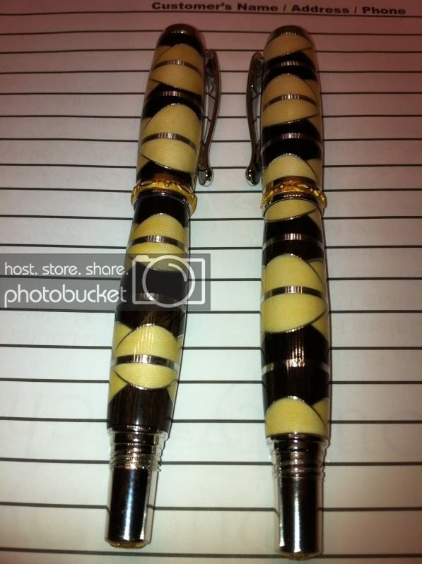

So Mike, what's your trick to such a precise bend on the aluminum. Your gap between the wood and aluminum is non existent. Do you bend then hammer? How about the 2 recent pens with 70 degree angle?

Actually there is somewhat of a trick to it. I sand with 80 grit and really scuff both sides in both directions. I think this may relax the aluminum a bit. Then I bend it right over the piece of wood that I am using it on. After it is bent I take it off and bend it further and get a nice sharp bend then readjust it to fit exactly the angle of the wood.
Feb 24, 2012
4,368
Claremont NH
Another good reason to use the coarse sandpaper is the grooves that are created while sanding really increase the surface area that the glue has to adhere the aluminum to the wood. I am not sure how much it increases it but it makes sense to me that it does?
So, correct me if I'm wrong, but it seems to me that the break is caused by the thickness of the saw blade. If your saw blade was *exactly* the width of the aluminum, the break would be non-existent.

Yes the break is the thickness of the kerf of the blade, but the thickness of the aluminum has nothing to do with it. When you make the second cut you are cutting away part of the first scallop. Then gluing it back in minus the part you cut out because of the thickness of the blade. I know it is hard to see and visualize like I said in an earlier post it too firewhatfire to help me actually see it.
Feb 24, 2012
4,368
Claremont NH
It may fill back some of the loss but the first scallop has been cut and then glued back in. You can't get that part back it is gone to sawdust. There are so many things going on it is hard to see. I tried moving my cuts and everything to maybe split the difference but nothing I did made any difference at all. That part of the blank is just gone. It isn't a flaw it is just the process by which I make them. Yours will do exactly the same thing. You are so close to doing this it isn't funny. Your post of your new pen is really good. I love the contrast in woods that you chose. All you need to do is turn that blank 90 degrees and make the second cut and you will have scallops. Try it on a new piece and only do a single scallop, leave the blank long so you can trim it. Use that as the cap and you have it.

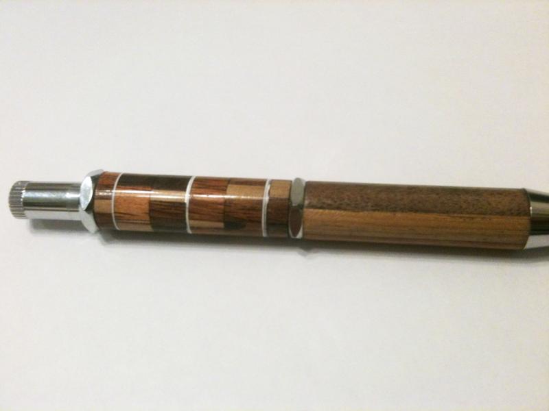

New kinda of segment for me.
I built a workshop sketch pencil to be used at my place of work. I used a different segmenting style on this one. For the top section I cut Brazillian Cherry, Walnut and Pecan into 1/4" x 1/4" x 7" long pieces that I glued together to make up a cane style blank that was 1" x 1" x 7". I then cut that up into 1/4" long pieces and glued them up with a bit of a twist and some plastic and aluminum thrown in to make it unique.
All in all it worked well. I turned the blank round between centers and then chucked it up to bore the 11mm hole on the lathe. The last segment busted out as I was drilling. The good news is it was longer then I needed so I was able to cut it down after the brass tube was glued in. I coated the whole thing with some thin CA to help before I completed turning it down.
The bottom was the same wood, but I glued three pieces together to make the blank. I used Gorrilla Glue for this and one of the pieces was thrown at me when I 1st started to turn it round. I was able to save it by re-gluing with thick CA. I also drenched this blank with thin CA after the hole was drilled and the tube installed.
