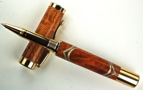

Wow, Mike, that is beautiful. I will definitely be trying some of your methods.

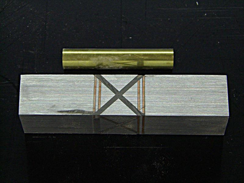

On drilling... Until recently, I have had a lot of problems with blowing out the bottom, stuff like that. A couple of weeks ago, I told myself I had to slow down and quit ruining these expensive blanks! I also have done a few other things, and suddenly my drilling seems to be near perfect.
First, I made a simple little jig for holding the blank in the vise. It is just two pieces of MDF with a V-groove cut down the middle of each to a depth of 1/2". When you hold a 3/4" blank between the two boards in the grooves, that leaves a small gap so when you tighten up the vise on the boards it still clamps the blank, but almost all of the four sides of the blank are enclosed and supported by the walls of the grooves. I also sized and marked the boards such that one side lines up with the side of my vise, so the blank is consistently positioned in the vise, and that helps with keeping it centered up.
Secondly, i started "peck" drilling, which is where you just barely peck at the wood, let it drill just a bit, maybe 1/8" or so, then pull out, then peck again... Slowly.
Thirdly I invested in a carbide tipped brad point bit. These are danged expensive, but I lucked out and found a place that wasn't tooooo bad.
Anyway, suddenly I am no longer blowing out blanks, and my exit holes look great, and my centering has improved too. Maybe some of this will help you or somebody else.
I have done step drilling in the past, and it works too, but I have to say I find it a PITA to keep changing bits. A few times I would line up several blanks and go through the steps together, and that obviously helps.
Anyway, thanks tons for your tutorials, and I have to tell you I am going to be stealing that pattern and the wood types shamelessly!

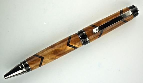

I am posting a photo of what I made yesterday. When I experiment on projects like this it's all about learning so I usually use my domestic (free) wood. This time I used oak and a square of Rosewood for color. Didn't actually assemble a pen yet, keeping my options open.

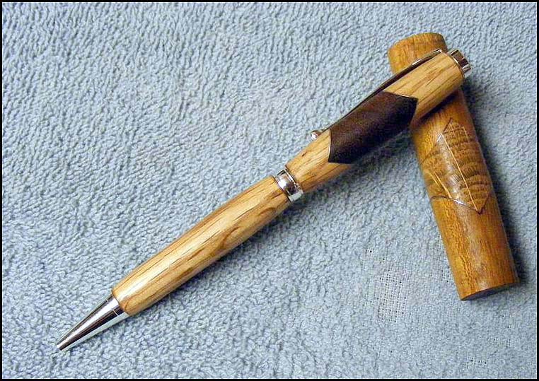

Hey that came out just fine you should put that onto a piece of brass tube and make something out of it. The celtic knot is great. I have never made one of those. I just glued my tubes in my latest and will post it here when it if finished.

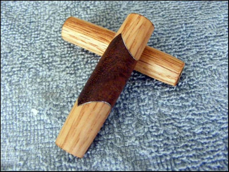

OK here is another variation. In this one I tried to turn the angle around over the top of the other angle. I wish it had come out with just a little more separation I will try to do better next time. I also sandwiched the aluminum between 2 pieces of light wood. In hindsight I wish I had used dark wood? Oh well live and learn.

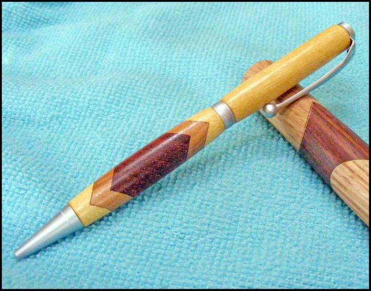

Well Mike you have really challenged my skills as a wood turner. Yesterday afternoon I cut, glued (with 30 minute epoxy), rough turned, and drilled.my blanks. Today I finished one of them up. I know it's Slimline but that's what I have on hand. I used Nigerian Satinwood, Jatoba, and Padauk. This is fun!
Dale

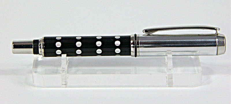

Well Mike from my experience you will have no problems with aluminum. Now I am no metallurgist. What makes aluminum dull and pitted is moisture and you do not have that with a pen unless you leave it outdoors. Every time you use the pen you are actually polishing it. I did an all aluminum pen that I use as my everyday desk pen about 3 maybe 4 years ago. Time flys. It still looks the same as the day I made it. Maybe a scratch or two and a new refill but no discoloration.
Once again I will show these 2 pens. One which is the Panache is acrylic and aluminum and I still have this one in my collection and there is no top coat and it too is just fine and that was done almost 1 year ago. as well as the Baron with the dots. Now that was done with ebony and aluminum and has 8 coats of med ca on it. The cap is all aluminum and no top coat. Now unfortunately that pen sold before I got it off the lathe so I have not seen it since then but I suspect no problems or else I would have heard about it believe me.
Now if using brass that is a whole other ballgame. Brass will turn dark over time if untreated. Now the only experience I have right now with brass is my bullet pens but with them I powdercoat them to keep them from tarnishing. I have a few pen ideas where I will be using some brass in the future and will see how that goes. I do have a blank sitting in my shop that I am too scared to turn:eek: that is aluminum with an aluminum and brass celtic knot in it.
Now to your finish. I am guessing it is some sort of oil based poly. If that is the case that will yellow over time. You won't be able to see it on the darker woods. You notice it on light colored woods.
As far as CA as the glue source. You know my position on that. I do not like it but have on occassion used it on segmentation when I needed something glued in a hurry. But will always glue the tubes in with epoxy. CA becomes brittle over time as it cures and any drop of the pen could be a disaster. Now will epoxy stand up better I am not sure and do not want to find out.:smile: I let you experiment on that one.

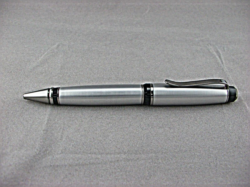

Wow!! I don't even wanna think about turning that. You gotta post a pic of that one!
come on John T. you can't tease us and not show the pic. No pic no blank!:biggrin:
I did not mean to tease anyone. In fact I did not think anyone read what I wrote. But here is the blank I made up about a year ago. I had planned on using it on either a cigar or a sierra but was thinking of doing a bit more in the way of segmenting and now that I made my jig I just might do that. I had no idea back then I would be making a jig for segmenting pens. Still not sure what design on want and boy drilling and turning this will be a pucker factor of 1000. But like good old Eagle used to say "it is just a blank. We can make more. "
