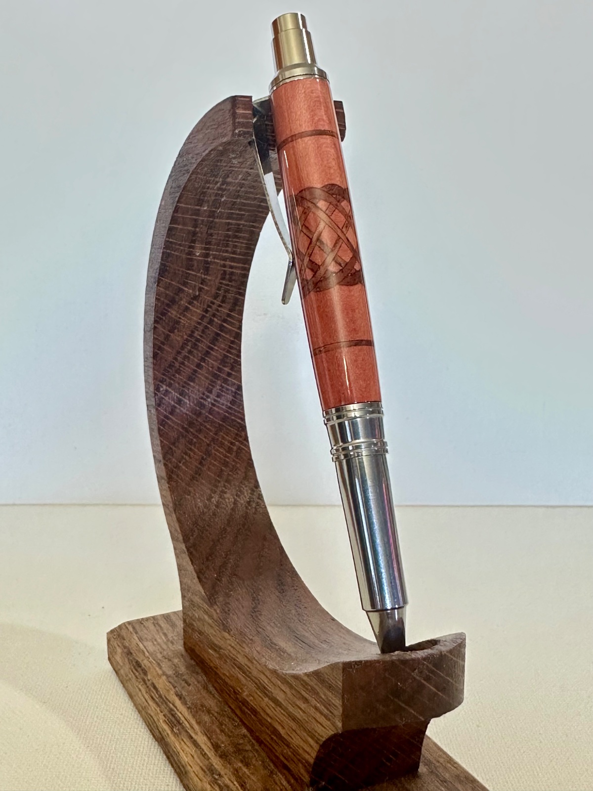

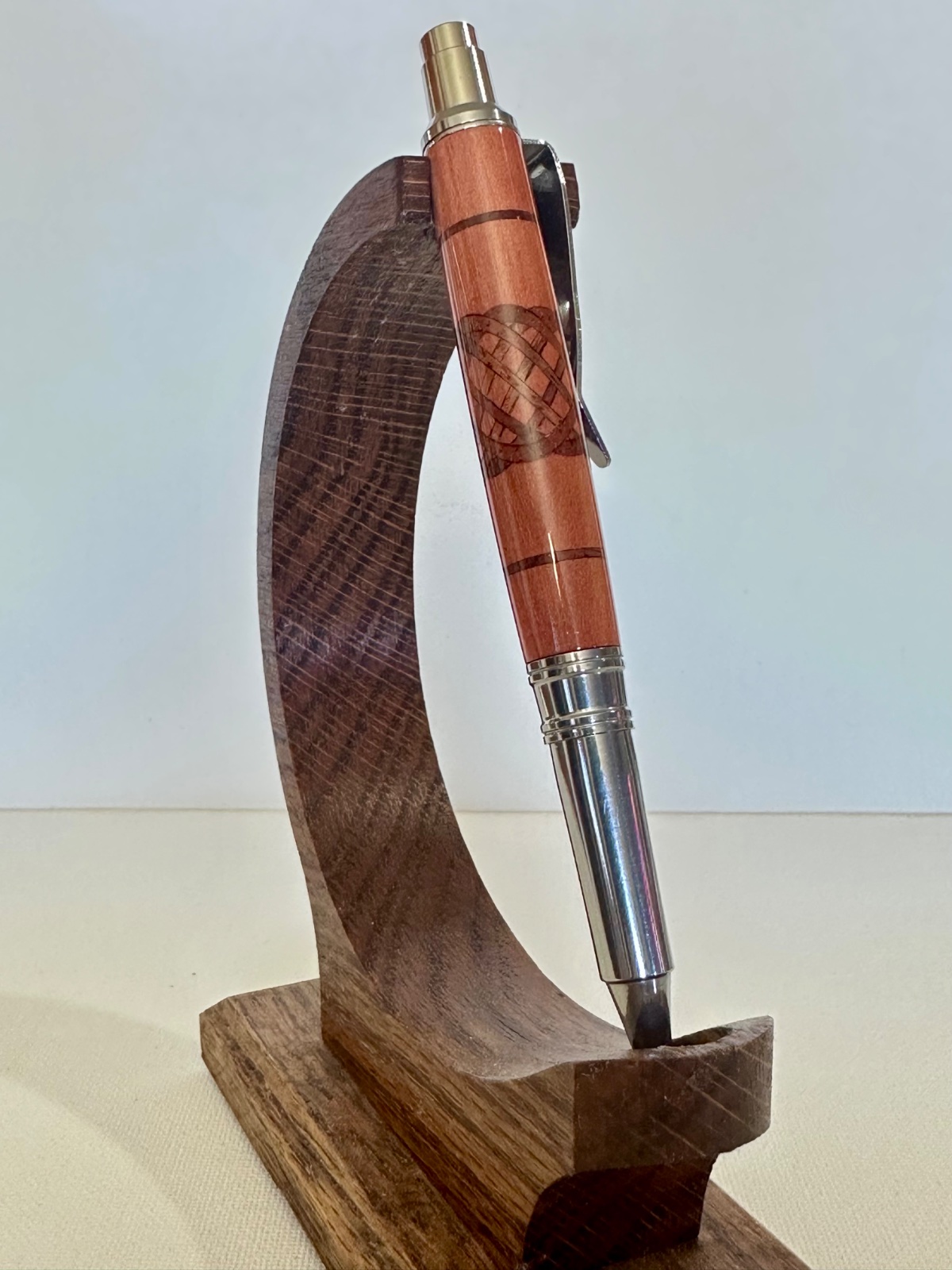

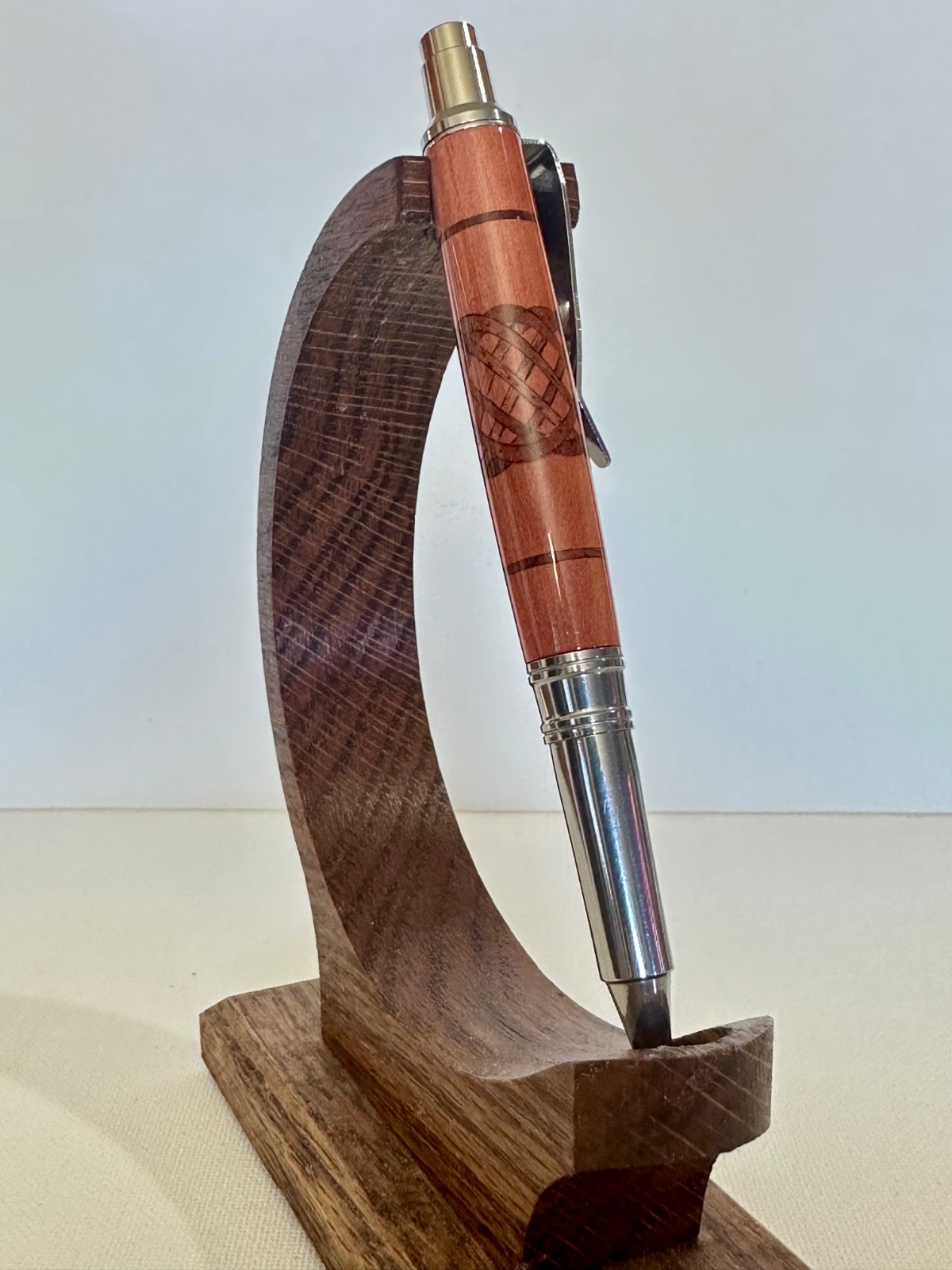

I use my bandsaw quite regularly for creating segmented blanks. The blade I typically use is a 3/16, 10tpi. You need to cut slowly for smoother cuts. Goes without saying the saw needs to be tuned and the blade properly tensioned. Bandsaws are great for segmenting and in fact on some designs they are the only saw that would work. One I can think of is an 8
sided Celtic knot. You could cut it on a table saw but you'll just end up with an unrecognizable blob. Here's one I recently finished, all bandsaw work.
