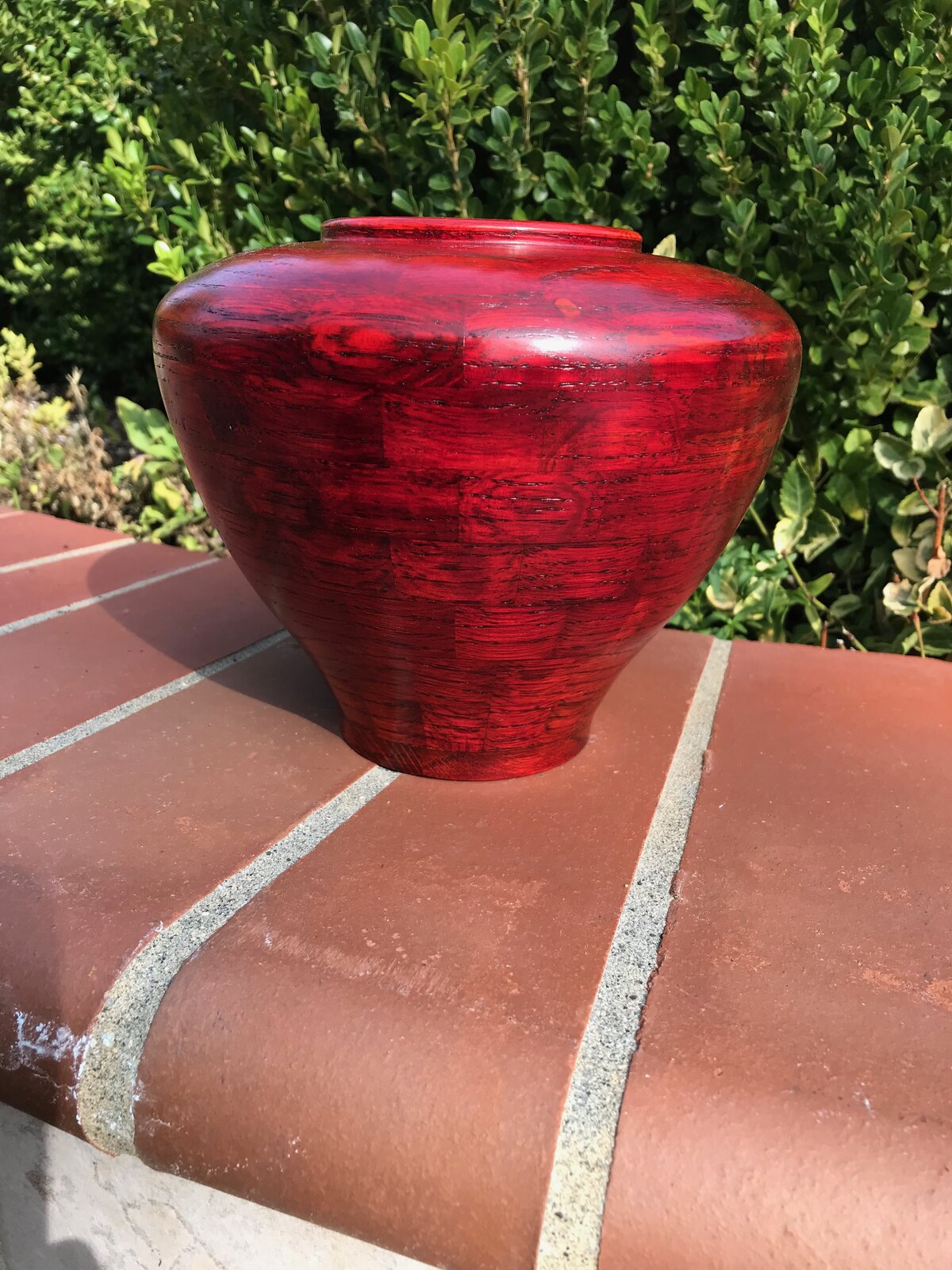

Started learning how the wood dye process work on different woods .

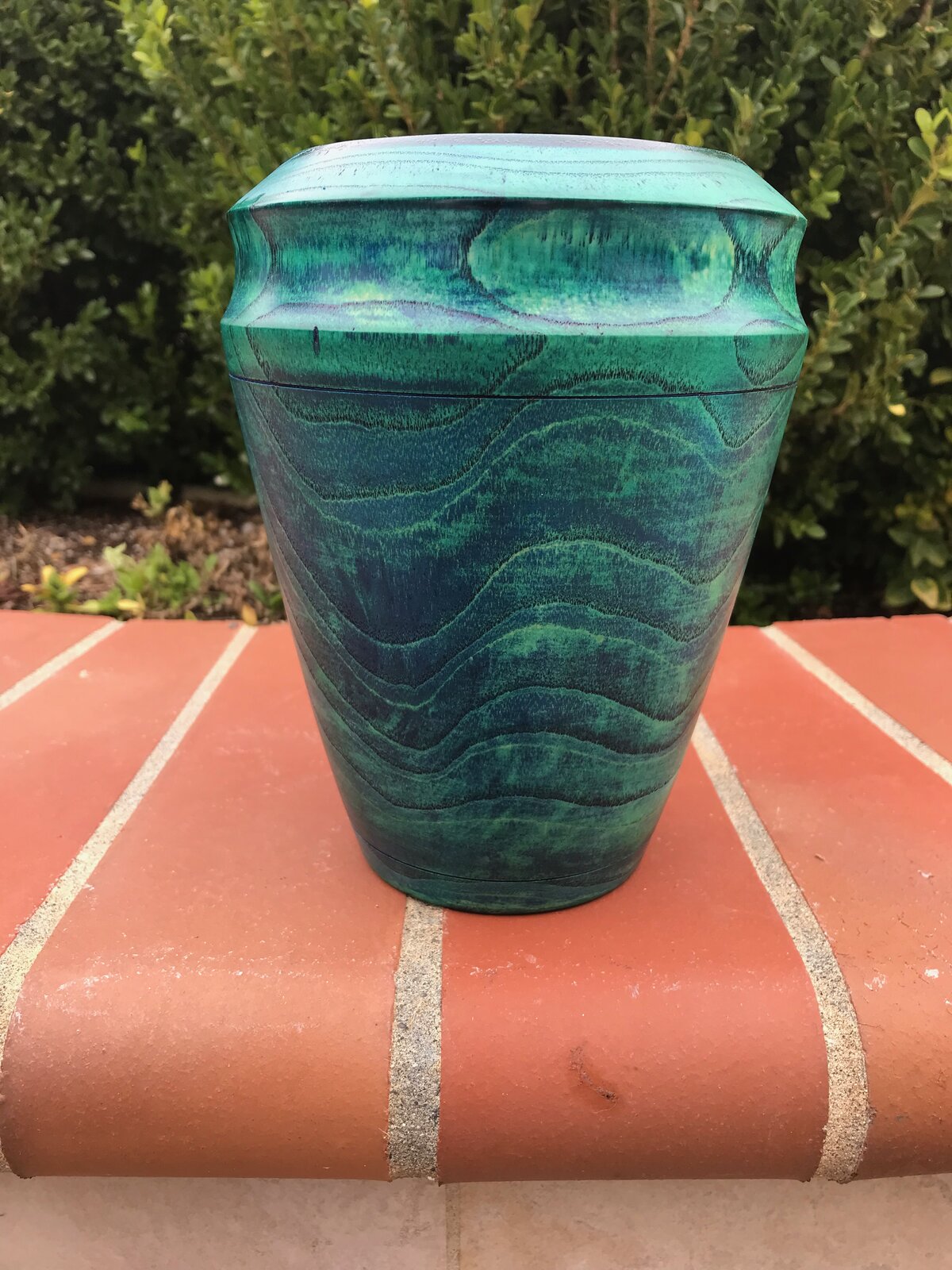

Firstt red one , Red Oak segmented and Green one Liquid Amber timbers.. Red one was just using Red dye first ,sanding off and then applying final Red dye. With the green one started with Blue dye, sanded off and used green resulting a Jade tone. Both were finished with a clear coat. The process for me was a very interesting project and will do more in the future. Hope to use some dye process in pen making.

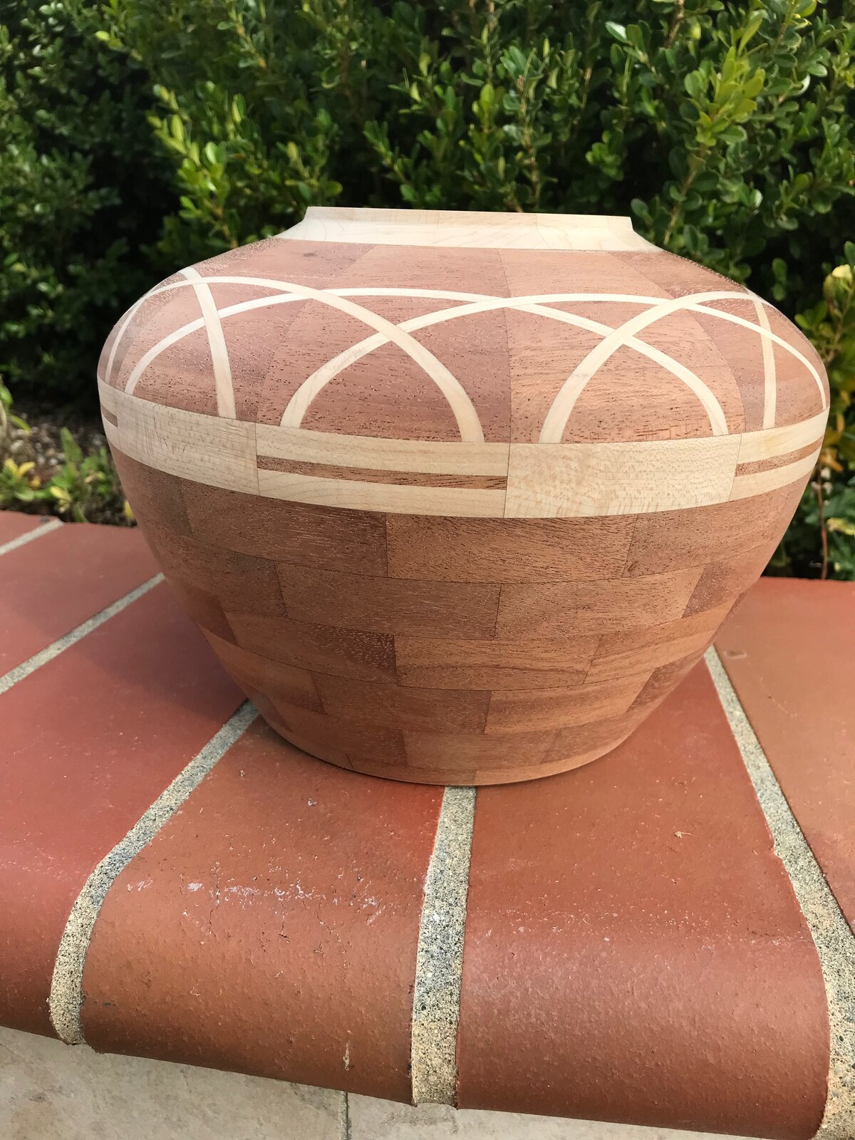

Segmented bowl is Mahogany with Maple nfill with will have a clear coat finish.

Nice. The mahogany and maple seems to present, in the photo at least, an optical illusion of looking not-round if you look at the segments but round if you look at the edges. Does anyone else notice this? I wonder if it will be the same after finishing.
These are all beautiful. The design on the last one is especially nice, but the natural wave in the grain of the second one is amazing. I love how you really made it stand out with the dye process.
