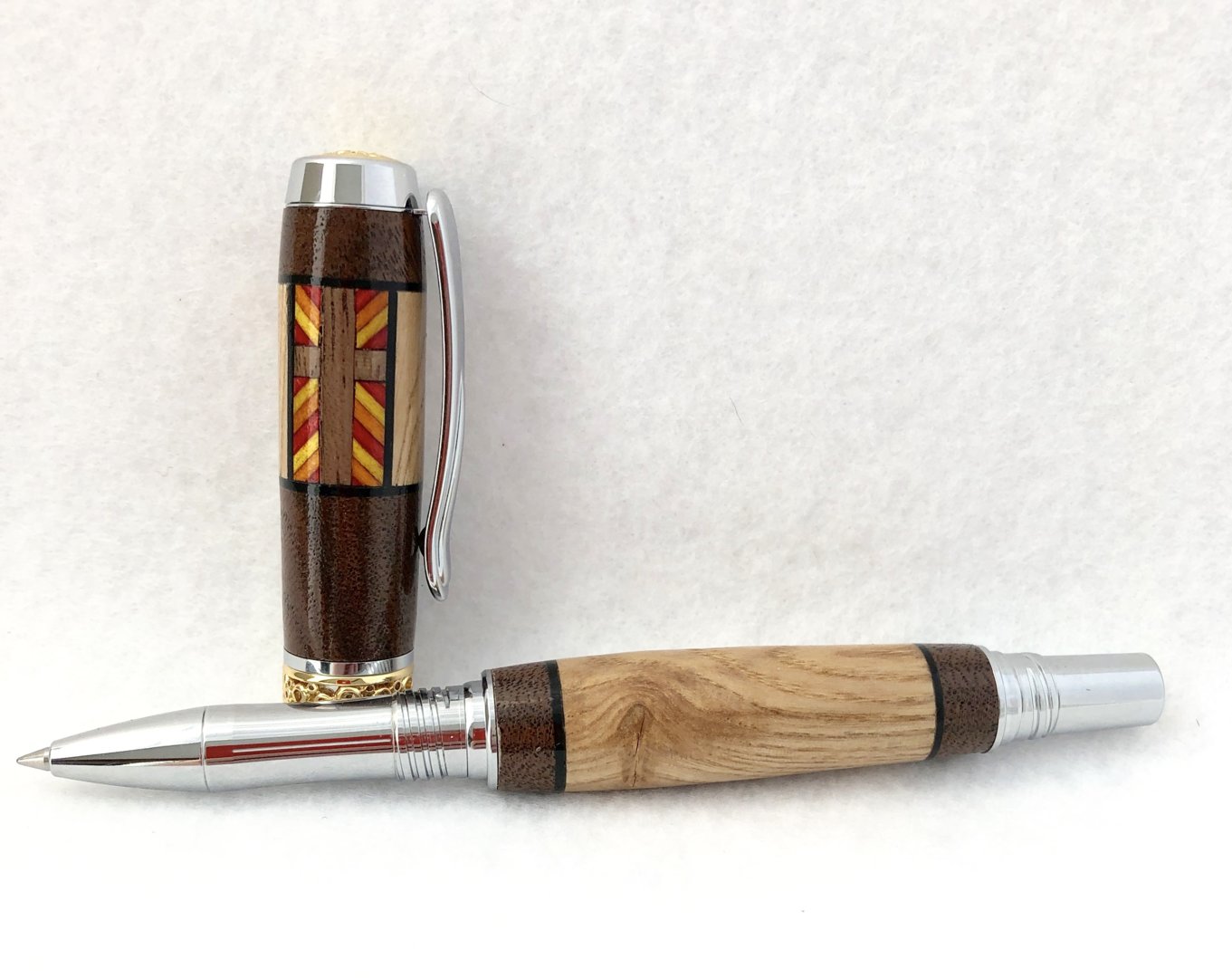

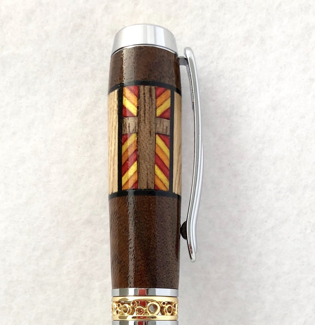

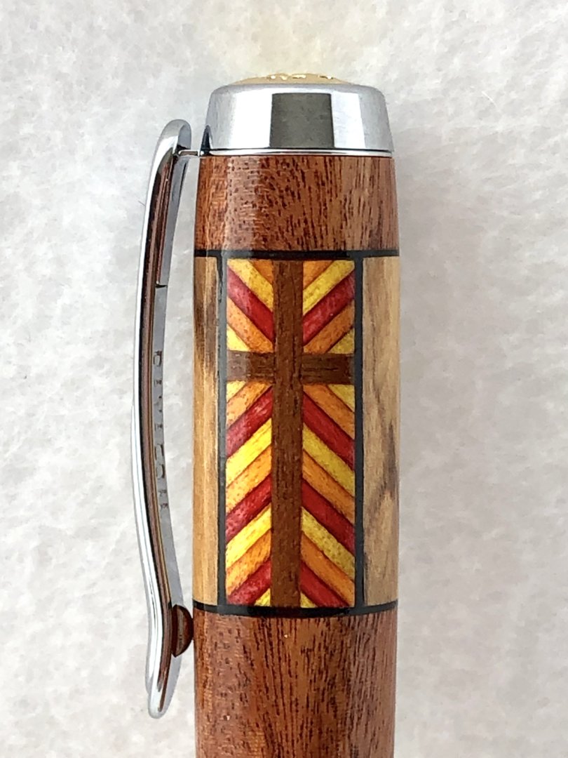

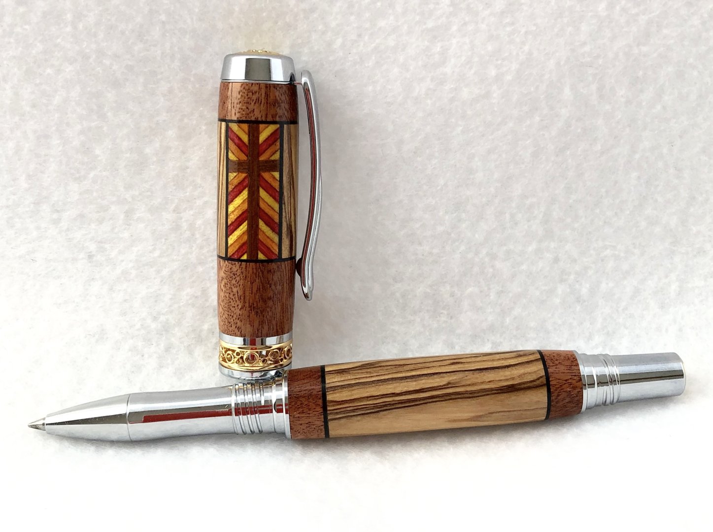

This is a comparison of the two pens I made resulting from a PITH exchange with SteveJ, as well as the pen SteveJ made for me.
The first pen is Steve's work, the second is what I sent to him, and the third was the pen I kept - I tweaked a few features for his pen.

That is some crazy good segmenting! Excellent job by both of you. The cross pen almost looks like a stained glass window you'd seen in a church or cathedral, kind of like a cross with rays of light radiating from it. Simply beautiful!

Hi Jay. These resulted from a 1:1 PITH between SteveJ and I. We both dabble in segmenting, work in spurts (weeks off due to "Life), and appreciate seeing other folks efforts because we realize the challenges.

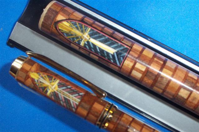

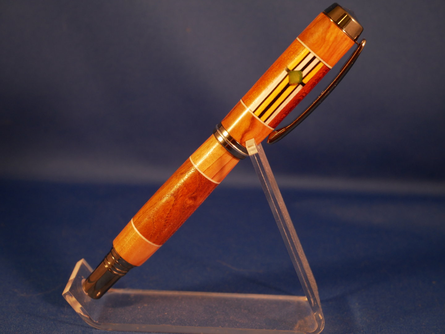

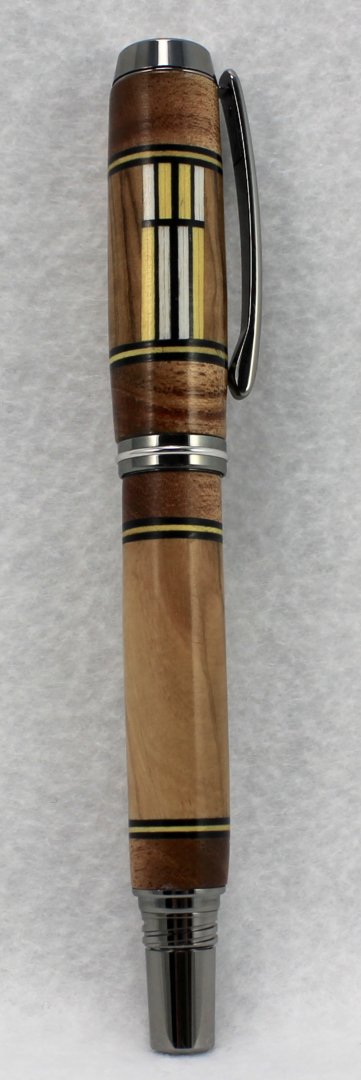

To shorten the story, you may not be aware, a very talented blank maker/pen turner (IAP signature name Eagle) who has passed away constructed a pen design and called it "Pentarsia." SteveJ suggested this as a beginning concept for our PITH and these are our humble efforts.
If the new site allows me to access the original photo, I will post a link. I do believe I have a copy of one of his pens turned by DCBluesman - I'll attach it if I can.
Basically, your description is spot on for all the designs: A cross, stained glass, rays of light.
I've mentioned it before and will emphasize - This is a very reasonable segmenting design for folks to do - not many pieces, very doable! And if the alignment is correct, a nice final appearance.

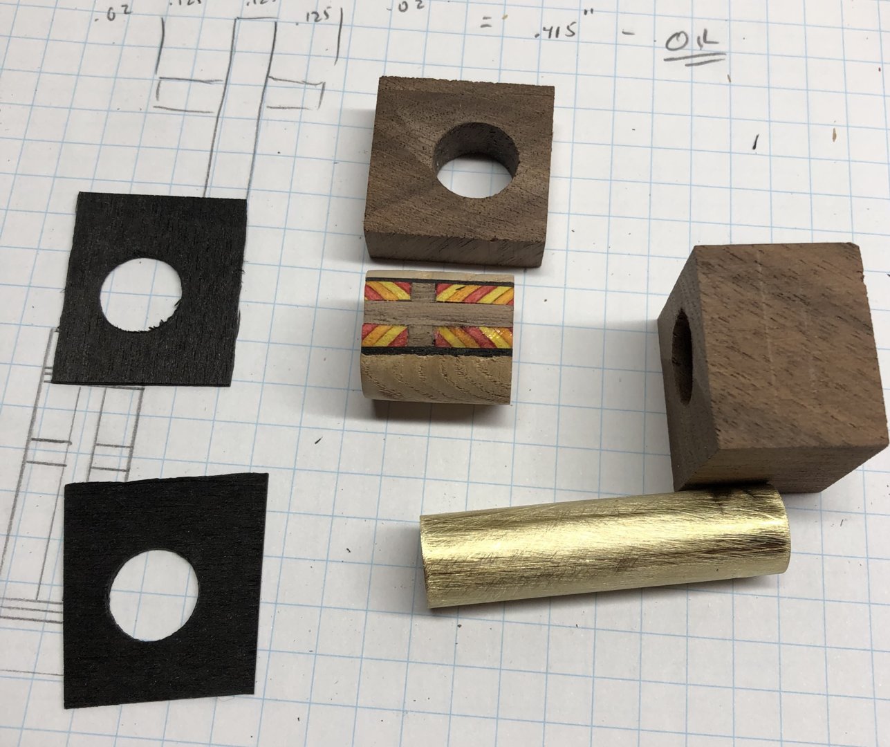

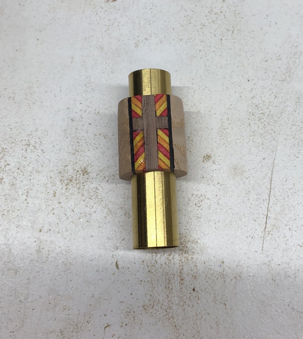

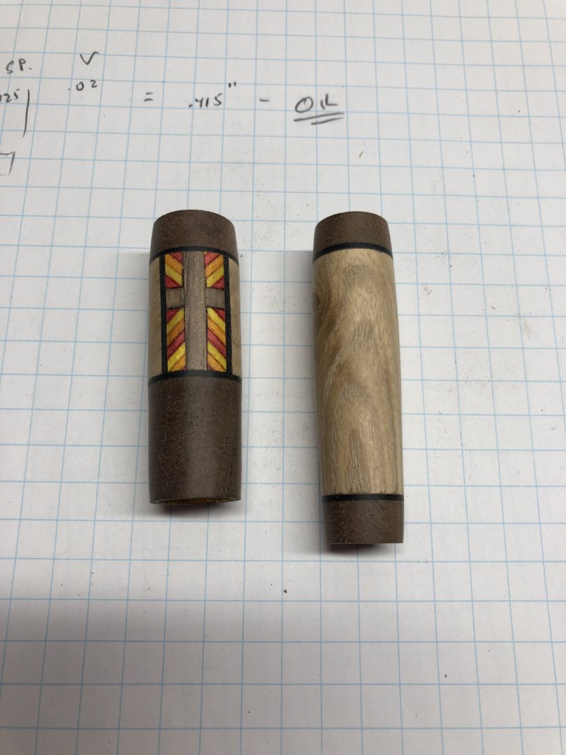

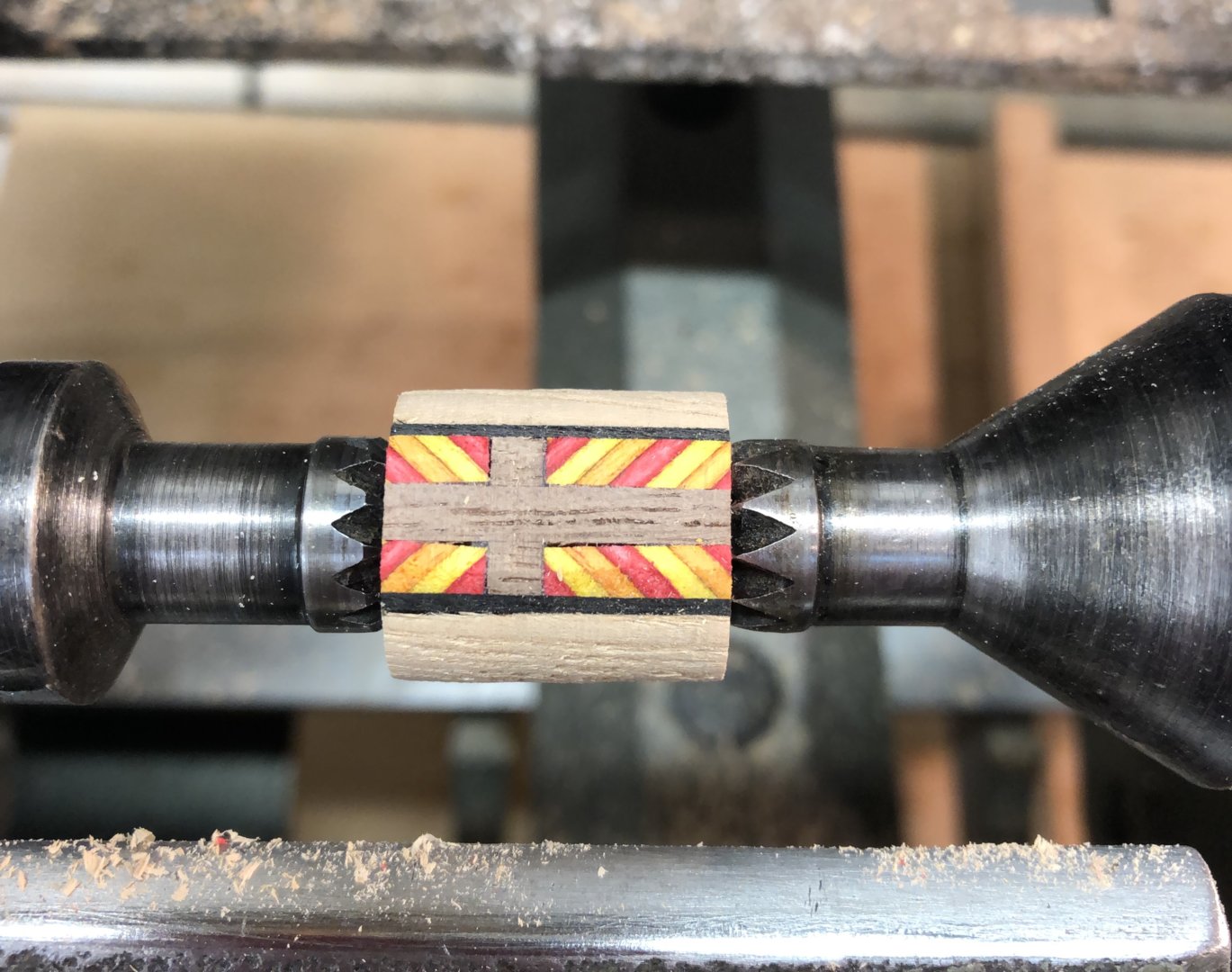

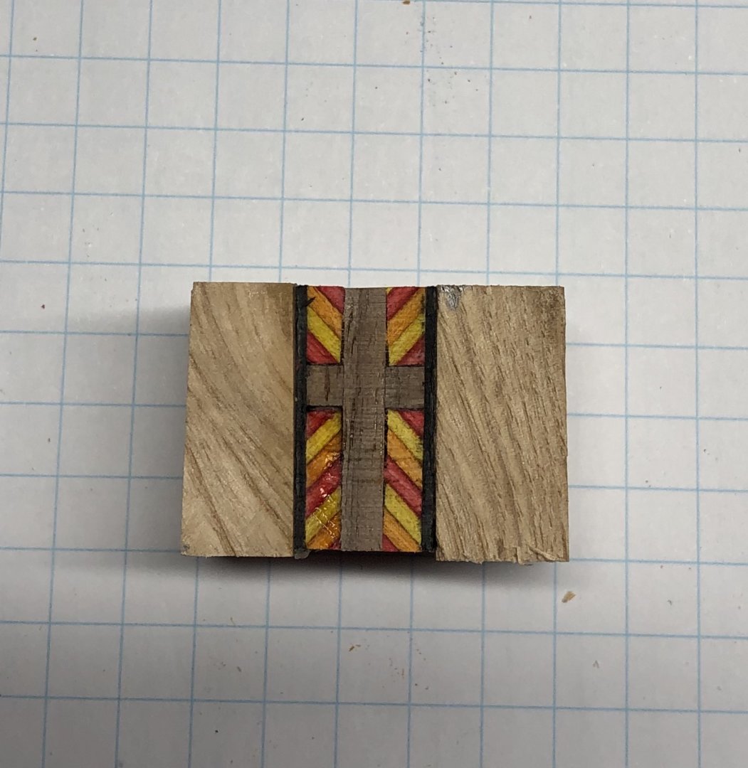

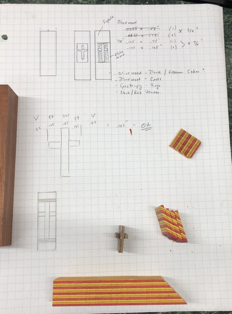

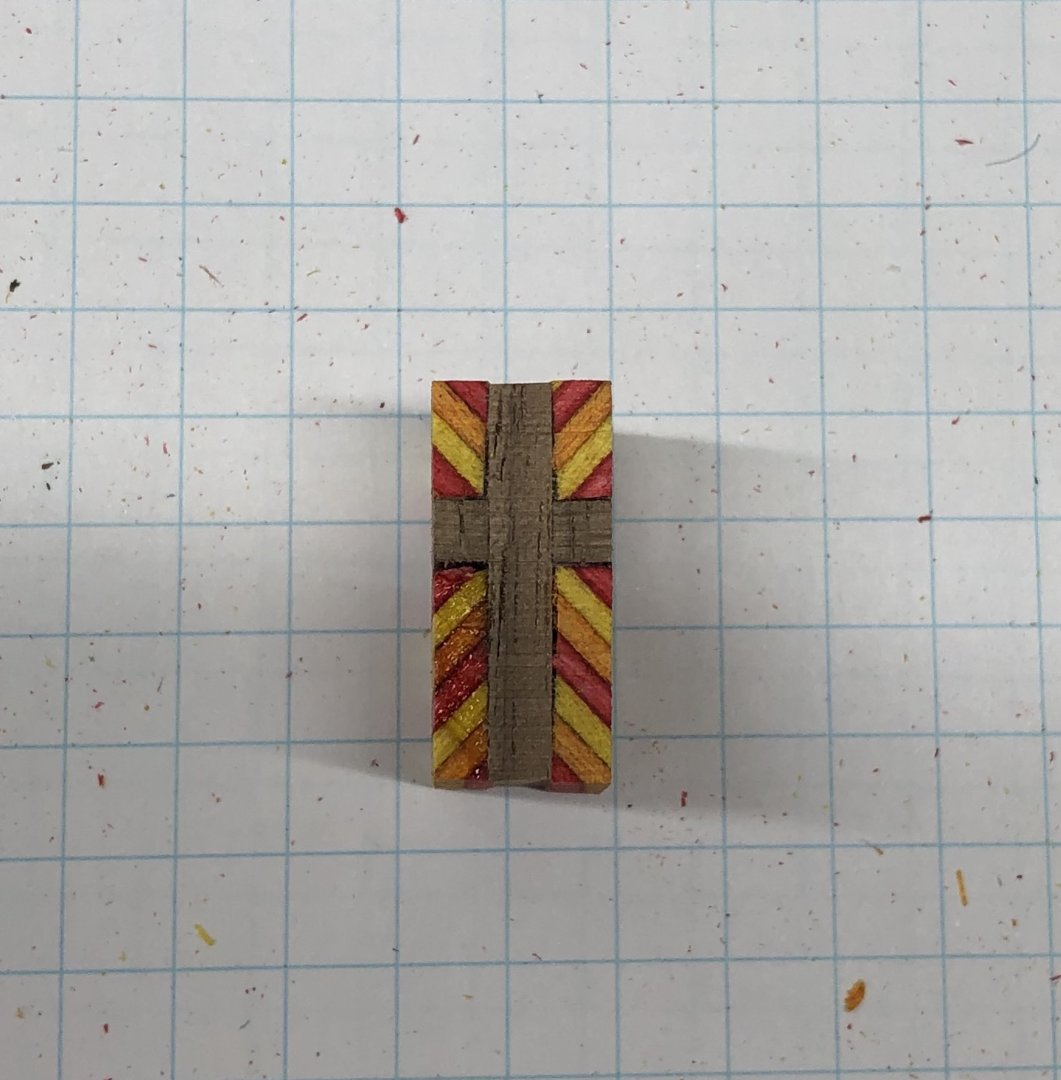

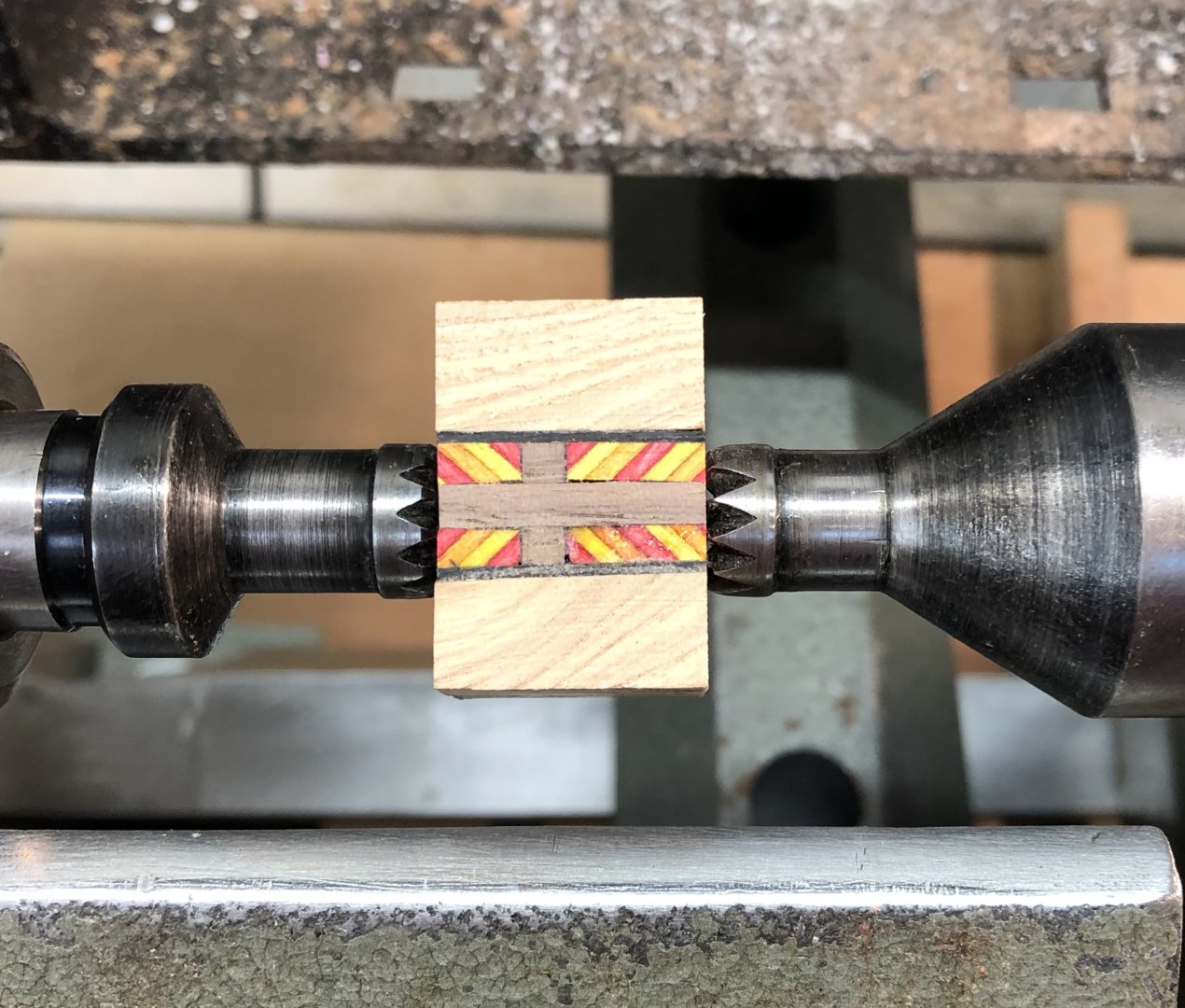

These photos are in other threads, but I'll include them here for anyone interested (I've received more PM's for this design than any I have done). You'll need: A spectraply pen blank (or make your own), some walnut thin stock, some black veneer - that's it (oh, some glue...)

Thanks for the pics and background info, I wasn't aware at all of the story behind the design. Obviously you guys nailed it if I saw what it's supposed to be with no prior knowledge. Those two pens are beautiful as well.
I have no appropriate words to express the craftsmanship of this pens. You have inspired me since I am new to the craft. Well done, well done 🤗
