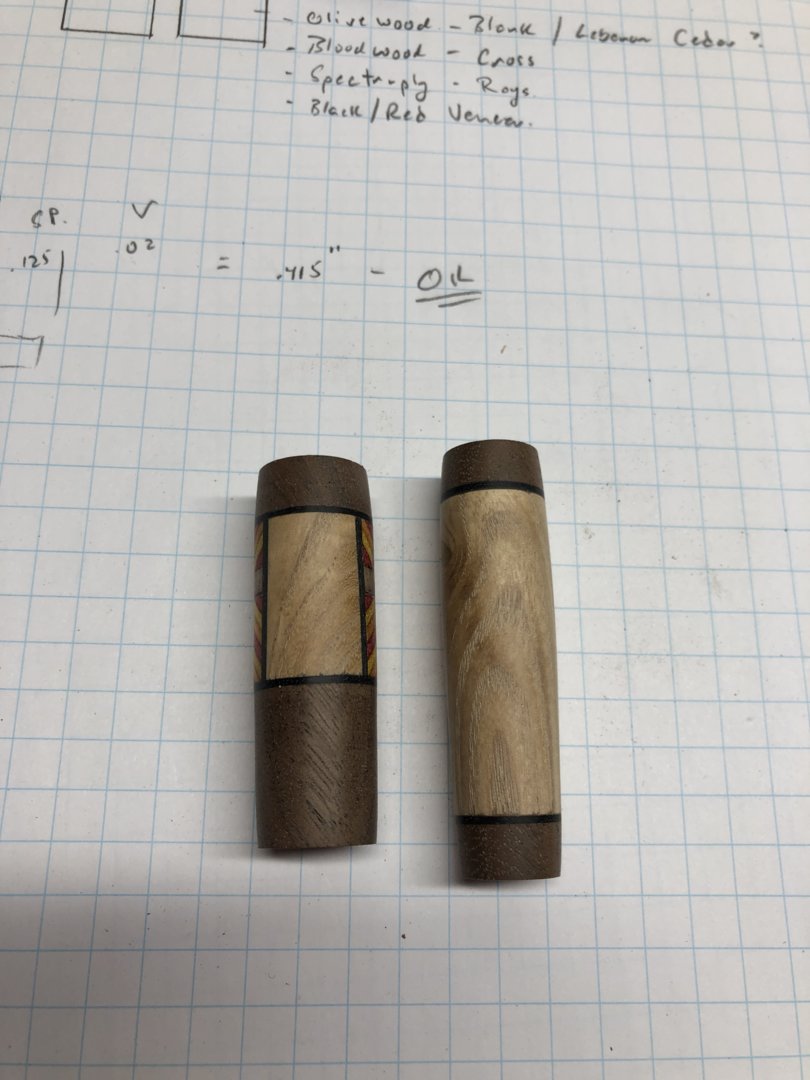

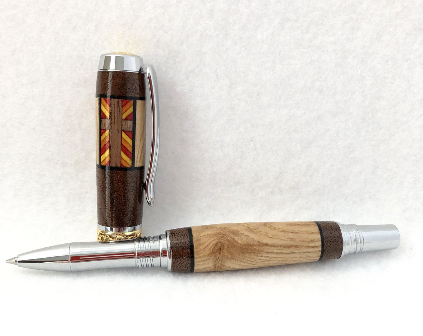

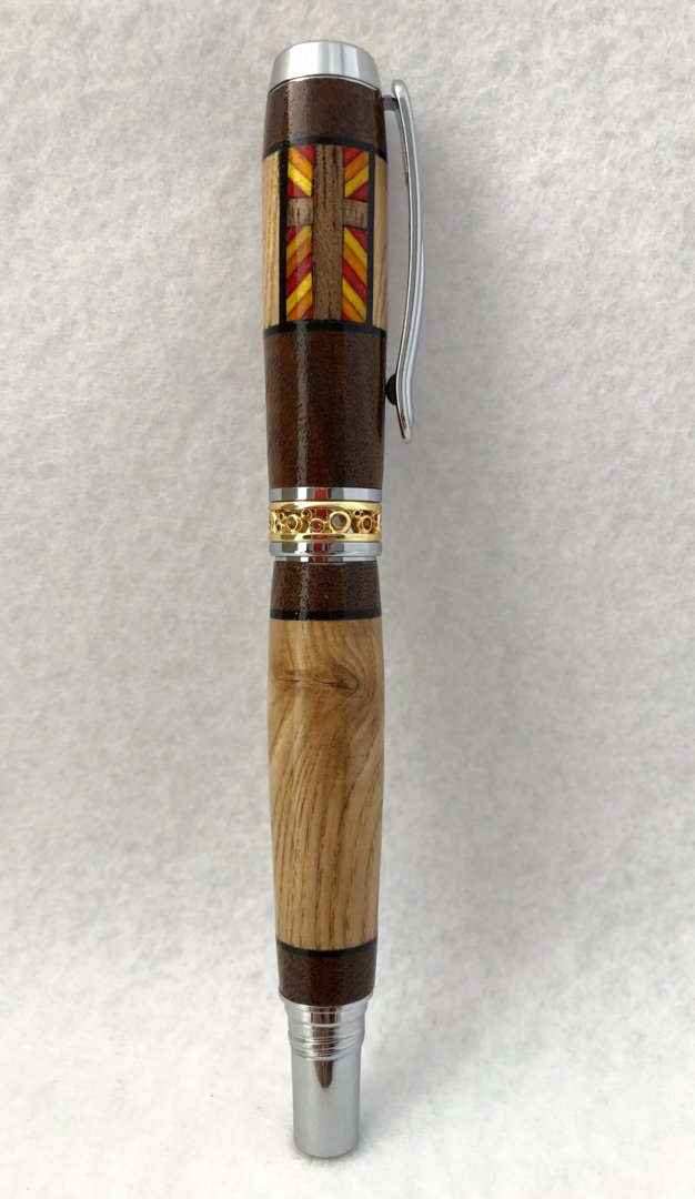

This was the second version of this design. In the first (I'll post in a separate thread), I used Olivewood and a thinner cross. I wanted less figure in the wood, so not to detract with the cross, and I wanted a cross that looked "nearer," so used wider segments. And I used Lebanon Cedarwood in this pen.
Steve has received the pen, and I have received his, so there will be another thread with his.
The suggested PITH Theme was "Pentarsia."

Mark, that is a great looking pen. Fine craftsmanship. Thanks for posting the process pictures. Makes it look easy, but in reality I know it takes talent and patience. Unfortunately, I have little of the first and none of the second ;)
Wonderful, I don't have the patients or talent yet for some thing like this. I just want to get a Celtic knot to look right. But, I did just start turning pens a month ago and turning in general 4 months ago (lots of 2x4 cut into blanks to practice).
Hi Rick, thank you for your kind comments. Actually, this is an easier blank to construct than it appears. I highlighted - yet, as that is important. Get comfortable with some simple segmenting (Celtic Knots are tricky buggers and I don't view it as a beginners skill, but it will indicate many areas for practice), then play with new designs.
Be willing to screw up, be patient and build your skill-set.

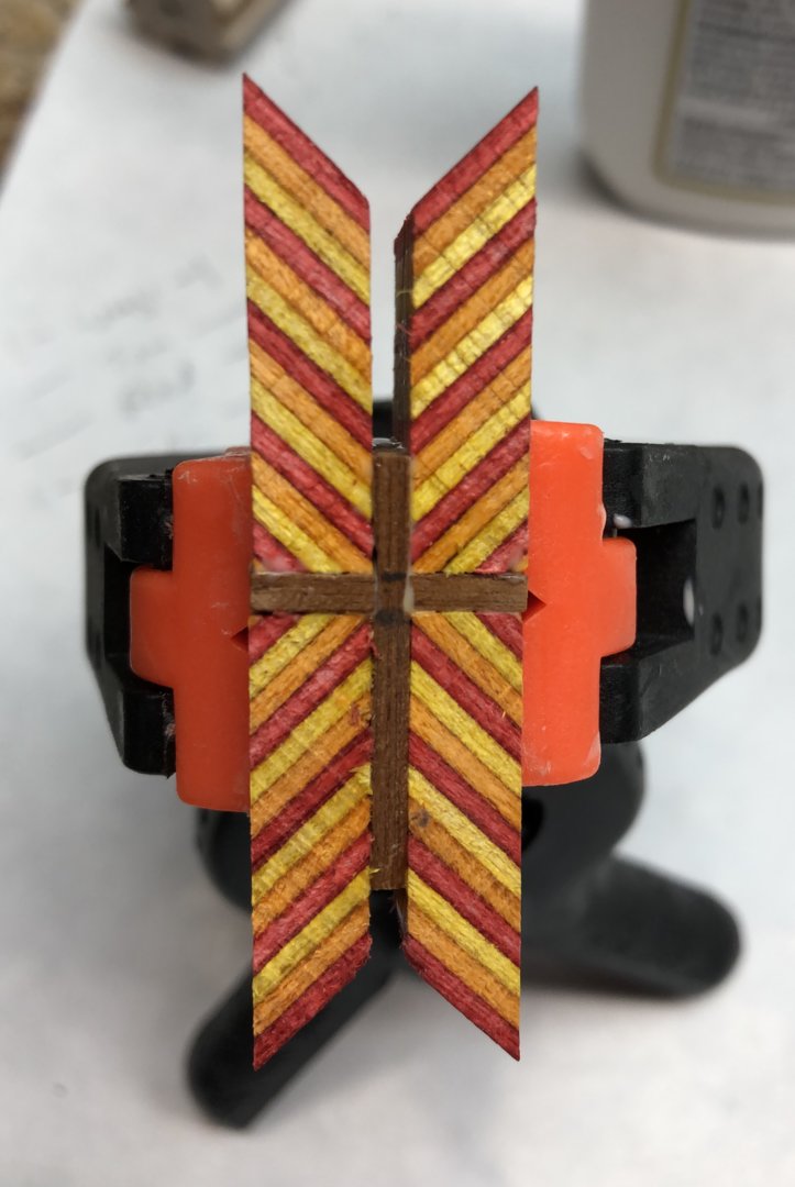

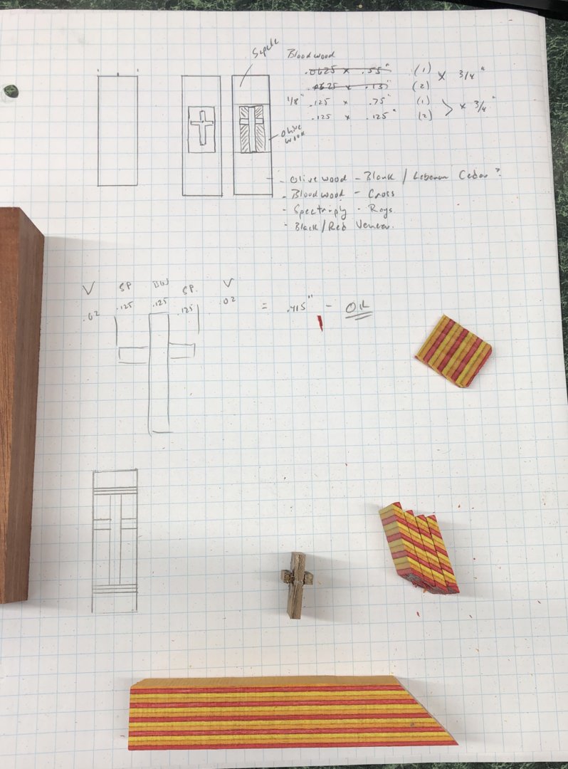

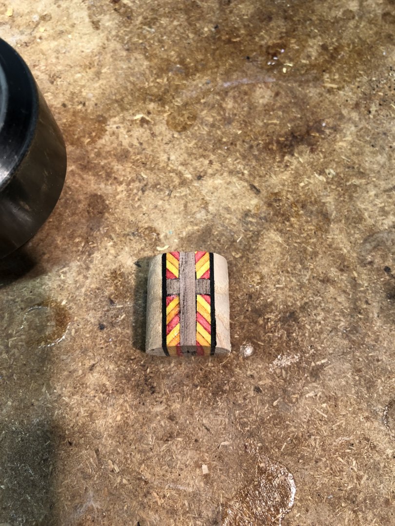

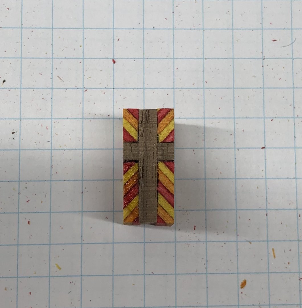

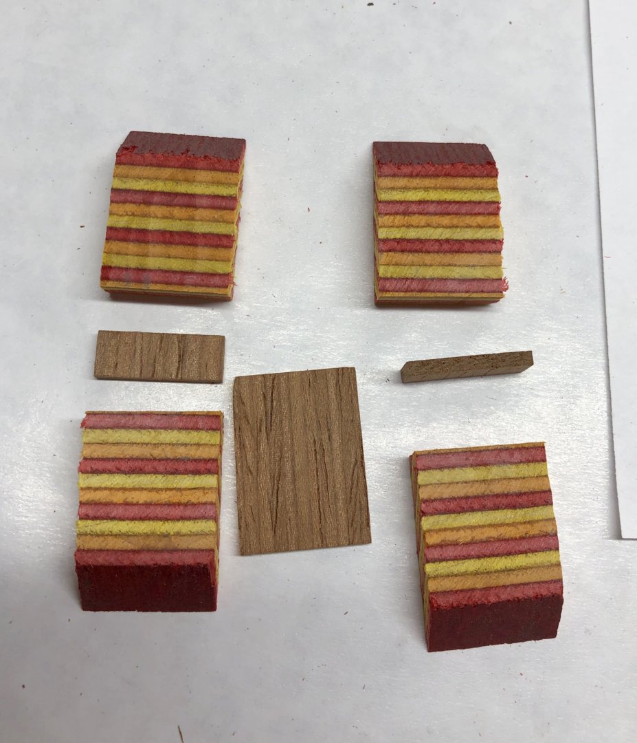

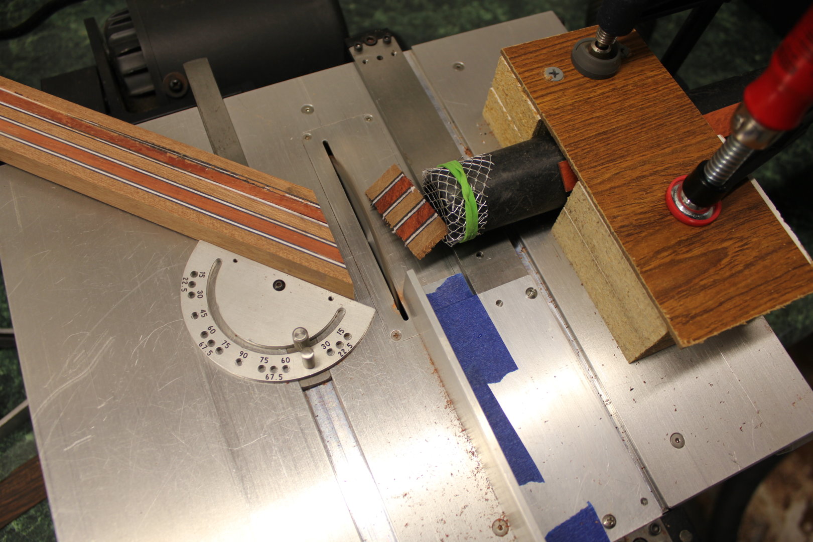

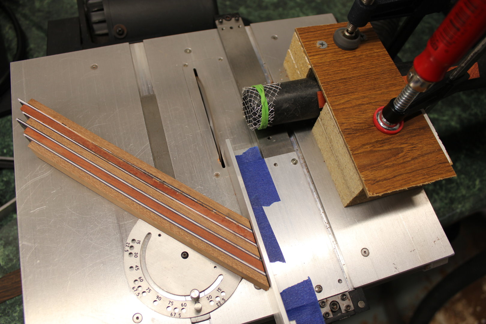

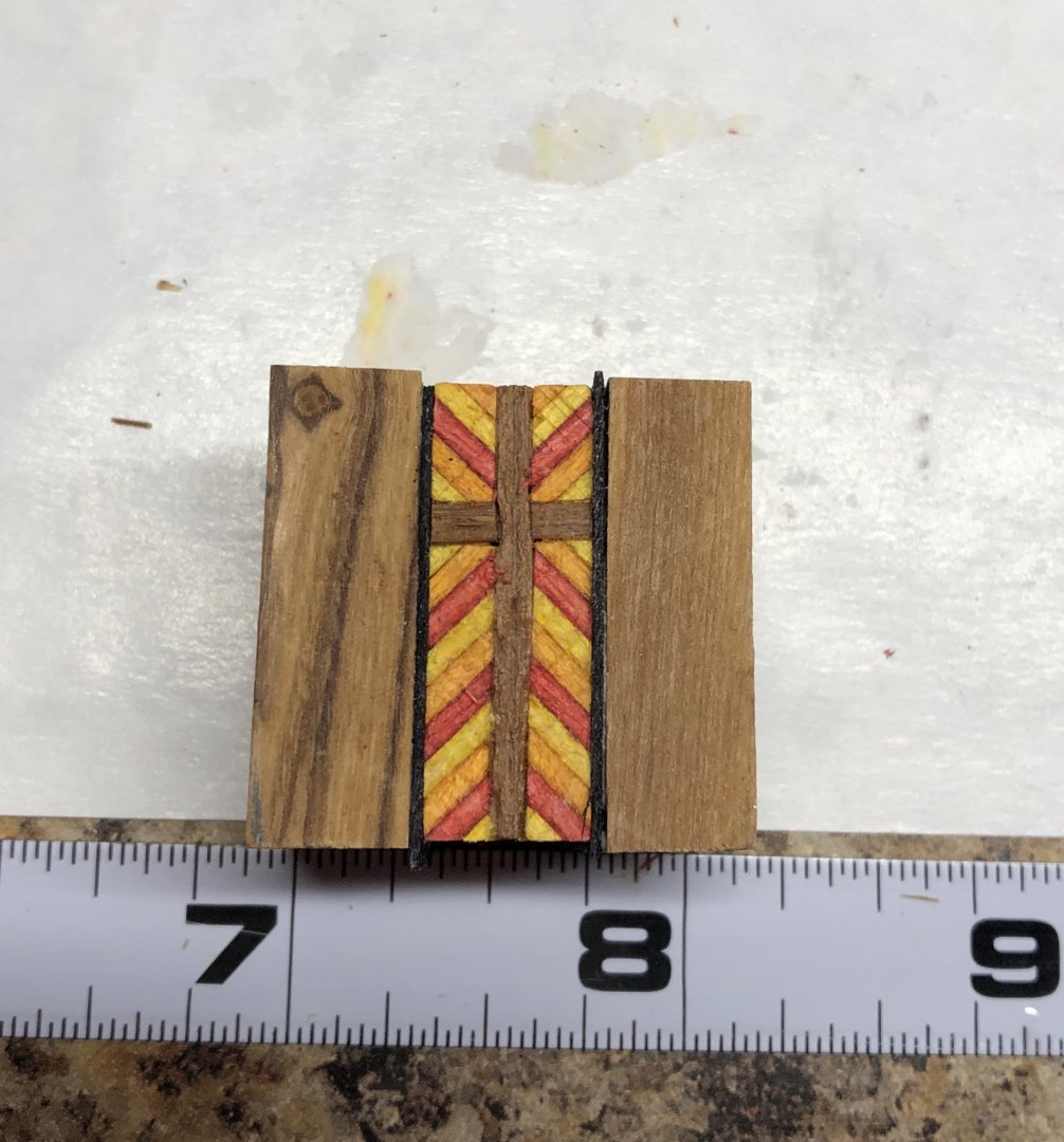

However, to answer your question, I cut 45 degree slices from the initial "brick" - pen blank size for these actually. Then I simply used a disk sander to get the ends that were in the middle joints of the cross to be even in their color pattern. This was easy. The amount of the spectraply sticking out is easily trimed/sanded. I have one picture where there seems considerable waste, but as
it was only about 1/4" I was not concerned.
I used a table-top model-makers table saw (Byrnes), but have also previously used by large Craftsman Table saw with a 45 degree angle sled.

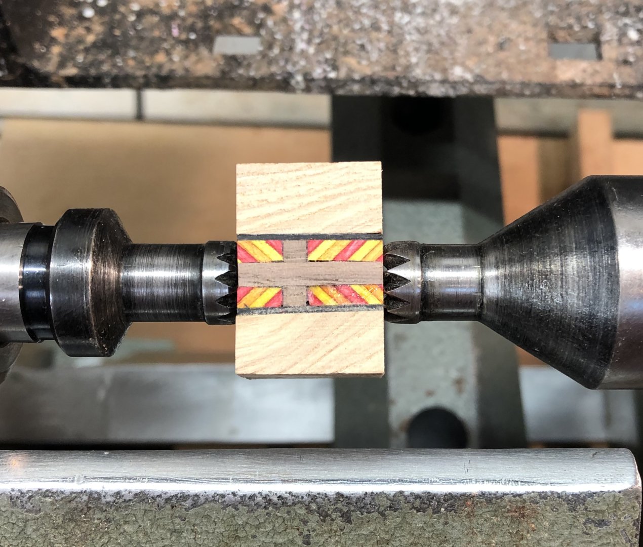

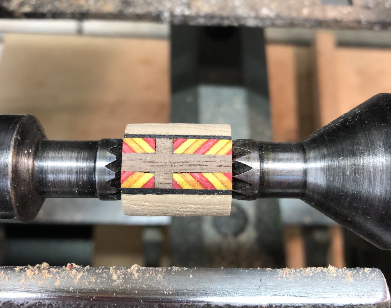

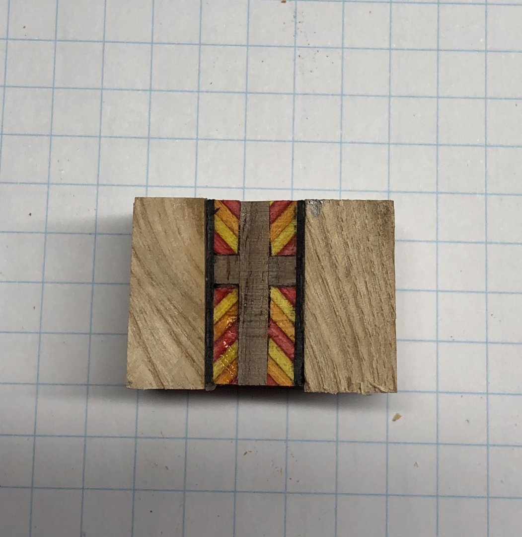

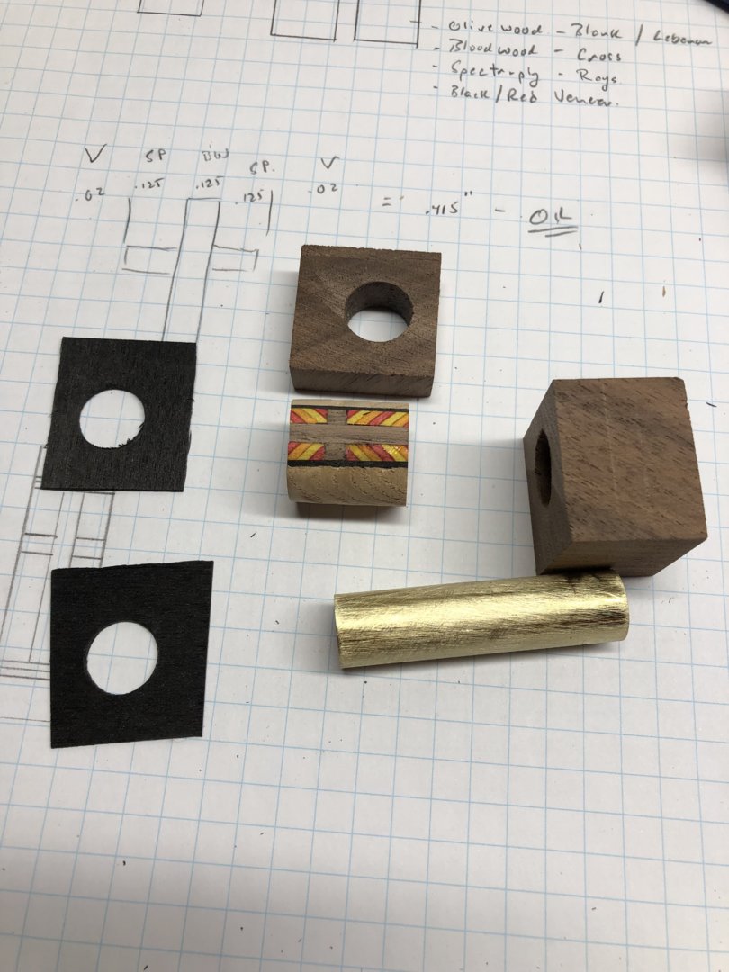

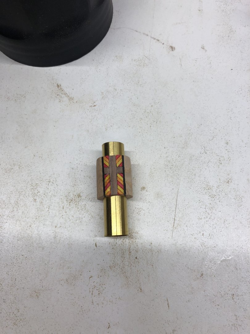

Time... These blanks took me in cumulative time less than 2 hrs. I would cut the slices, sand then even, cut the walnut cross pieces, glue the pattern together and let dry for 1-2 hrs (Tightbond Translucent, but I suspect other wood glues are fine). Then I added the black veneers and side pieces. Marked the ends CAREFULLY between the pattern, turned round, placed in a collet chuck to drill the tube hole. The glue onto the tube with more veneers and end caps (2 part epoxy for wood to tube).
Honestly, this pen looks a bit daunting if you have not done much segmenting, but is is a very reasonable blank to start with. Very worth the time. It is a nice project to do while doing other projects as you need to wait for the glue to dry fully.

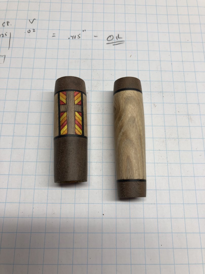

I made the first pen with Olivewood and a thin cross. While it looks OK, I tweaked it to make the cross look "closer" e.g., wider segments, and used Cedar from Lebanon instead of the Olivewood. I felt the Olivewood distracted from the segmenting, and the Cedar of Lebanon was equally appropriate for the theme.
Hope this is helpful, and ask any questions if any arise. And do make this yourself, lots of fun when they work!

I have usually made my own "bricks" (layered stacks 1" x 2" x 6"), but for this specific design with a cross and the sun shining through the stained glass, the vibrant colors of the spectraply was perfect. Here, I used Tequila Sunrise.
Honestly, the blank looks more daunting than it really is - like a "cowardly bull." Be prepared to make 2-3 attempts, and then don't be surprised if the first one is just fine. The actual construction of the upper blank segmenting (only 7 plus veneers for the cross; then the end caps and veneers) is straigntforward. The lower blank is even easier. A ket for alignment is to accurately mark the center of the designs on the ends to avoid a taper in the side panels.
The black sections are just stock black veneer - about .019 - .022" thick. Sometimes I use a thicker stock which I need to get from guitar repair websites. Not sure what you have over the pond.
