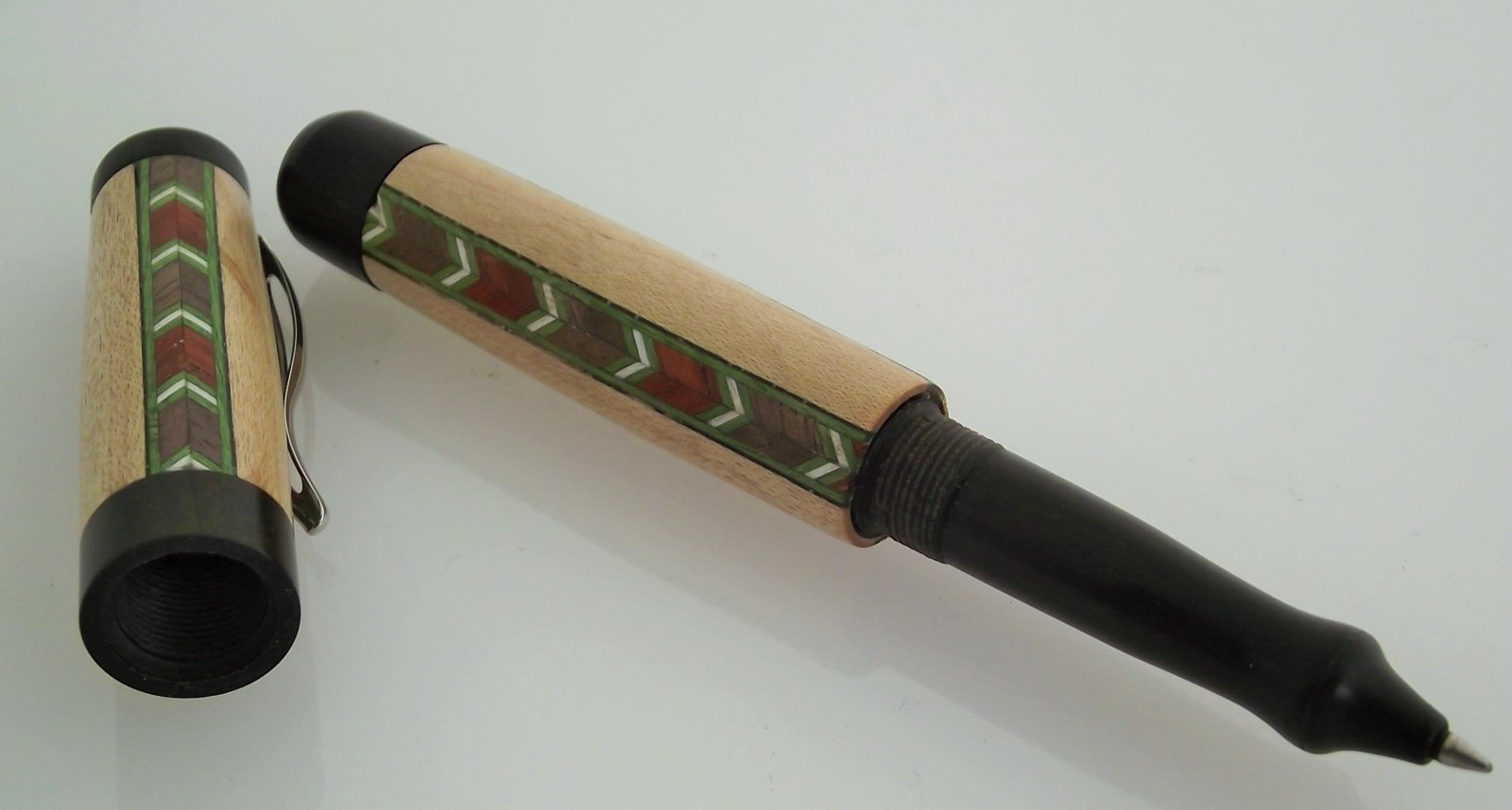

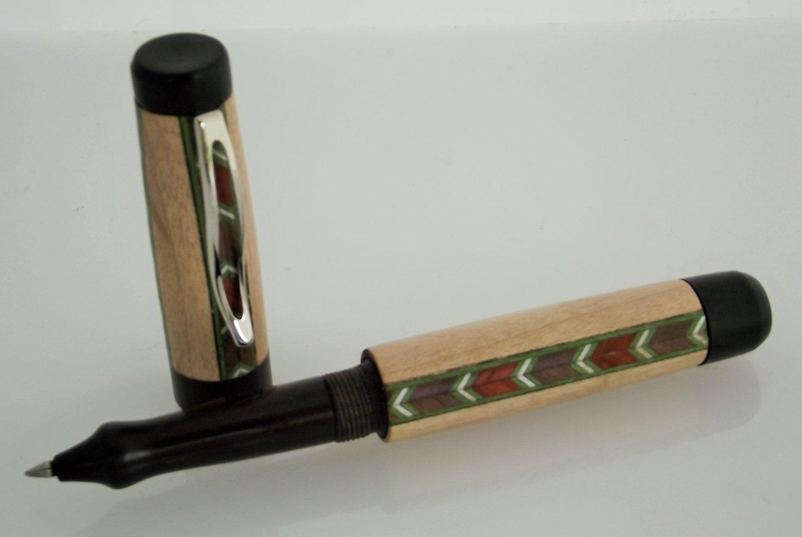

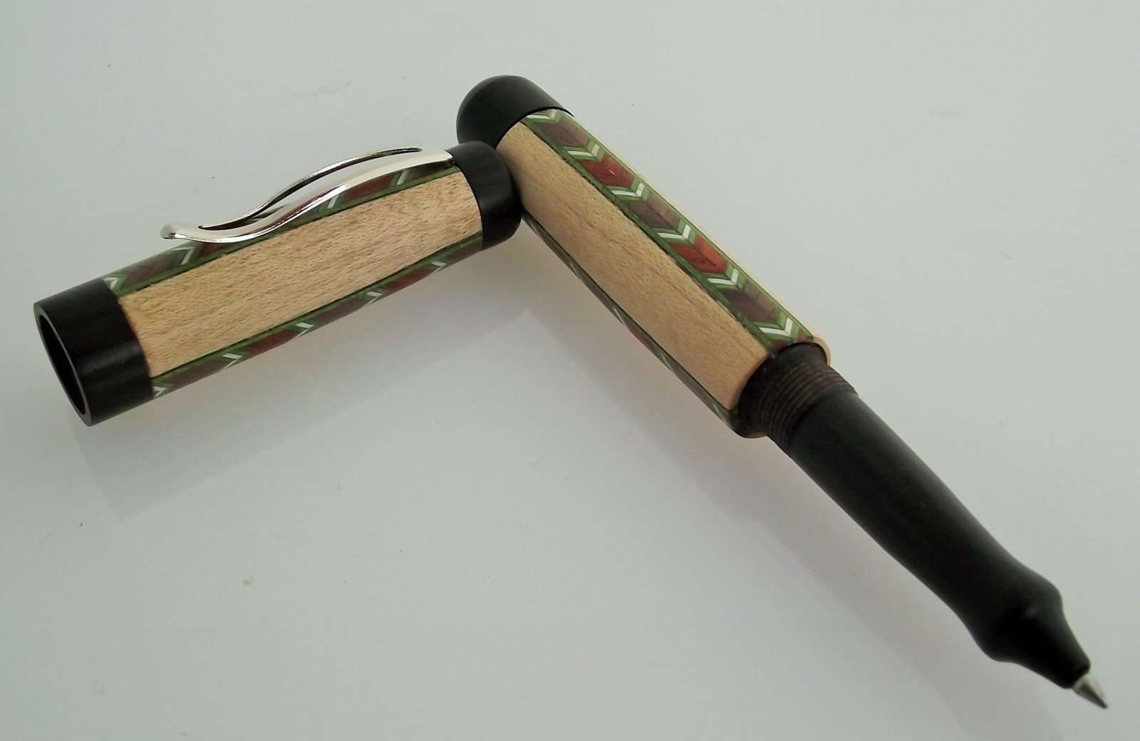

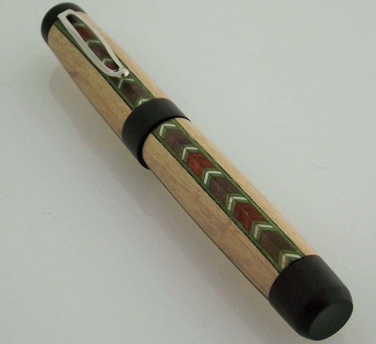

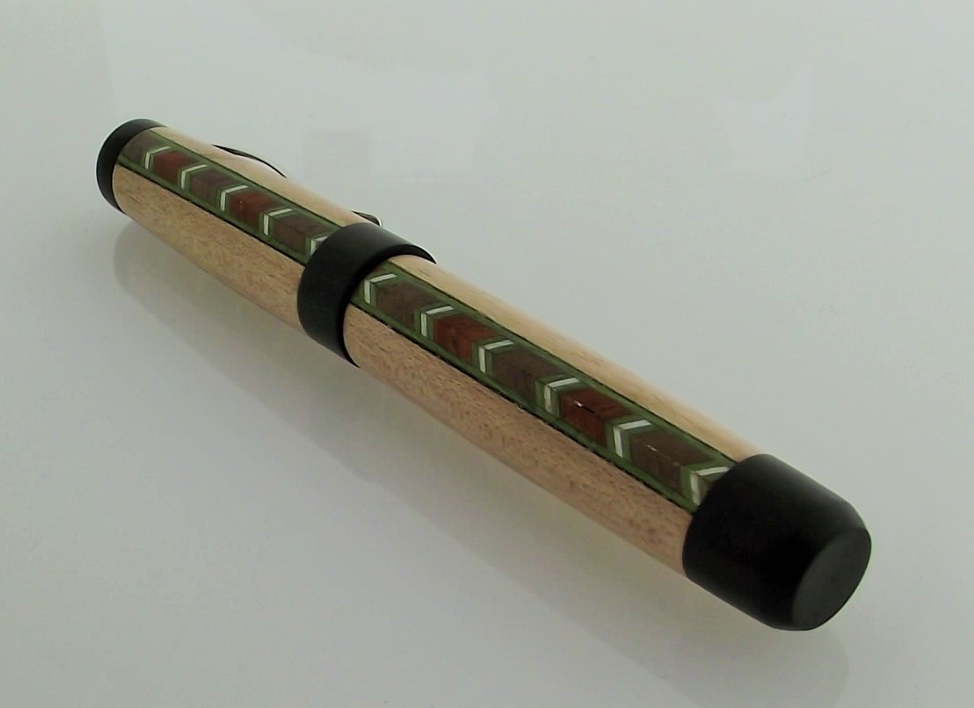

Some many months ago, Mark James was really cranking out some awesome segmenting. A bunch of us turning friends were together SOMEWHERE in the midwest, when Mark suggested to me...Hey, wouldn't it be cool if you made a kitless pen using all wood? :oops: (This was my facial expression) I thought it was a great idea! Who's going to make it? So, I took up the challenge, and what a challenge it has been! So in trying to worm out of it...I told Mark, I would need a blank 7" long to keep it uniform. No problem he says! And that's what I received. So, when we had our Local chapter meeting at Rockler, I noticed a nice black blank in their blank scrap bin. I asked Rick how much for this African Blackwood blank? He said Take It! I did...😁 Here we have it! All wood segmented kitless Rollerball pen. Many thanks to Mark James for initiating this cool idea!
I kicked finishing ideas around for a long time, and settled on sanding through 12000 and applied Renaissance Wax. Ready for the next one!

Chuck, if you think it's so horrible, let me help you out, you can send it to me. Then, it won't be sitting around you, bugging you as much as it can. Sure, if you want to pick it to pieces, you might find a few small issues. But with this being the first you've ever made, you should be gleaming with pride. I think it turned out amazing looking, especially, with it being your first one of this type of blank. Let me know if and when you want my address, I'll send it to you by P.M.
Len
Really nice work Chuck, and Mark.
Chuck, I can appreciate the challenges you had making this pen, timber doesn't play like resin and ebonite.
Thanks for showing us the results of your endeavours.
Thanks Brad! Good thing about Blackwood, it's dense enough to cut threads on.
You are already aware of my option: That is one sharp looking pen. Great job. Oh, and Quite Nice!
I know when you and Mark were at my shop at the same time last year the two of you were trying to figure out external diameter vs bore vs depth of segments.
This obviously took a lot of thought and planning. Plus, you got it finished before the race started! Lol.
Thanks Mike! That goes farther back than my memory will allow. I appreciate the reminder.

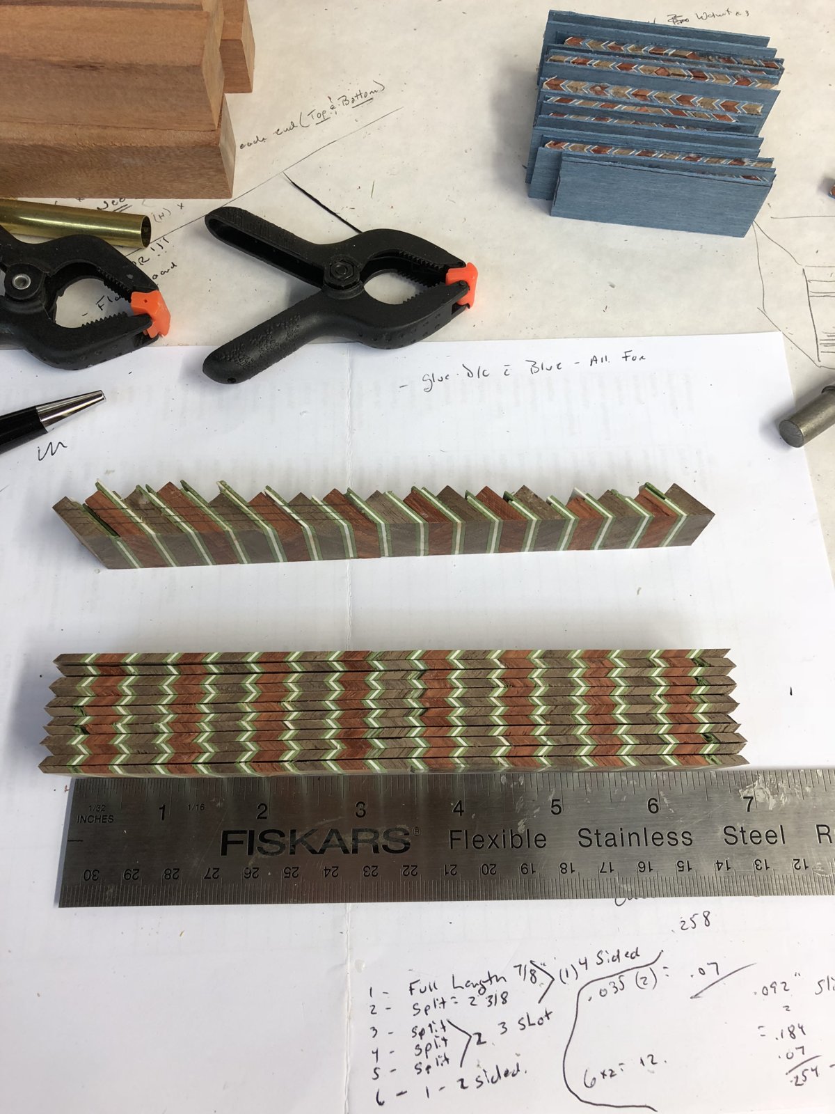

My Idea? 😏 If my memory serves me (it usually doesn't anymore), I was just sitting there minding my own business smelling the smoker that Mike was teasing us with for some awesome ribs, and the rest of you fine gents were conspiring. While the Chevron pattern was one I had done before, I had not done any 7" long (the initial brick was huge), and not in a three inlay blank.
Its always a hoot to see someone else take one of my humble blanks and create something I cannot. To see something as well done as this is a very special treat! I love the black end caps, It was a great design choice.
LOL! I guess your memory is still better than mine. Either way, how ever it started, it was a real pleasure overall to have this opportunity to
actually make a pen I've thought about, but just never tried it. Thanks for your help Mark!
Wow great looking pen Chuck! the segments look great with the blackwood, i really like the segments showing thru the clip neat touch, also well done to Mark! very neat seg work it's very :cool: looking pen
Thank you John! I thought since the clip had the window, why not have the chevrons showing through?

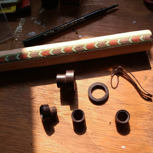

Impressive! Do you know what the final thickeness of the pen walls is? Did you make a Blackwood tube suppport the blank?
Thank you Bryan! The cap is drilled 7/16ths deep enough for the section. Cap wall thickness, .115 OD is .655 at center band. Lower barrel is drilled .250 or maybe a little larger to clear for the refill. OD of lower barrel is .635 in the middle. The OD of the 9mm threaded inserts is .433 I didn't want to go any thinner with the tapers. So it's beefy enough to not be concerned about snapping it, yet still comfortable for use. A phone photo of the threaded parts attached.

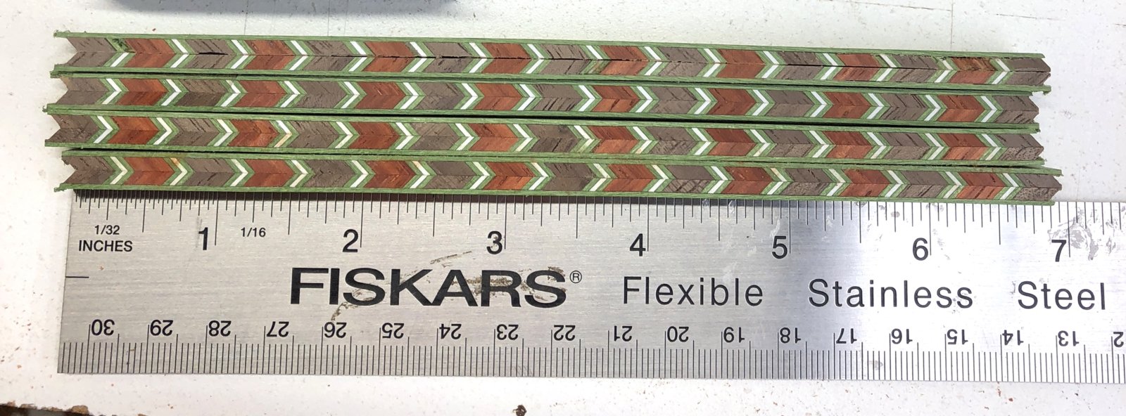

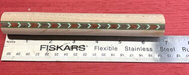

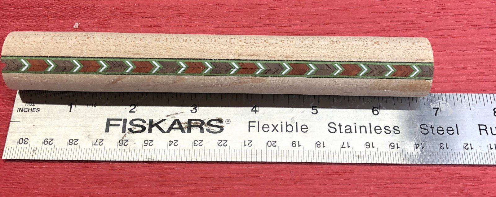

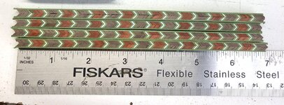

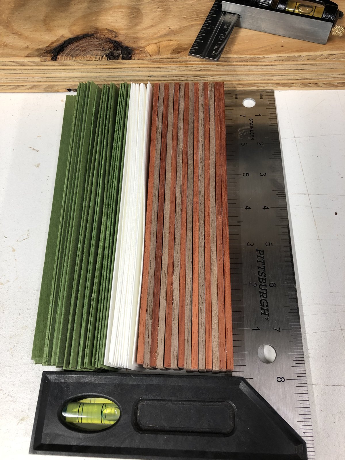

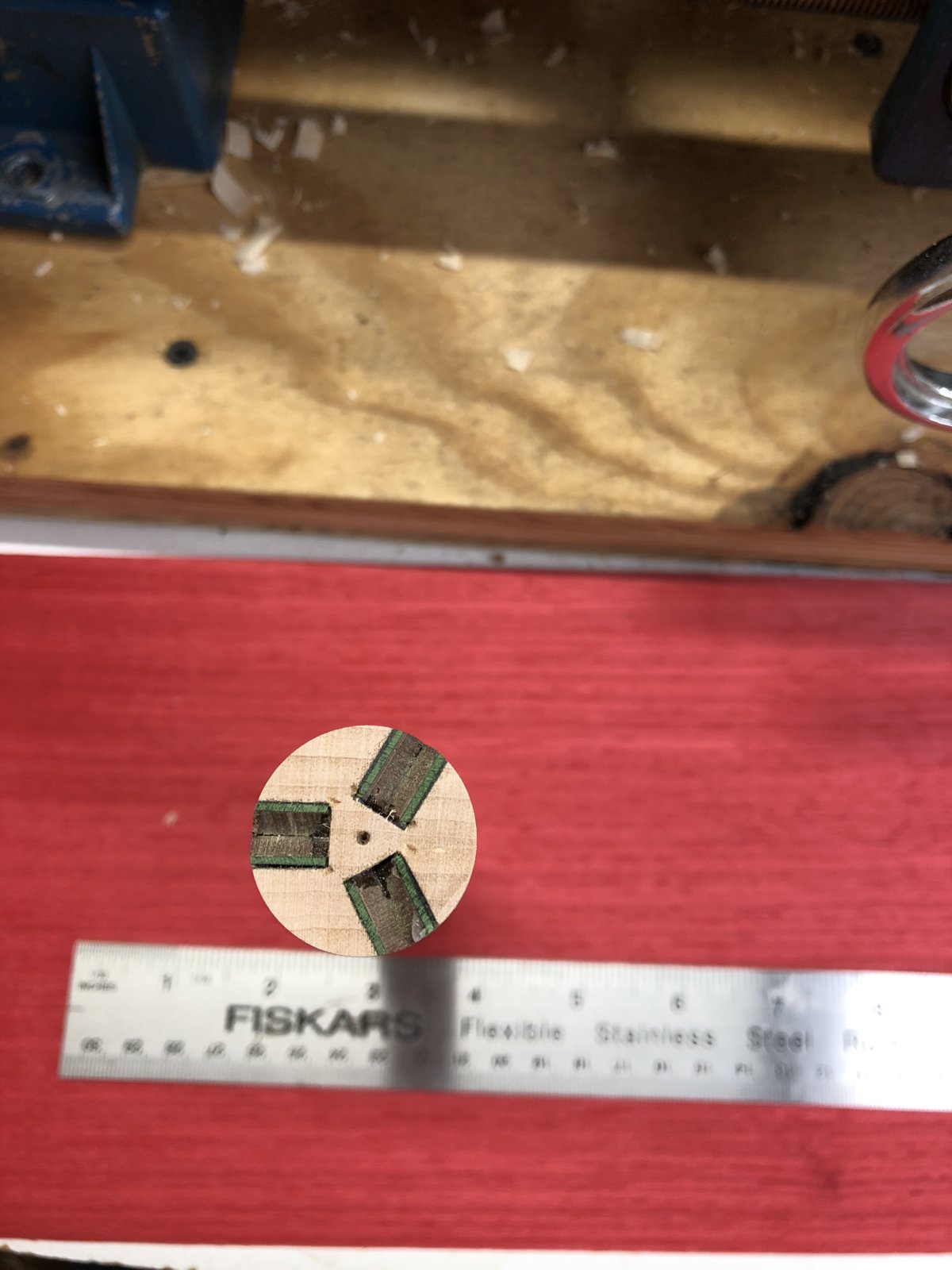

The blank was done in a few hours and other than being a much longer dimension than I had done before (6 1/2" vs 3") went pretty well. I cut the slots on my lather mounted router, with a .250" slotting bit. My contribution was minimal to the challenges Chuck had to wrestle with.
Chuck, thanks for the picture. Most explanatory.
