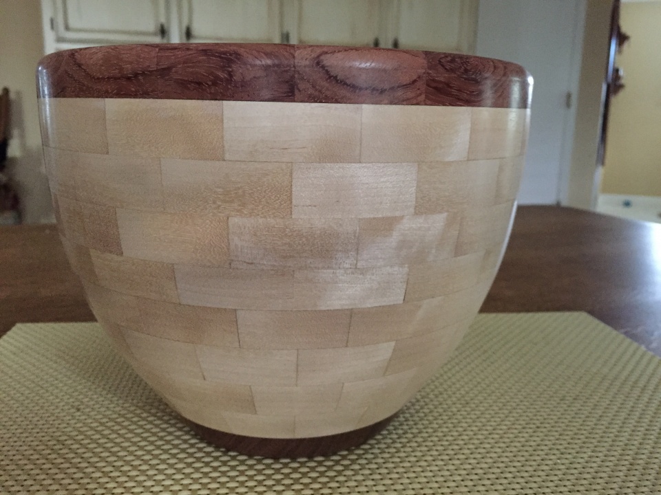

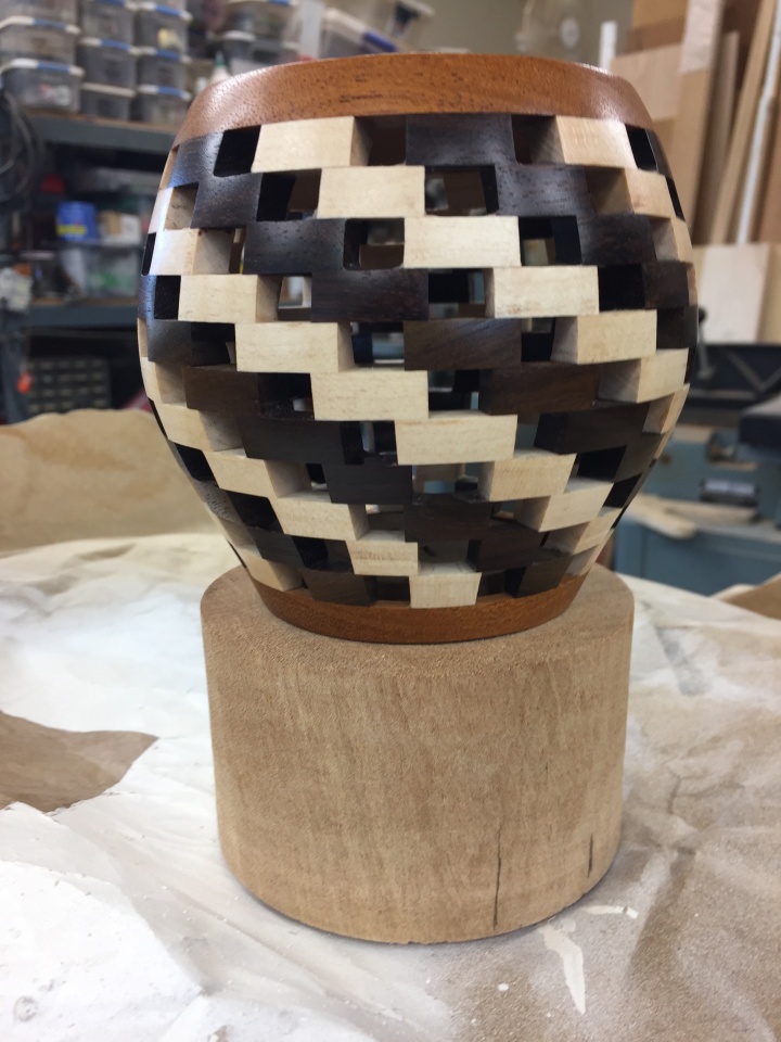

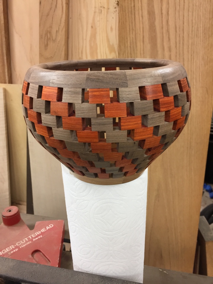

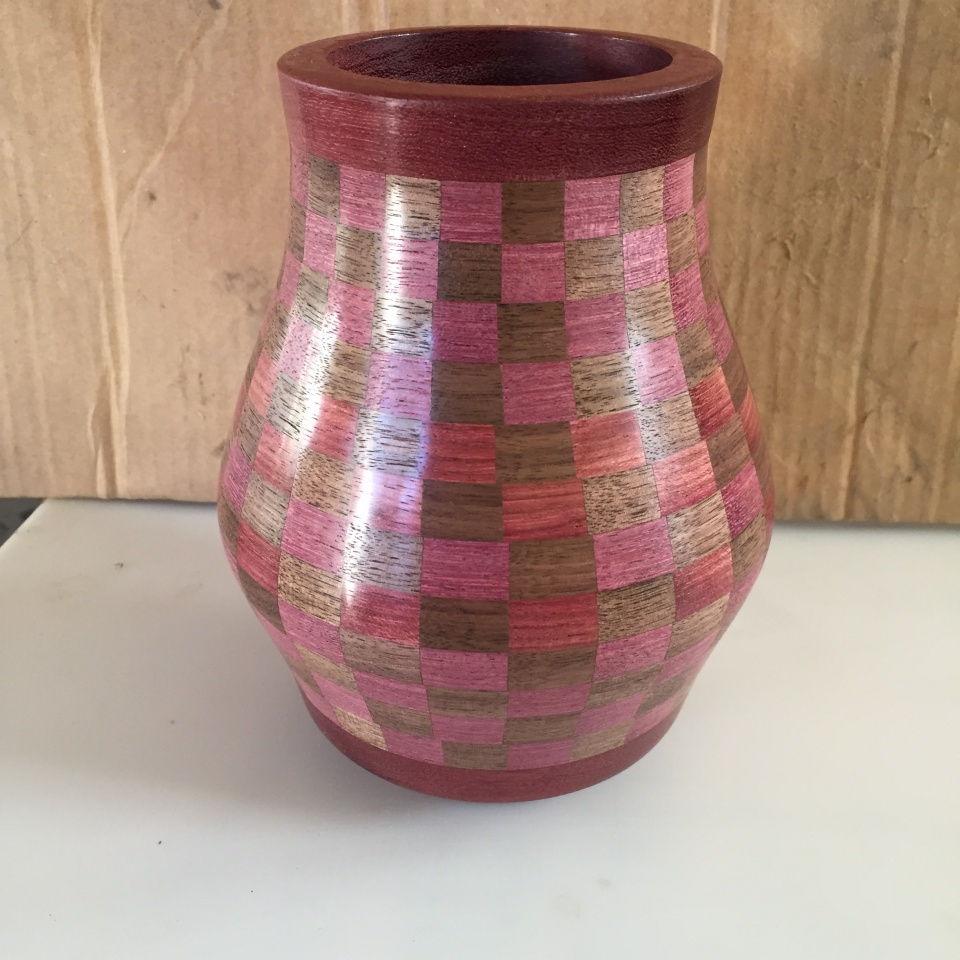

All time not spent on pen these are some of my other turning.Open and closed segmented .

G'Day Charlie,
I've done some very simple boxes and bowls, so a newbie.
What tools are you using for the outside and inside. And are you using different tools for the closed segmented vs the open segments? Just a few thoughts for the future.
Cheers, Mark
Left to right
Walnut-Purple heart
Walnut-Maple with Cherry rim,base.
Walnut-Paduak
Silver Maple- Walnut.
I really like the silver Maple from Oregon, kind hard to find but sure turned nice.
G'Day Charlie,
Cheers, Mark
Mark:
For Closed stuff, just bowl gouges and shear scraping. Turn to 1/4 or less on the walls. The Silver Maple bowl is 1/8 on the walls.
Open Segments are a different story.
What I do on the lathe when building it out is to turn the inside and out side per my drawing with gouge and sheer scraping as I go. Got to be very careful not to catch, I have found by using large gouge rubbing the bevel I can keep the tool supported. For the rim on the inside I use a small disc cutter carbide. Again I try for 1/4 or less wall thickness.
I use lot of jigs for cutting, sanding and jig for putting the segments rings together. Major problem is keeping the vessel in axis alignment.
So far I have found trying to make segmented pen due to the small parts is much hard to do.
Keeping the too;s very sharp.
But if it were easy everyone would make them.
Cheers
Charlie
