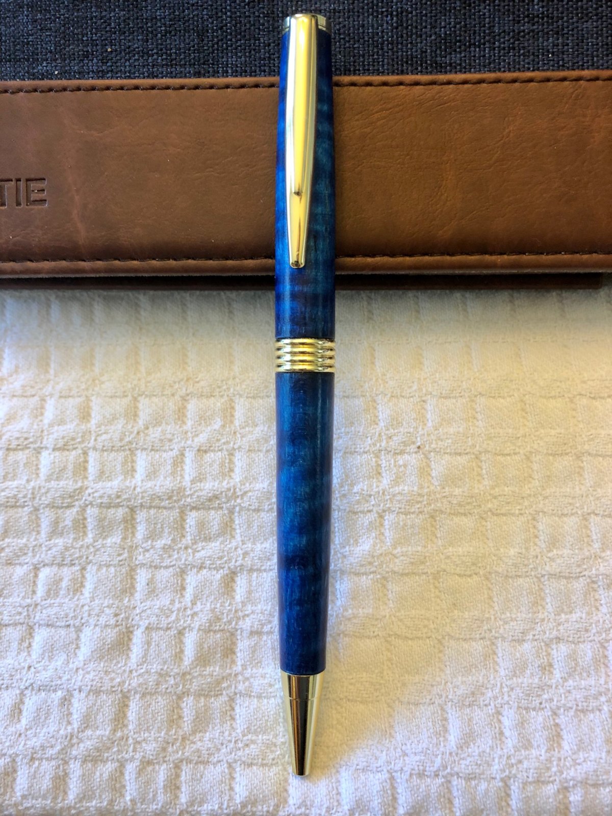

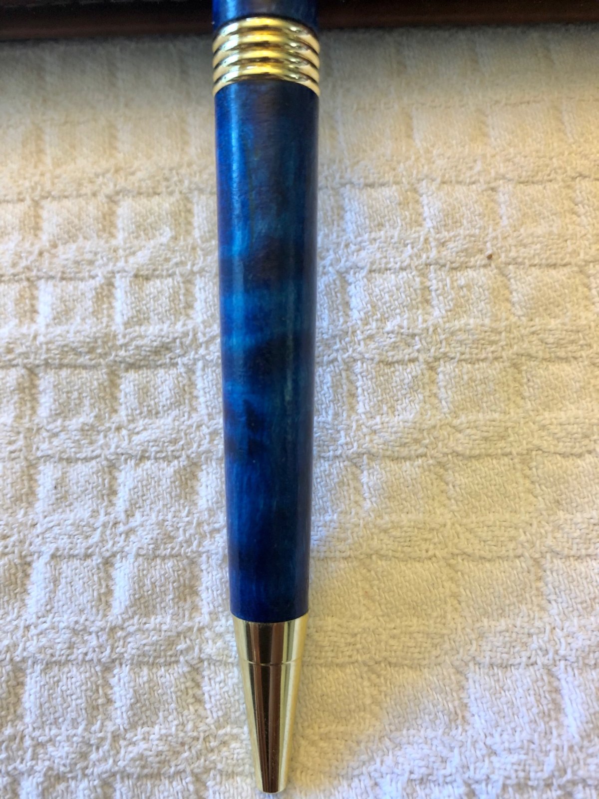

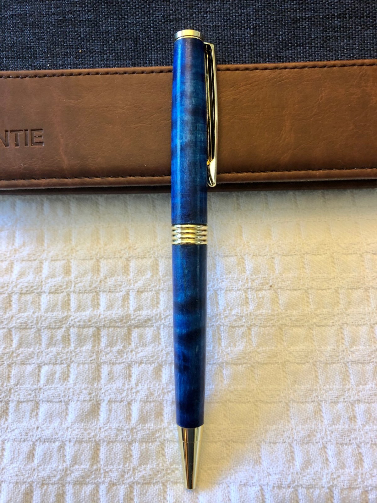

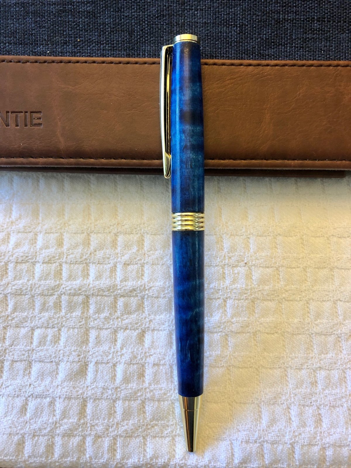

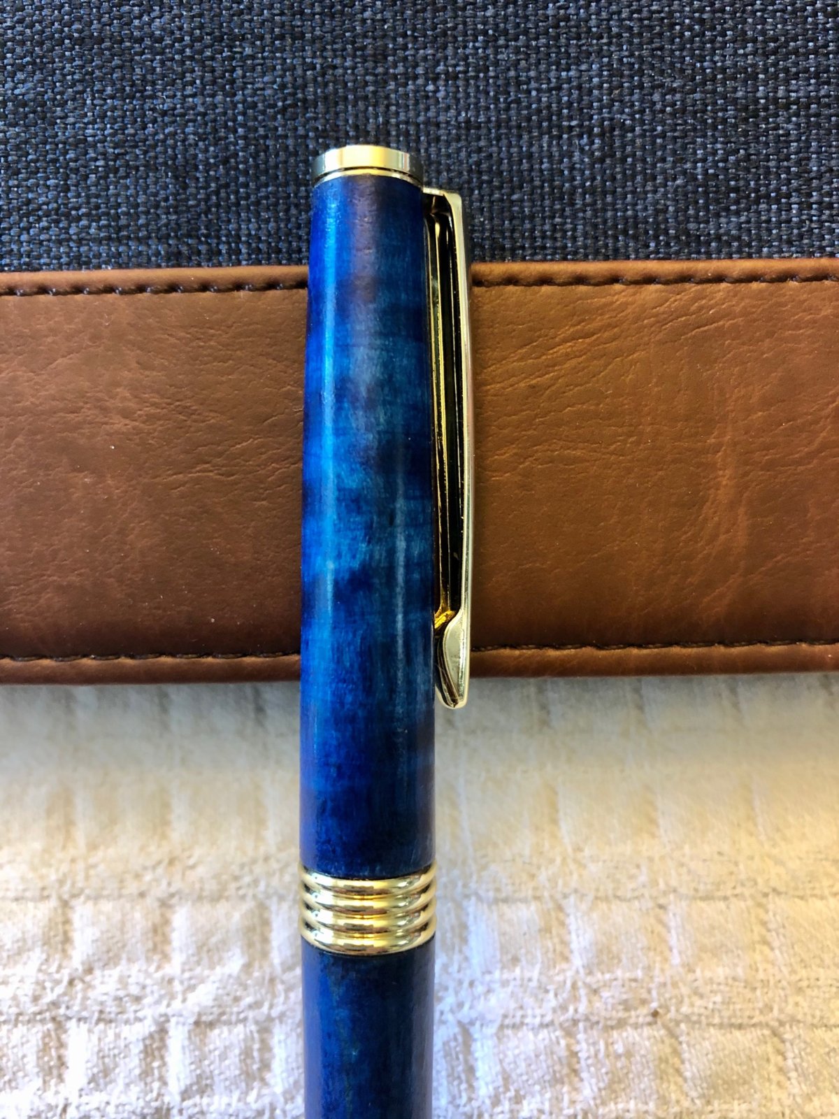

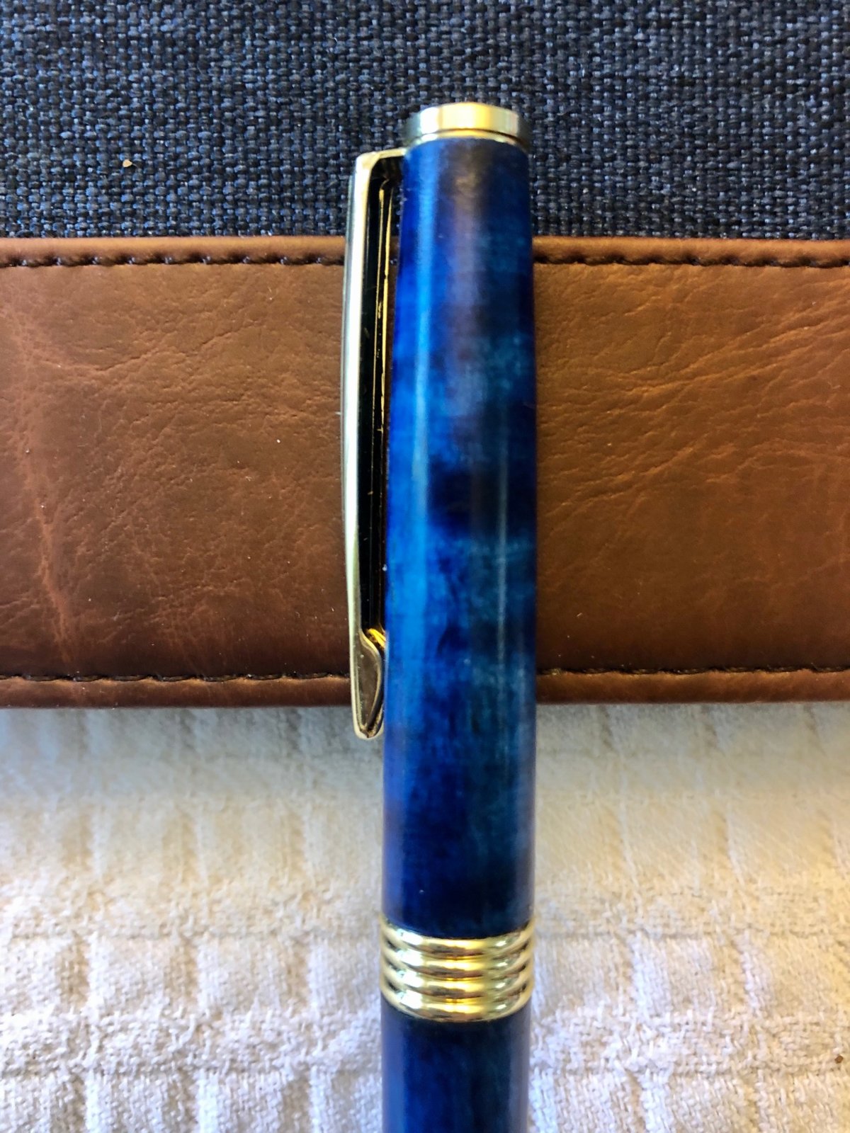

Sorry about not posting recently ... I was traveling and then had some health issues. I am back and trying some new processes. I have been interested in trying to dye some of my really light woods. My first attempt did not really go well though I was able to salvage it. This attempt went way better please let me know what you think.

Very well done. I would buy them if I saw them in a store. Sorry to hear about your health issues.

Very nice work, Tom .... I love the color ... a very "royal" match for the hardware !!!
As I understand ... the pen was dyed after the turning/shaping ... right ?

Well done Tom. The blanks are excellent, and the finished pen is very attractive.
Thanks for sharing.
