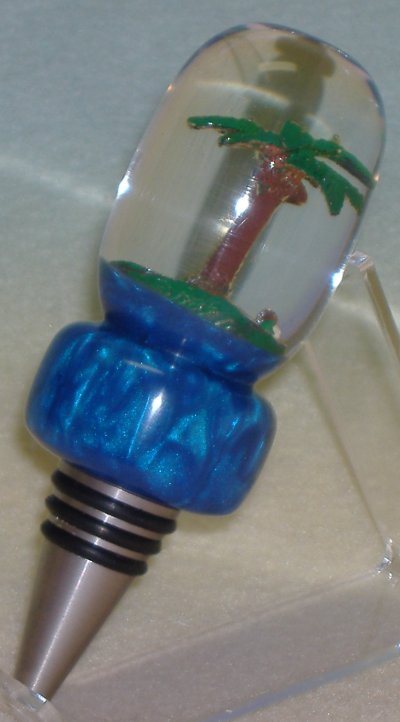

Here's my second one, with a nod to Yoyospin. :D Need to work on those air bubbles a bit. Not sure what the dark thing is behind the palm tree, must me some strange reflection from the clear part of the resin. And yes, there are sanding marks on it, couldn't get rid of them no matter what I tried. First tried the buffer (Tripoli and White Diamond), still had some in the direction that I buffed, so I put it back on the lathe and did wet micromesh with the lathe OFF. Finally tried some Hut plastic polish, then I gave up at that point. Any suggestions?
Thanks for looking and any/all comments and suggestions.

I use a very fine scotch brite , the white one when i use my plastic polish. buff it with that, let it sit then dry cloth buff it off. Works for me, but it could just be the fact that its clear, but it looks awesome!! Would make for a cool pen, somehow.
